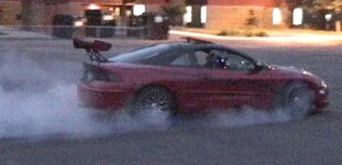

1997 Eagle Talon N/T Vehicle Profile & Build Thread
SnoopySLR's Talon N/T (w/turbo)
