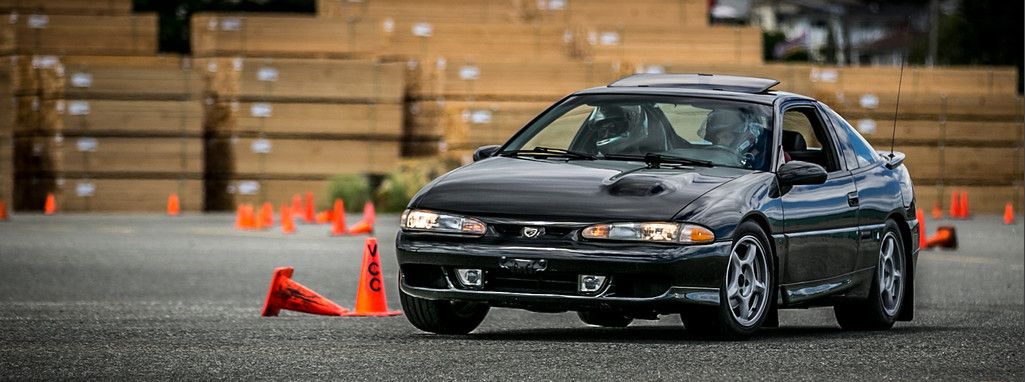

- Ownership Status
- Currently Own
- Year
- 1992
- Model/Trim
- Eagle Talon TSi AWD
- Turbo Type
- 14b
- Transmission Type
- Manual
- Build Type
- Autocross
- Mods-Bolt-on
- 3G MAS, 650cc FIC Injectors, Aeromotive AFPR, rewired Wally 255hp, Turbosmart eBoost 2, AEM UEGO Wideband, e3 o2, 3" turbo back exhaust... Probably more as well.
- Mods-Engine
- Stock and original.
- Mods-EMS & Logging
- JeffO chip, palm based logger.
- Mods-Drivetrain
- Updated to 4 bolt LSD.
Spec 2+ clutch and Fidanza flywheel
Solid shifter base bushings and cable end bushings
- Mods-Handling
- Ground Control / Koni coilovers, Ground Control camber plates
polyurethane bushings
1GB 'big' brakes with Hawk HP+ pads and braided lines.
16x8 FD RX-7 wheels (12.5 lbs), currently with Hankook RS-3 tires.
- Parts Wishlist
- moar.
- Background
- Second owner car that I've been on the verge of selling for years but never do.
Currently within SCCA ESP classing.
