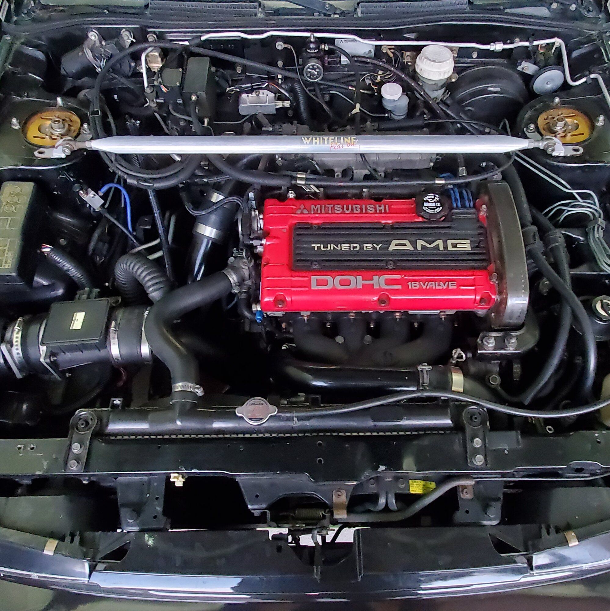

Mods-Bolt-on
Evo III Big 16g MHI TD05H (Forced Performance)
Evo III Ported & HeatCoat Treated Manifold (Forced Performance)
Evo III o2 Housing
ETS Galant VR4 FMIC Kit
K&N Filter & Custom Intake
APEXi 2.5" Exhaust
2.5" Downpipe
STM Atmospheric o2 Housing Dump Pipe (modified to fit VR-4)
PTP T3 Turbo Blanket (Black)
TPP FP Manifold Blanket (Black)
DEI 2" Pipe Wrap for Downpipe to Race Catalytic (Black)
Braided SS Turbo Oil Feed Line (Forced Performance)
RECARO Evo 9 Front (SSL) & Rear Leather Seats
'89 Underdash Kit
Mofugas 2 Gauge "A" Pillar Pod
Mofugas 3 Gauge Radio Panel
Autometer ProComp Ultra Light Gauges (Boost, AFR, EGT, Oil & Water)
Custom Audio System (Interior Speakers, Wiring, Single Din Radio & Amp + Sub
Working Cruise Control
Working A/C
Mods-Engine
Fluidampr
HKS 272 Cams
TODA Cam Gears
Zaklee Clear Cam Gear Cover
FIC 880cc Fuel Injectors
255lph Supra Fuel Pump
Hallman style manual boost controller
Mishimoto Carbon Fiber Catch Can Breather
GPI Silicone Cooling System Hose Kit
Vibrant Hoses & A/N fittings
STM Valve Cover A/N Fittings x2
Aeromotive Y-Block (dual -6 to single -8 to catch can breather)
Upgraded Valve Cover Half-moon
NGK BR7ES Spark Plugs
Mods-EMS & Logging
2g MAF Mass Air Sensor
Keydiver Chip
A'PEXi SAFC II
Mods-Drivetrain
JDM GVR4 RS/Evo I-III Close Ratio Transmission w/ USDM Final Drive (Built by Tim Zimmer of TMZ Performance ~ Stage 2+)
Southbend TMZ Performance SS-X Series 2700# Pressure Plate w/ Full Face Segmented Friction Ceramic Clutch Disk
Competition Clutch Street Chromoly Lightened Steel Flywheel
Competition Clutch Forged Steel Clutch Fork w/OEM Throwout Bearing
Extended Slave Cylinder Rod
Redline Fluids for Trans, T-Case & Rear
3 Bolt LSD Rear (USDM)
4WS Delete
Shifter Assembly Solid Chassis Mount Kit
Torque Solution Shifter Base Solid Bushing Kit
Torque Solution Transmission Cable Linkage Solid Bushing Kit
Shifter Pivot Bushings (New OEM replacements)
Mods-Handling
20mm Front Sway Bar
26mm Rear Sway Bar
Whiteline Front Strut Tower Brace
Whiteline Rear Strut Tower Brace
JIC Magic FLT-A2 Coilovers
Custom Subframe Connectors
BBS LM F1 Championship Edition Wheels (w/ Red Center Caps)
Continental Extreme Contact Sport Tires 225/45 ZR17
McGard SplineDrive Lug Nuts & Locks

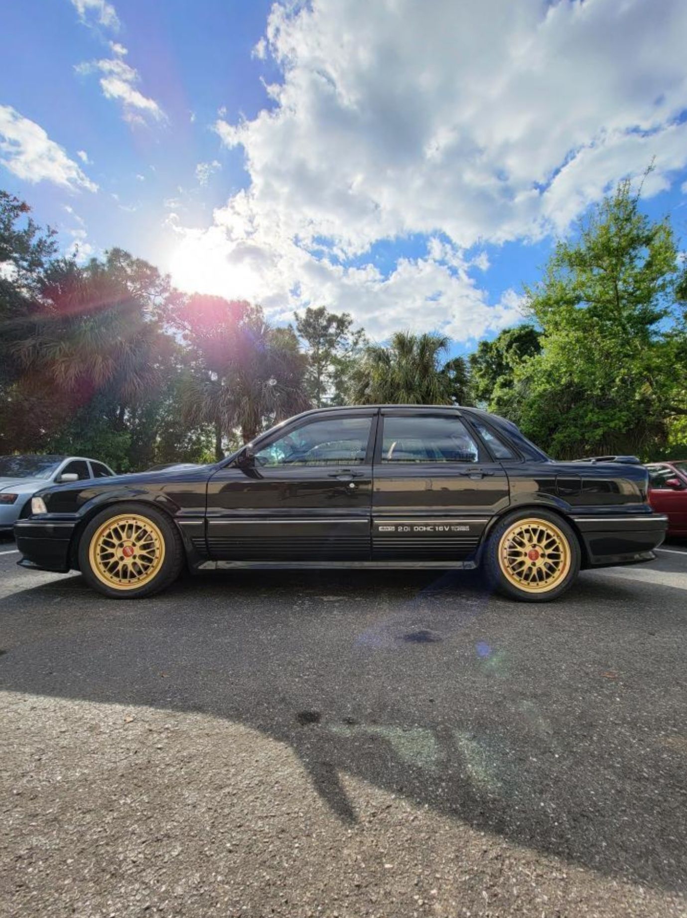

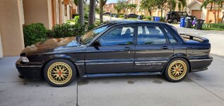

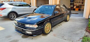

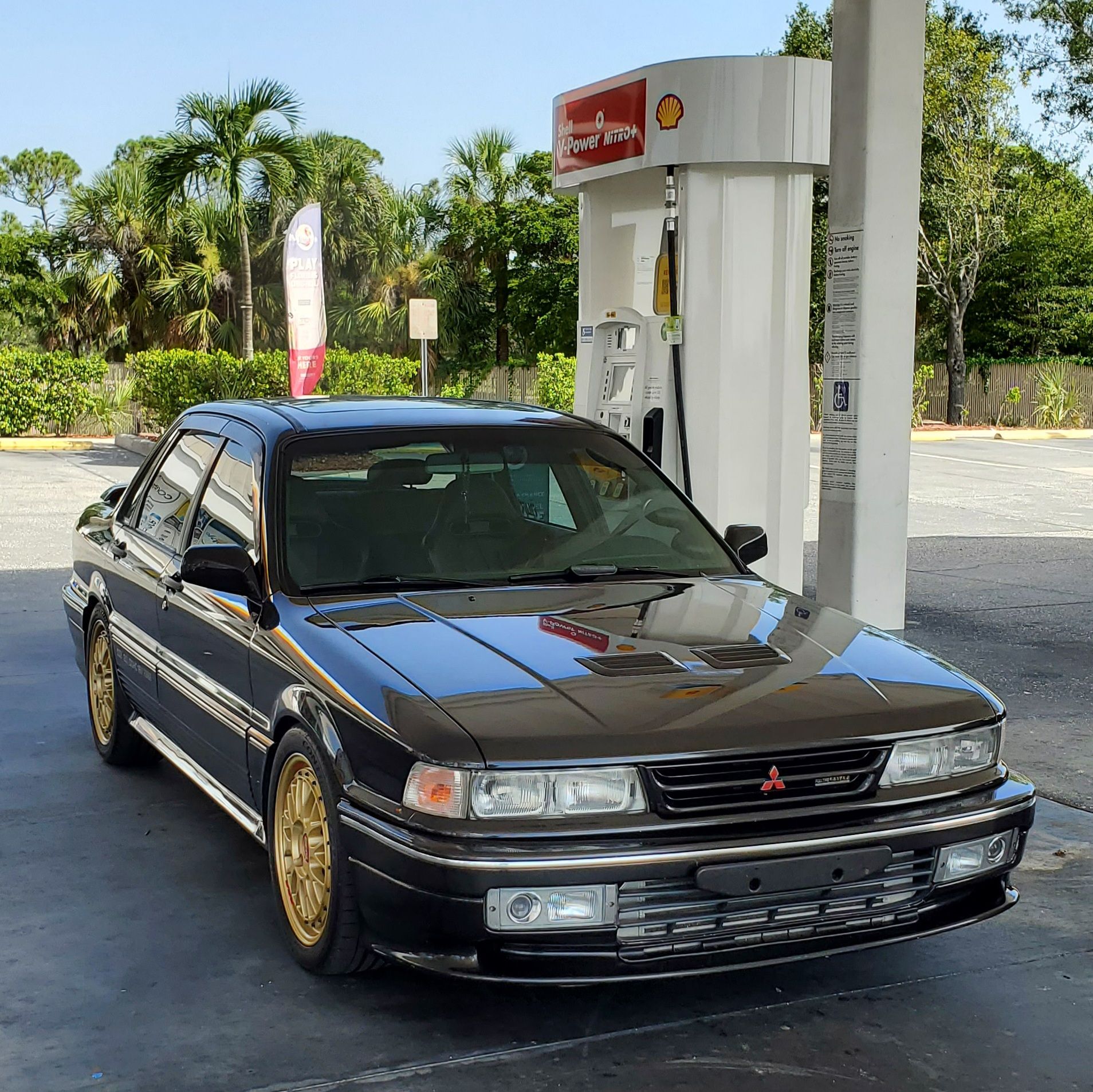

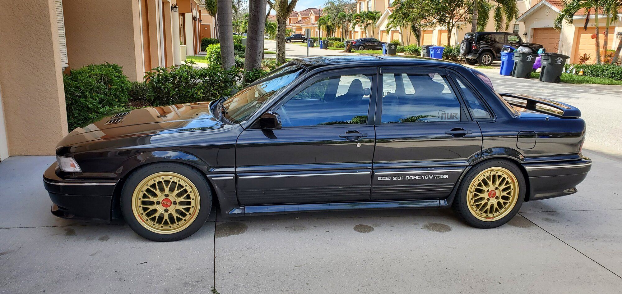

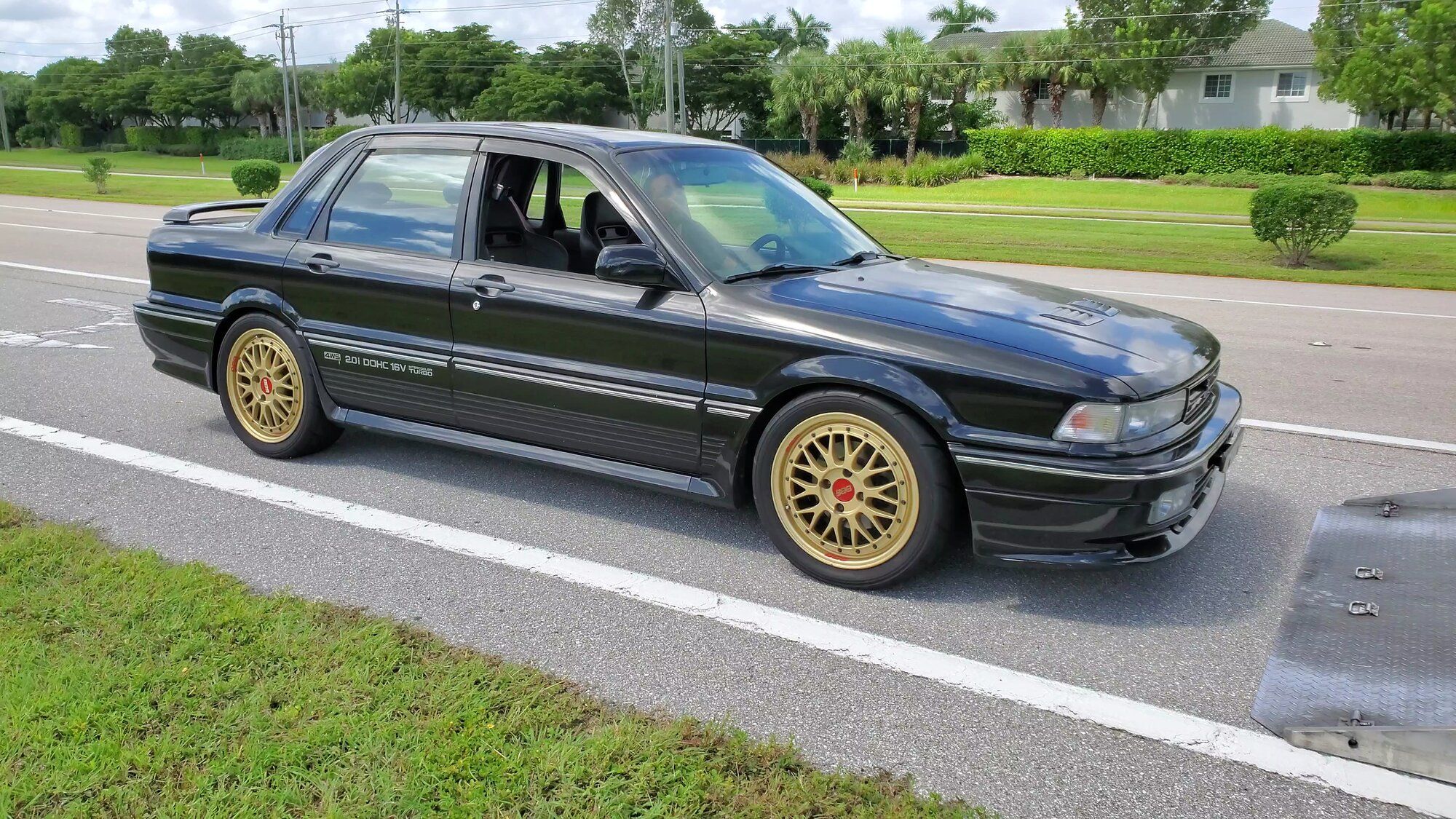

Clean, no rust, Cali survivor. Has some previous issues which are being fixed and/or upgraded, while trying to keep as period correct as possible. It's such a 90"s A/F timecapsule that I don't really want to change much about, other than addressing reliability and longevity so me and the Wifey can enjoy it for a long time. I thought it was time I should post mine up, though I do not know if it was done already by oldman_tau previously. The badge number is 1877 of 2000 but it is a '92 so I'm guessing oldman_tau or the port installed it to possibly match the vin as it does end in 187 (though we all know they are not categorized that way). I am looking to fix/replace it with a '92 badge (preferably #505 so as to avoid duplication as that was my previous '92 model # before it was scrapped) if anyone can help me find a replica replacement I'd appreciate it.
