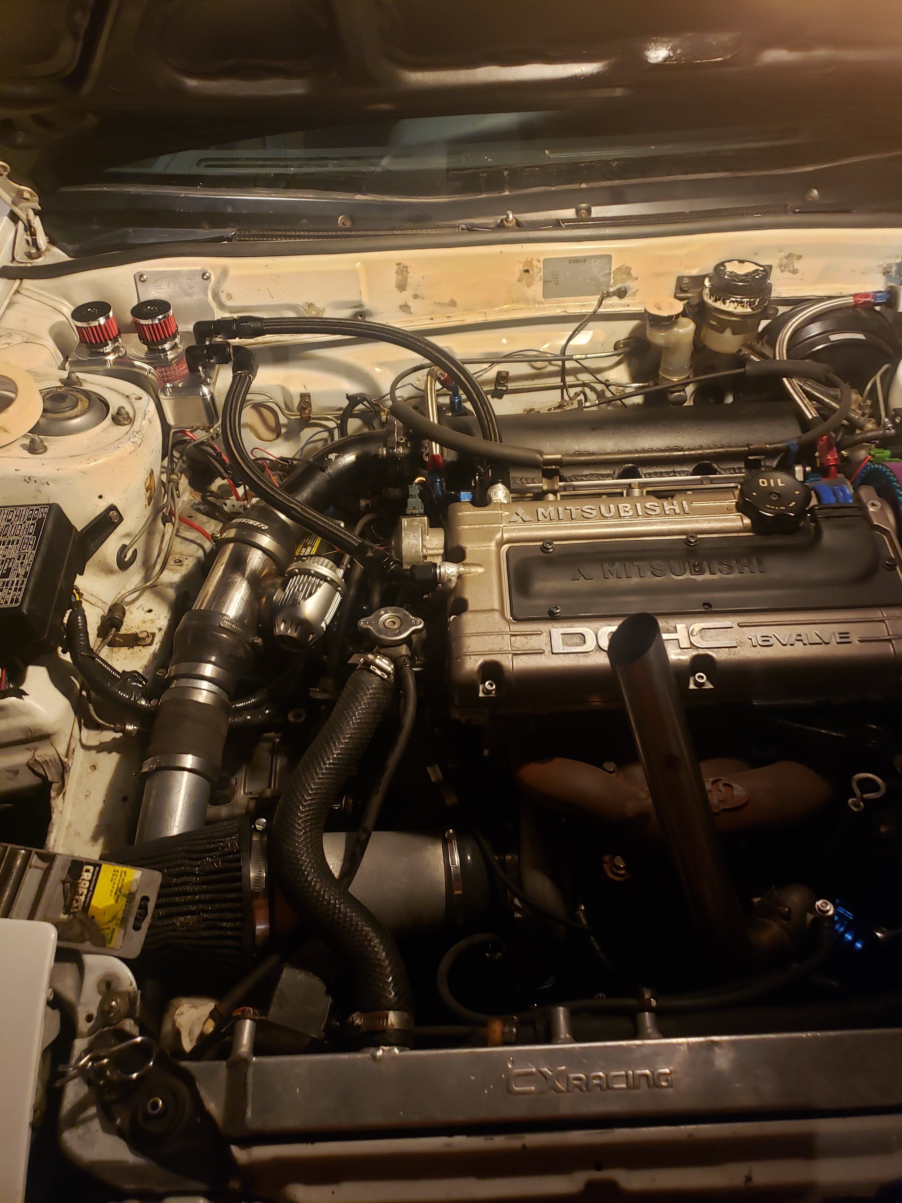

- Mods-Bolt-on
- Ported fp red turbo
ported fp race manifold
fp 4" aluminum intake, k&n filter
jm fab o2
jm fab oil catch can
tial 38 mvs
reef prototype smim
hks, timing belt
hks ssqv4 bov
hks headgasket
ets street front mount intercooler
fic 1800cc lowz
paxton fpr
ss clutch line

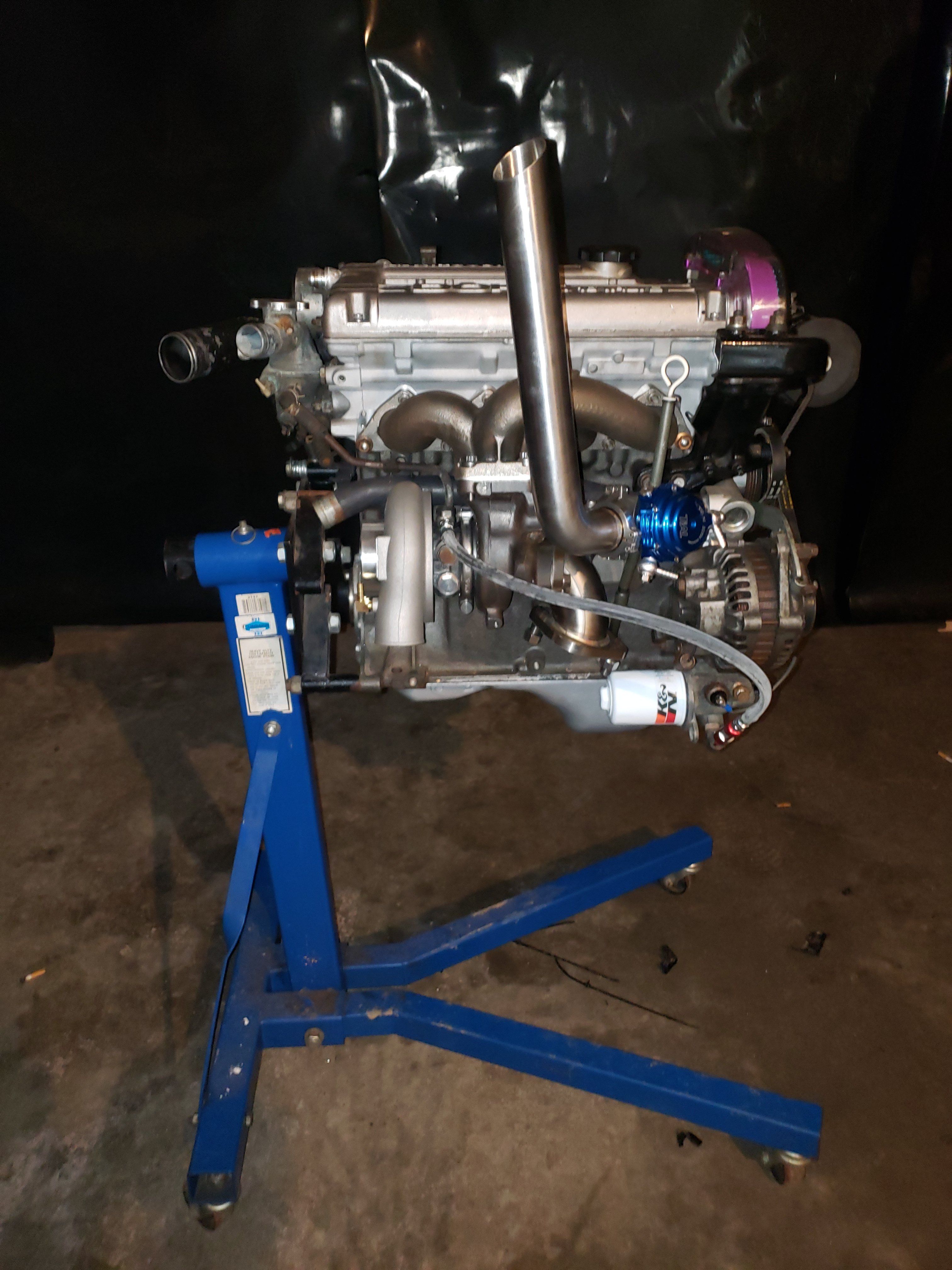

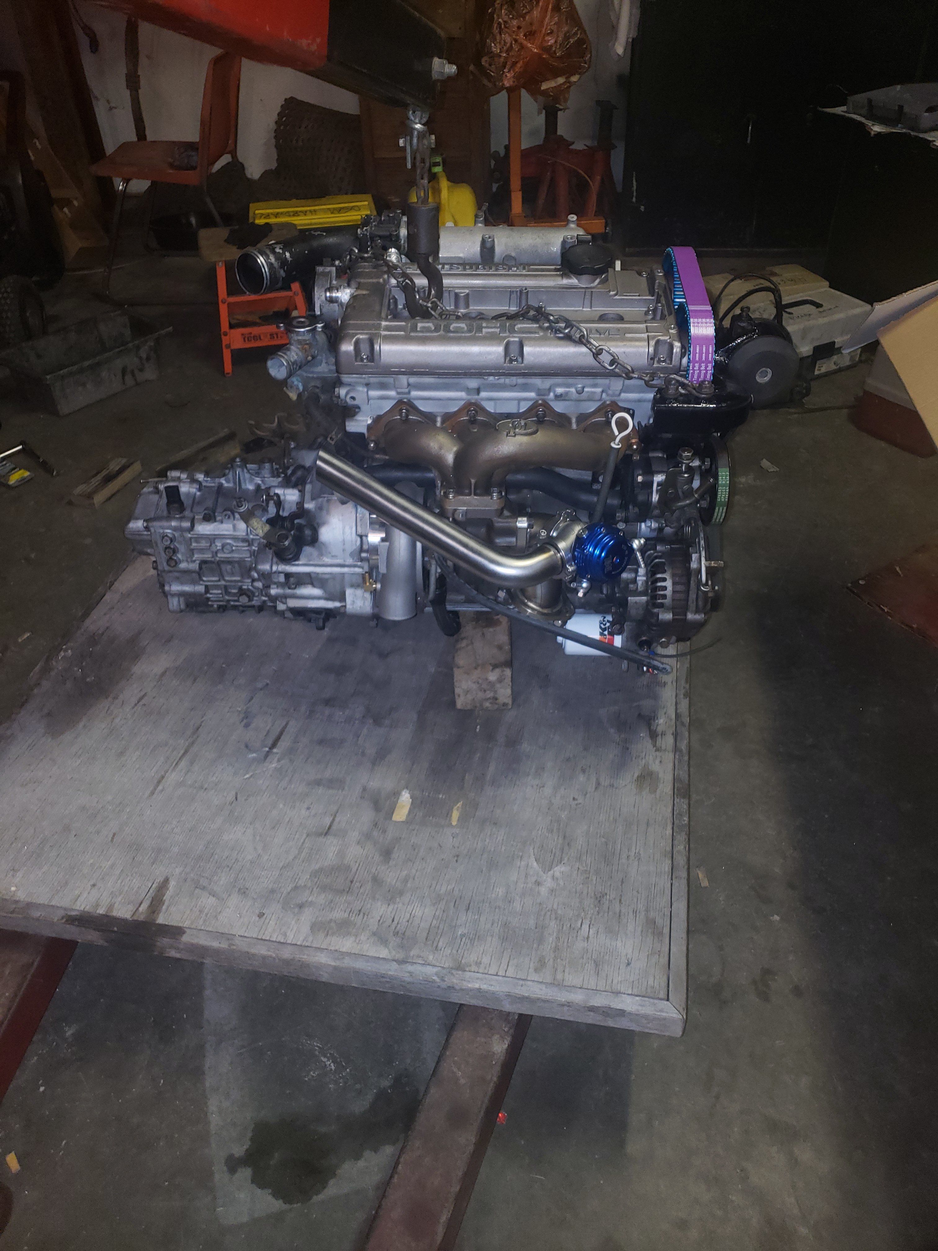

- Mods-Engine
- head:
mild port 6 bolt head
hks 264/272 cams
hks adjustable cam gears, arp bolts
ferrea beehive springs
ferrerea bronze guides.
stock valves
block:
2.0 bored. 20 over
arp l19 head studs
eagle h beam rods
wiseco pistons 85.5mm 8:3:1
acl bearings main and rod
arp hardware.
All freshly machined

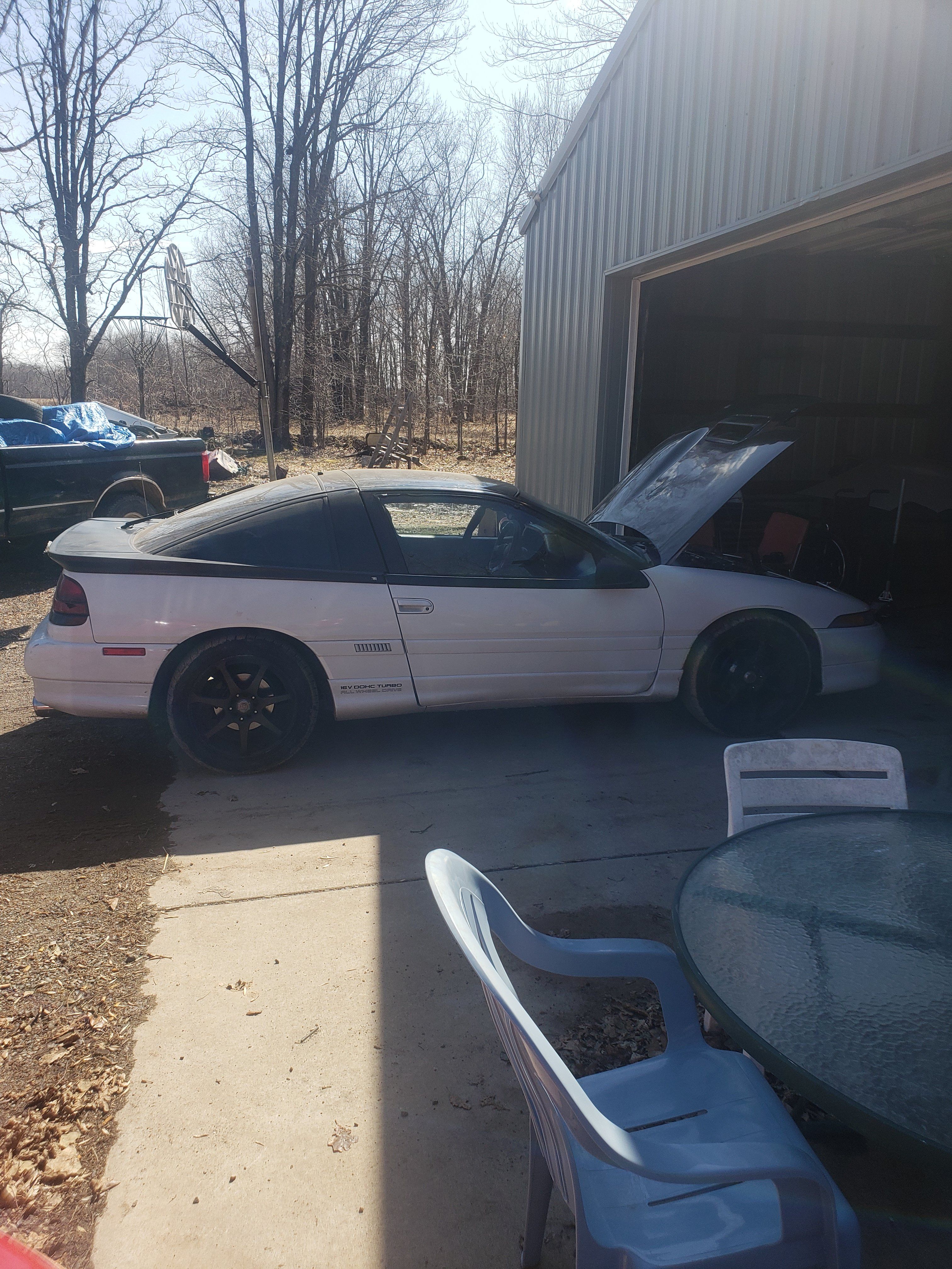

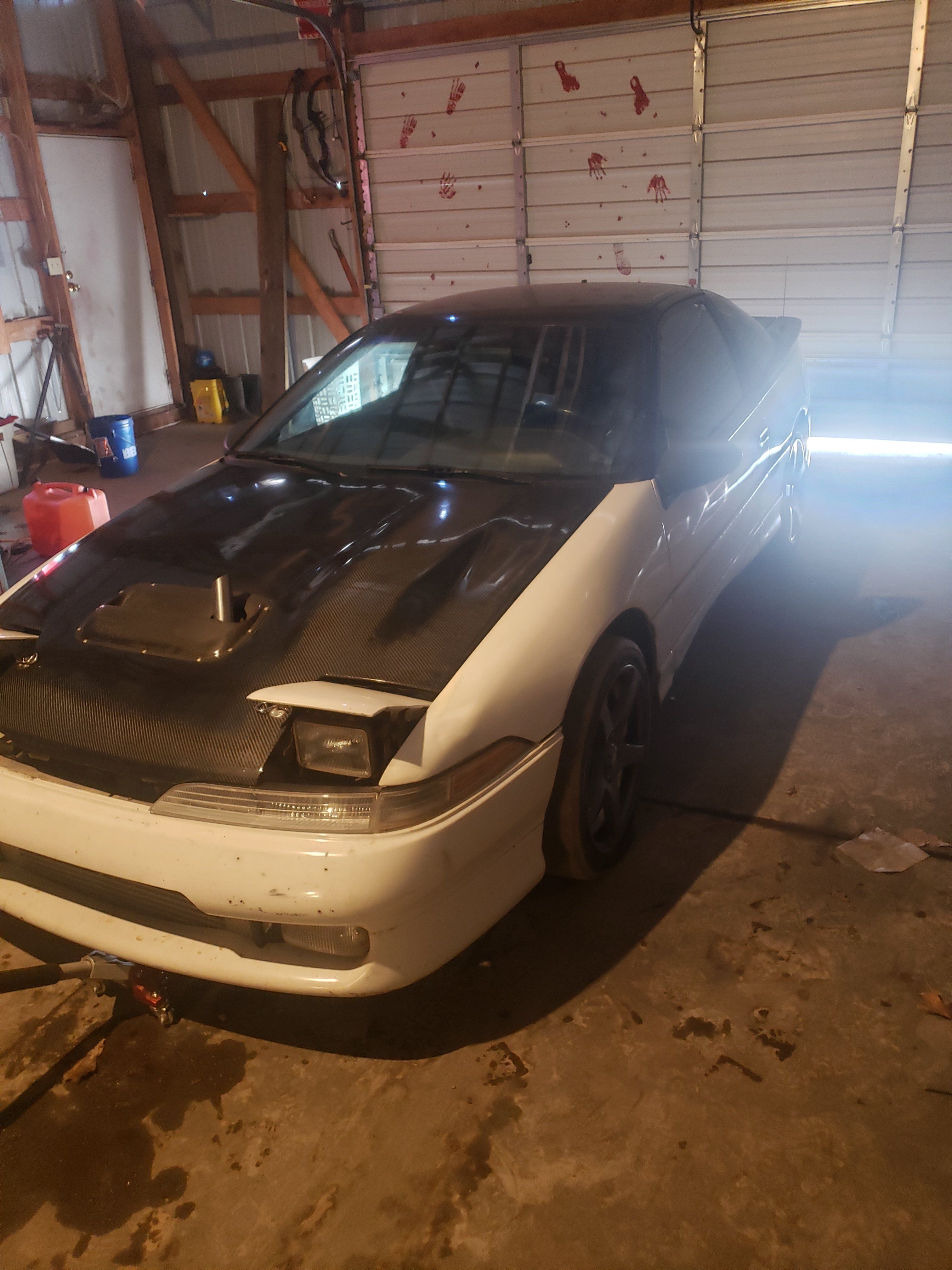

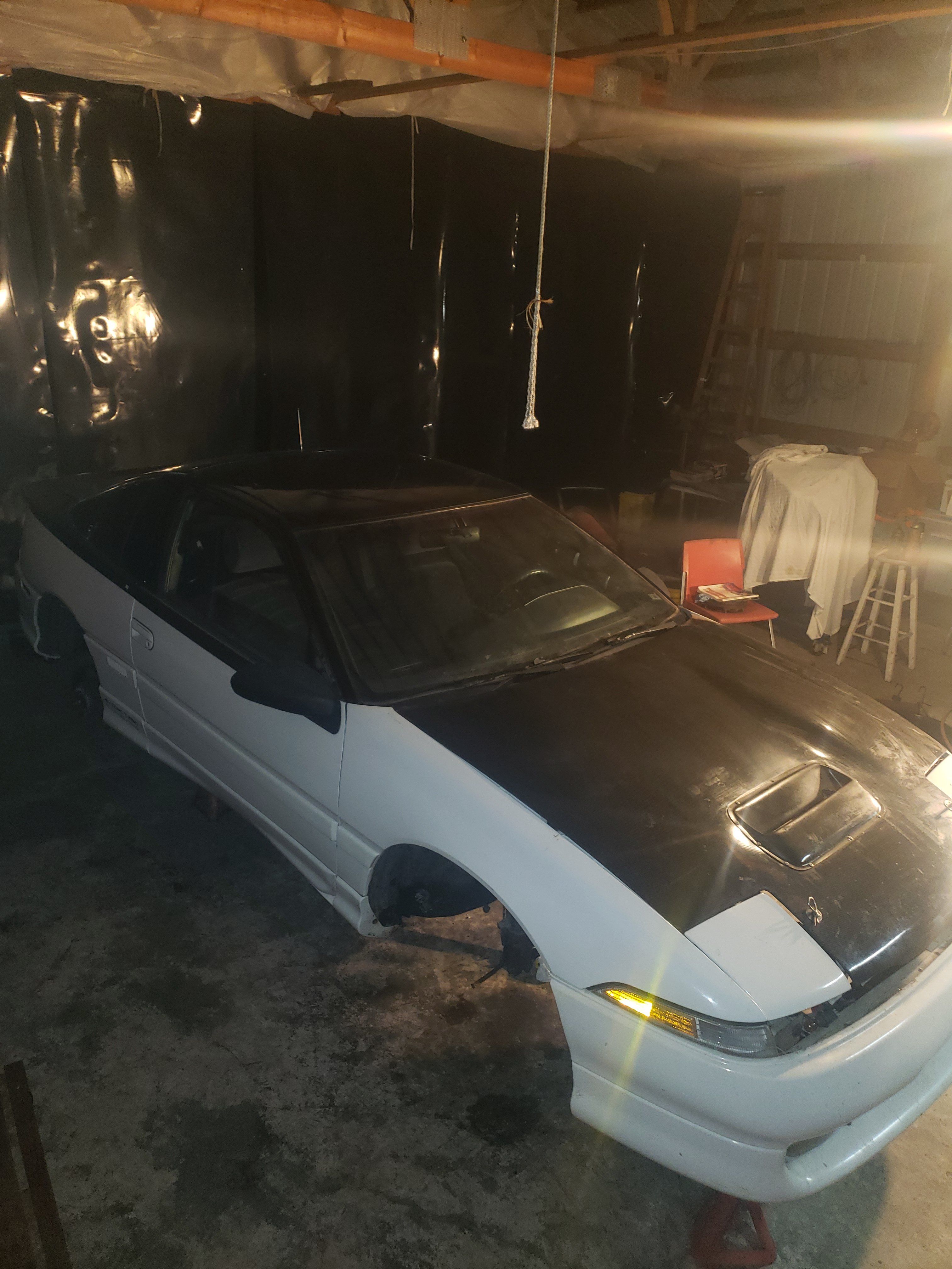

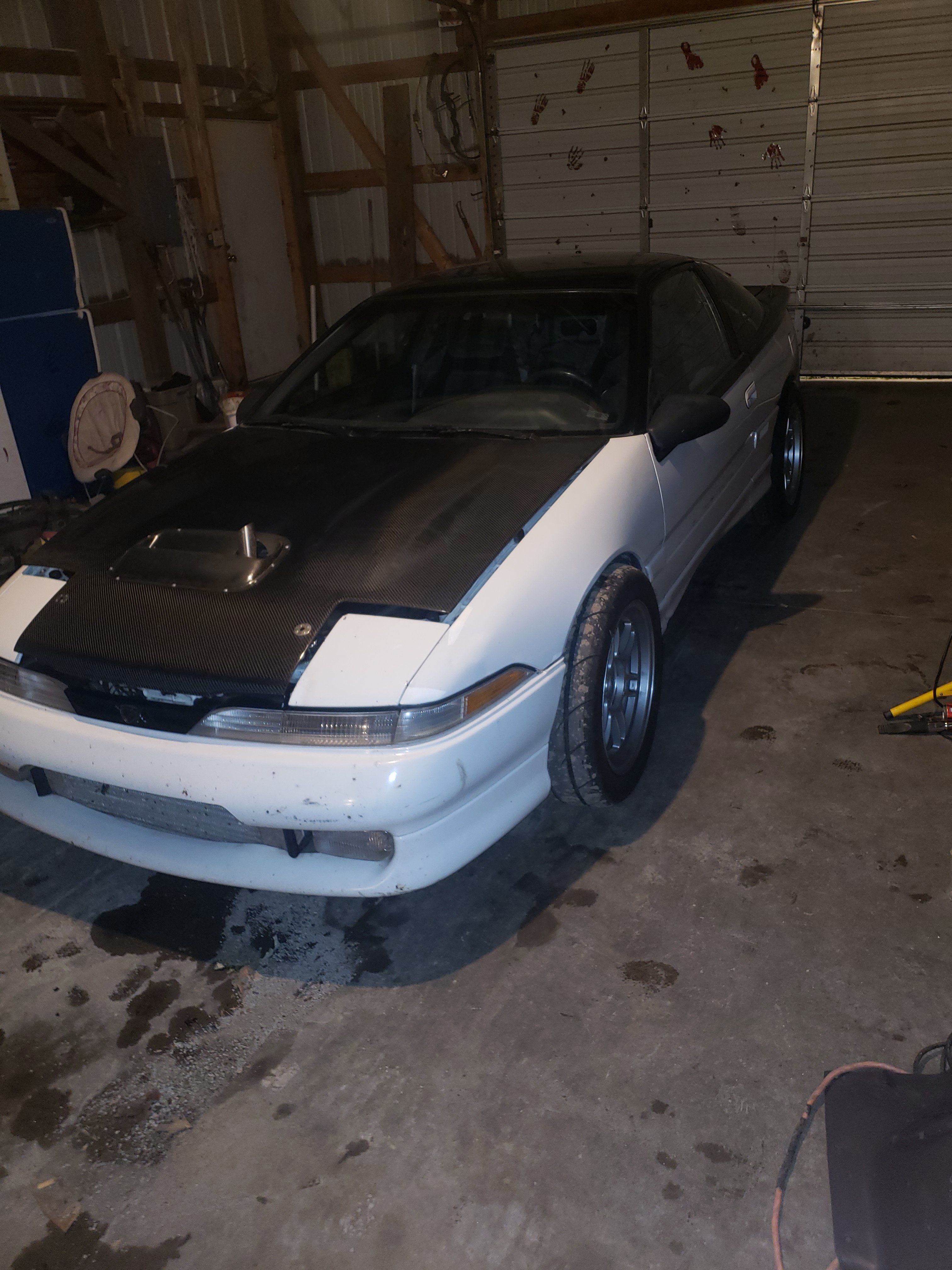

- Background
- Bought the chassis as a roller. It's taking a little over 2 years to complete.
Plans: I'm trying for 10's 500-600 hp is what im going for.
