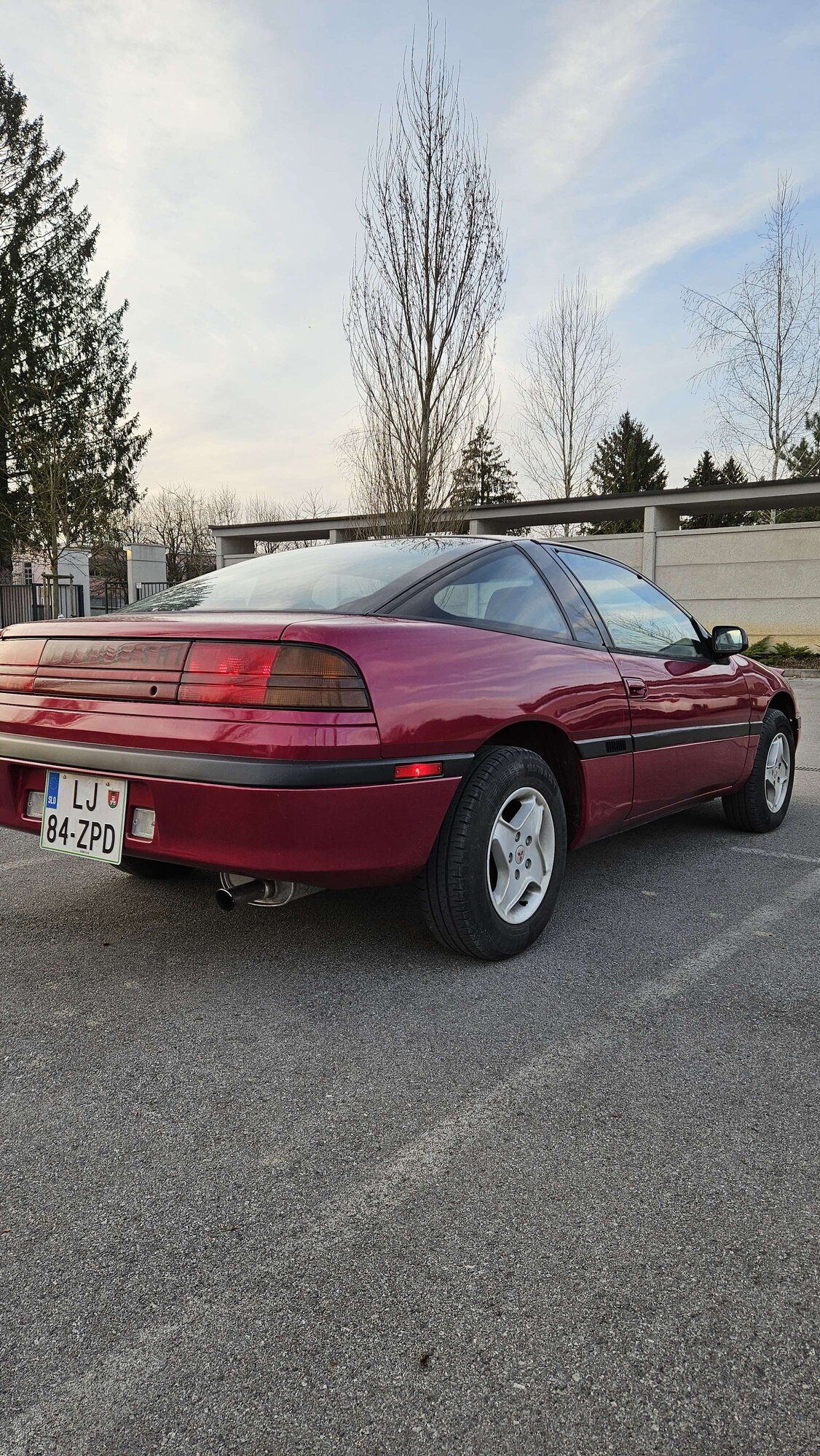

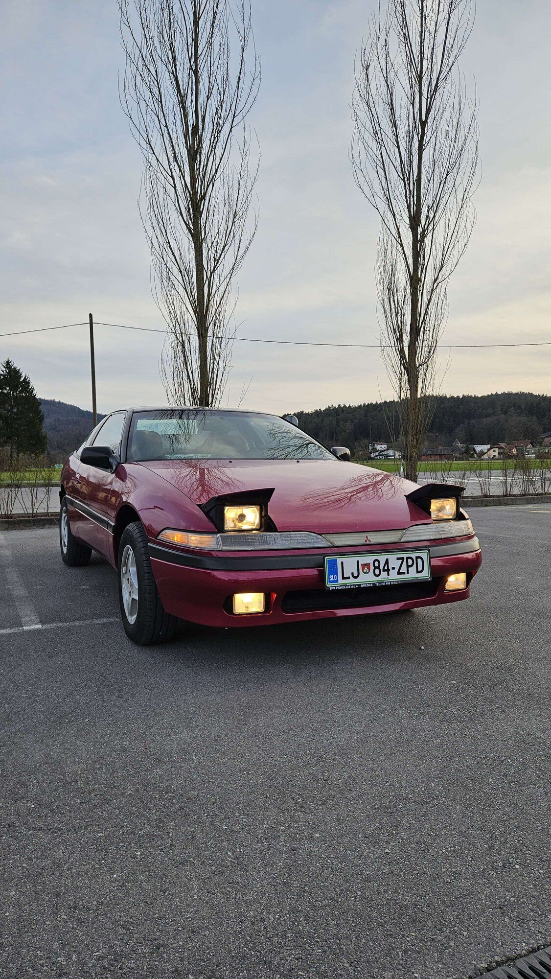

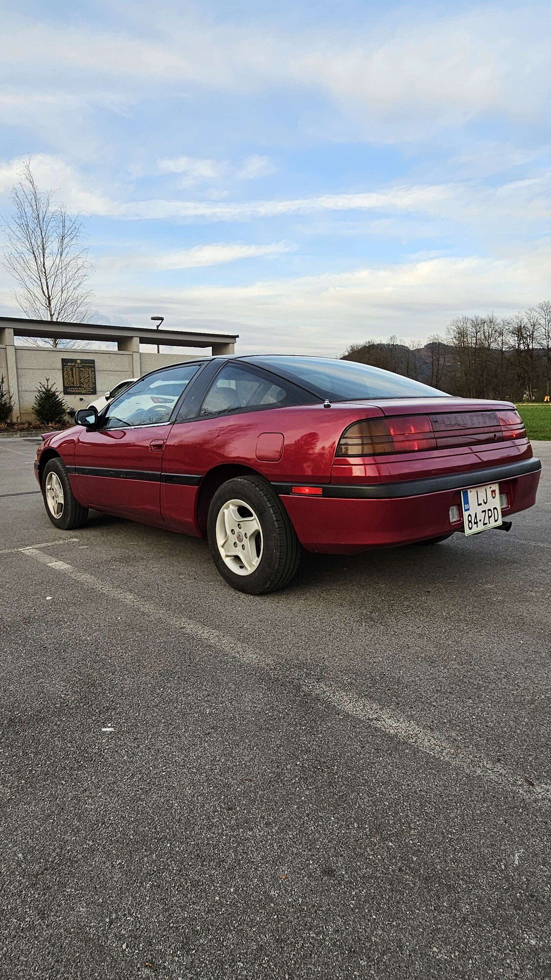

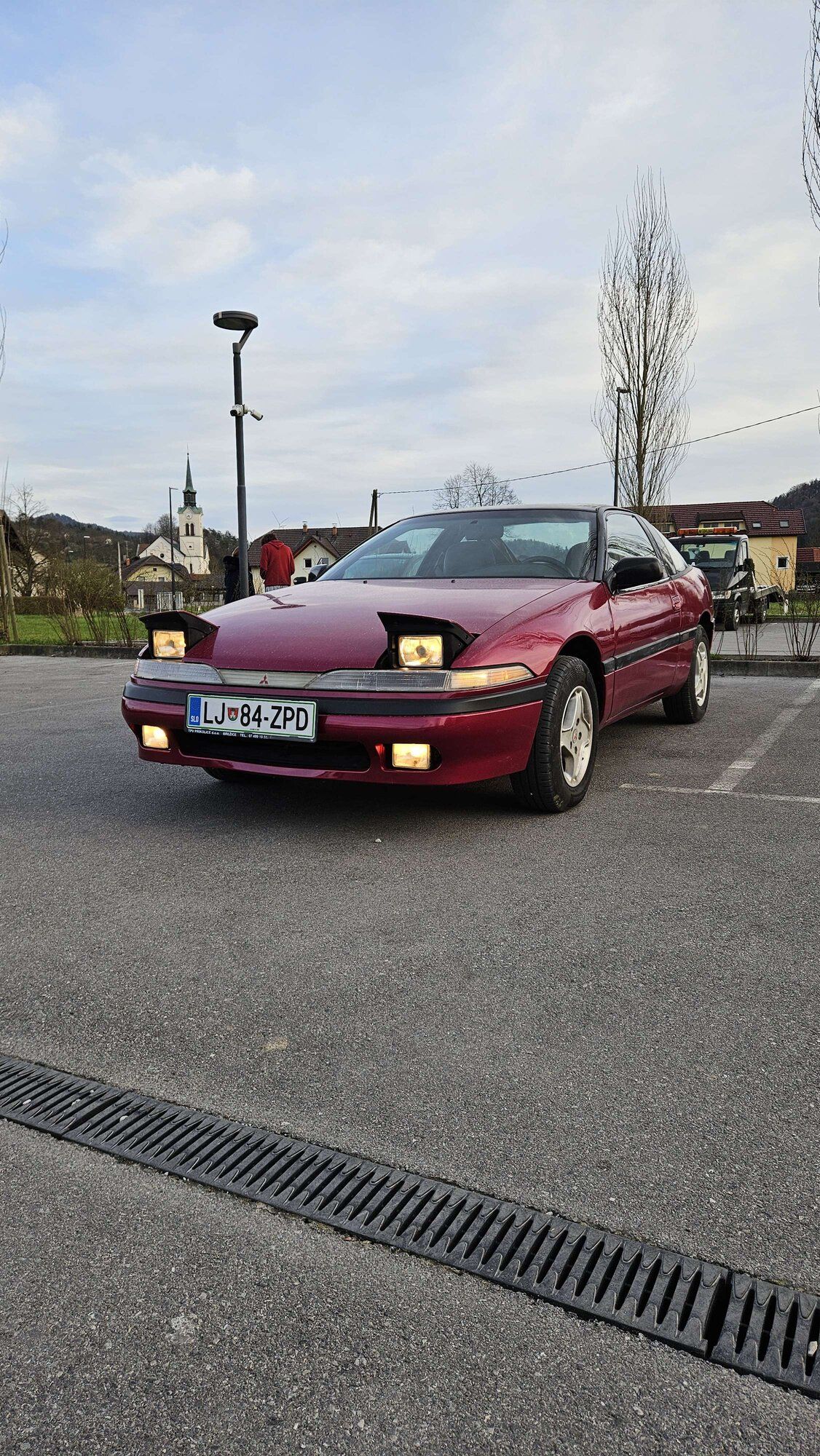

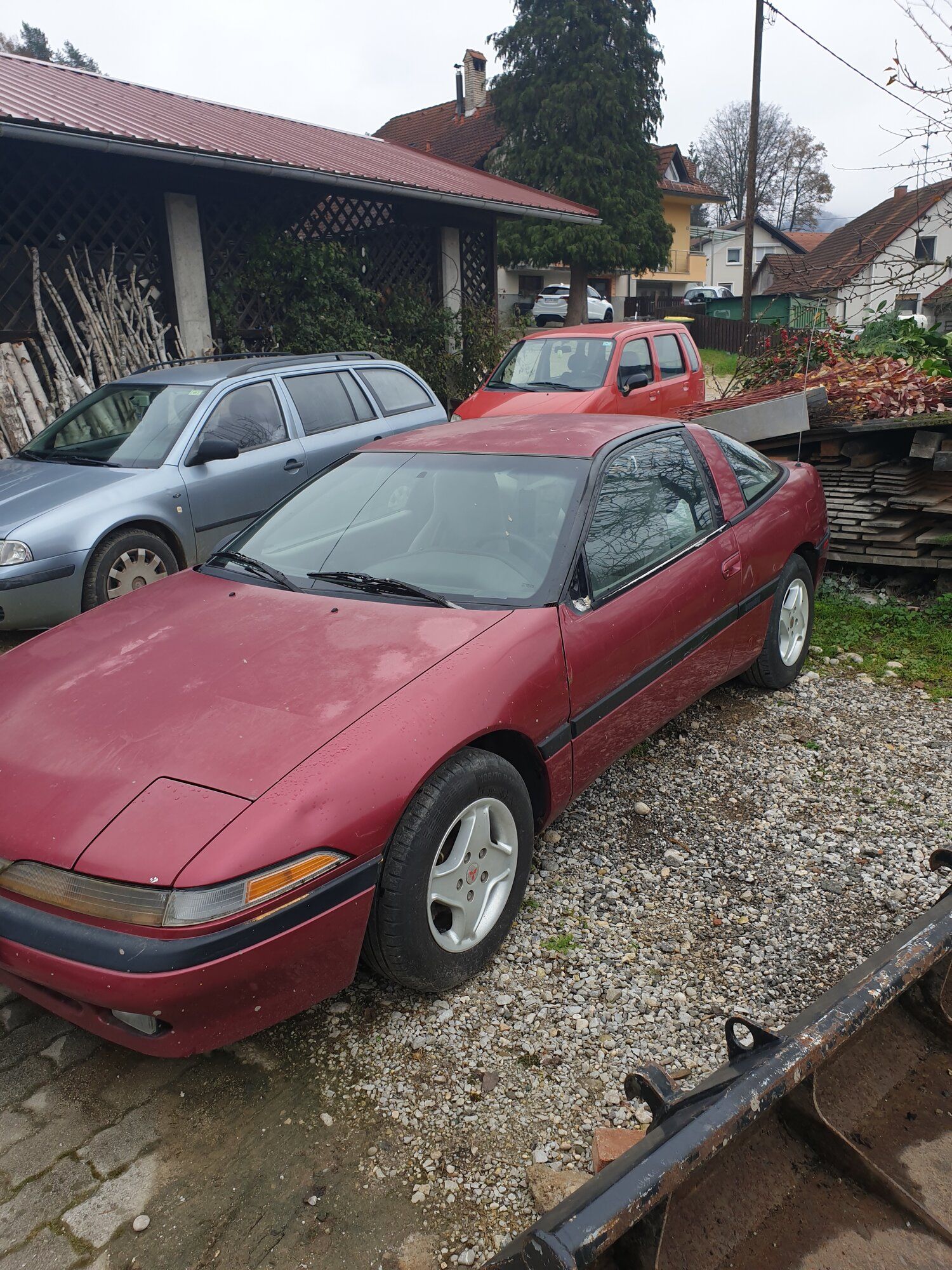

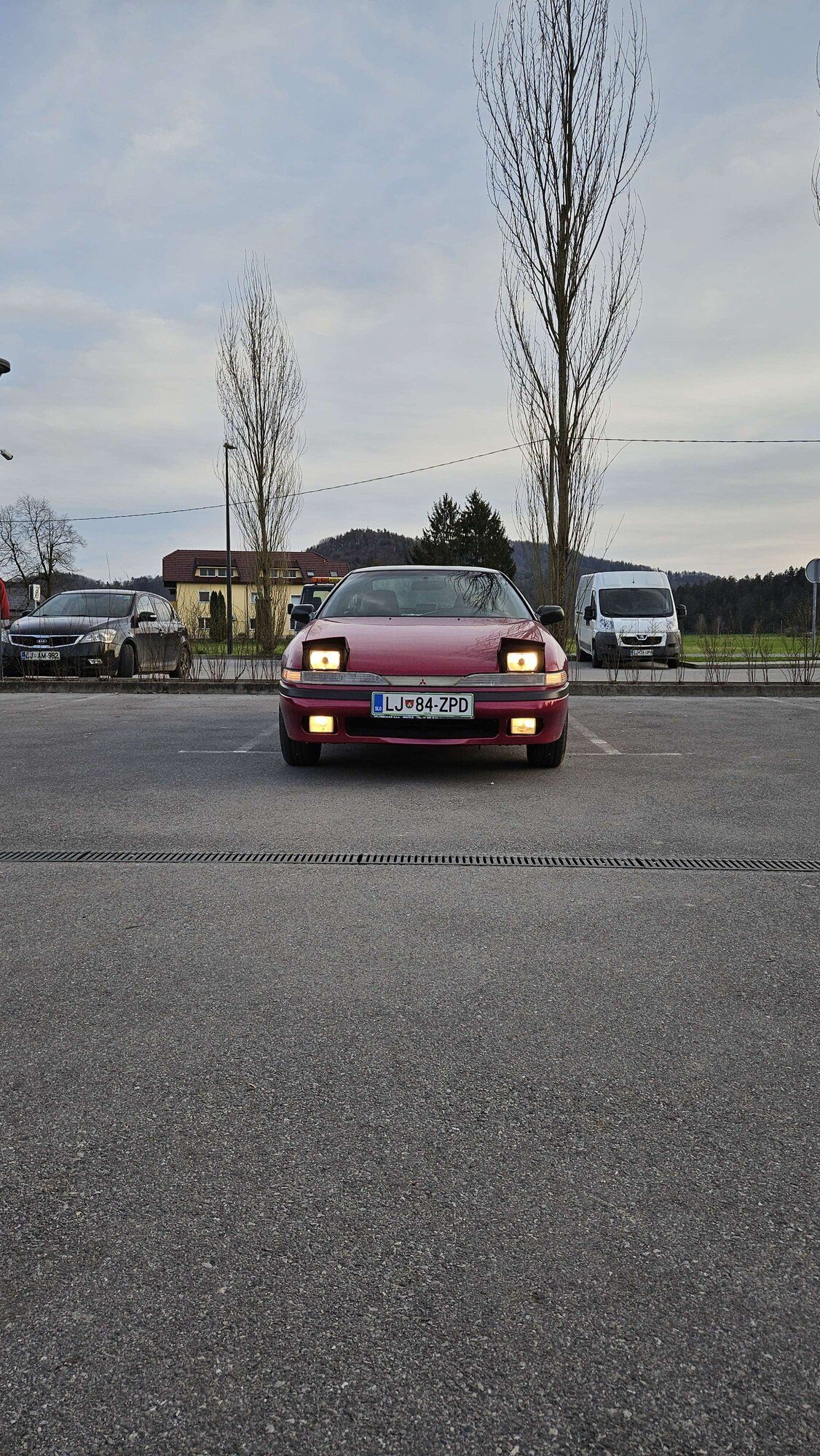

Street Build Mitsubishi Eclipse 1.8 1g 4G37 5 M/T
- New EURO lights with blinkers
- Cleaned out and fixed my front blinkers and mitsubishi sign
- Remounted the driver side mirror
- New fuel filter and pump
- New battery
- New MAF
- Cleaned out the old fuel from the tank and the fuel system
- Checked and cleaned the FPR
- New liquids (Oil, coolant)
- New oil filter
- New belt and timing done on point
- New O2 sensor
- New cam shaft sensor
- New thermostat
- New coolant temp sensors (both for the dash and ECU)
- New oil pressure sensor
- New cables
- New rotor
- Fixed ECU
- EGR block off
- Cleaned out the coolant system (cause of overheating in the summer time)
- New Brembo brake pads for front and rear discs.
- Complete overhaul of the brake caliper o-rings (front and back).
- New side mirrors for the passenger and driver side
- New 17' wheels and tires
- New steering wheel
- New interior carpets

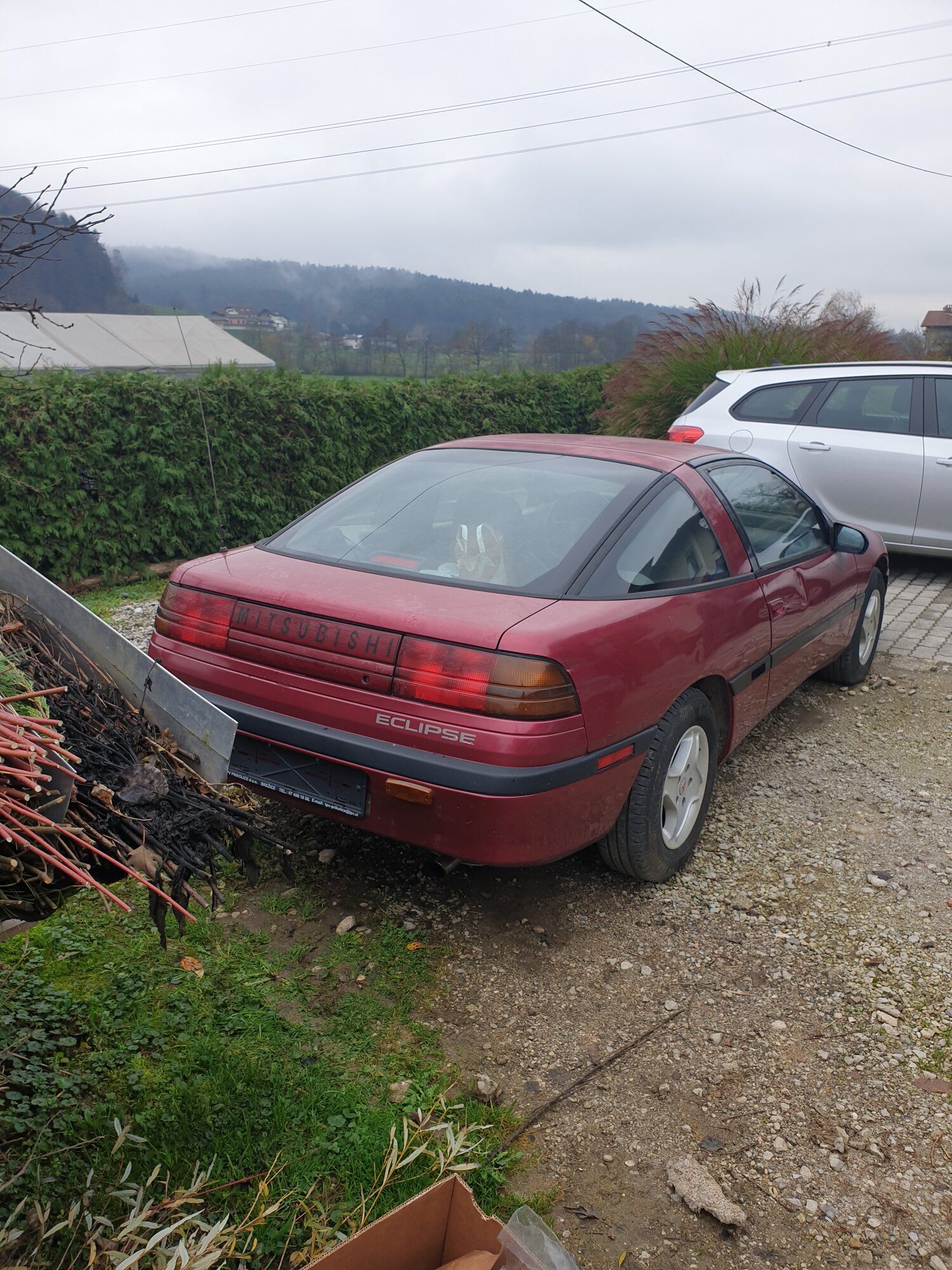

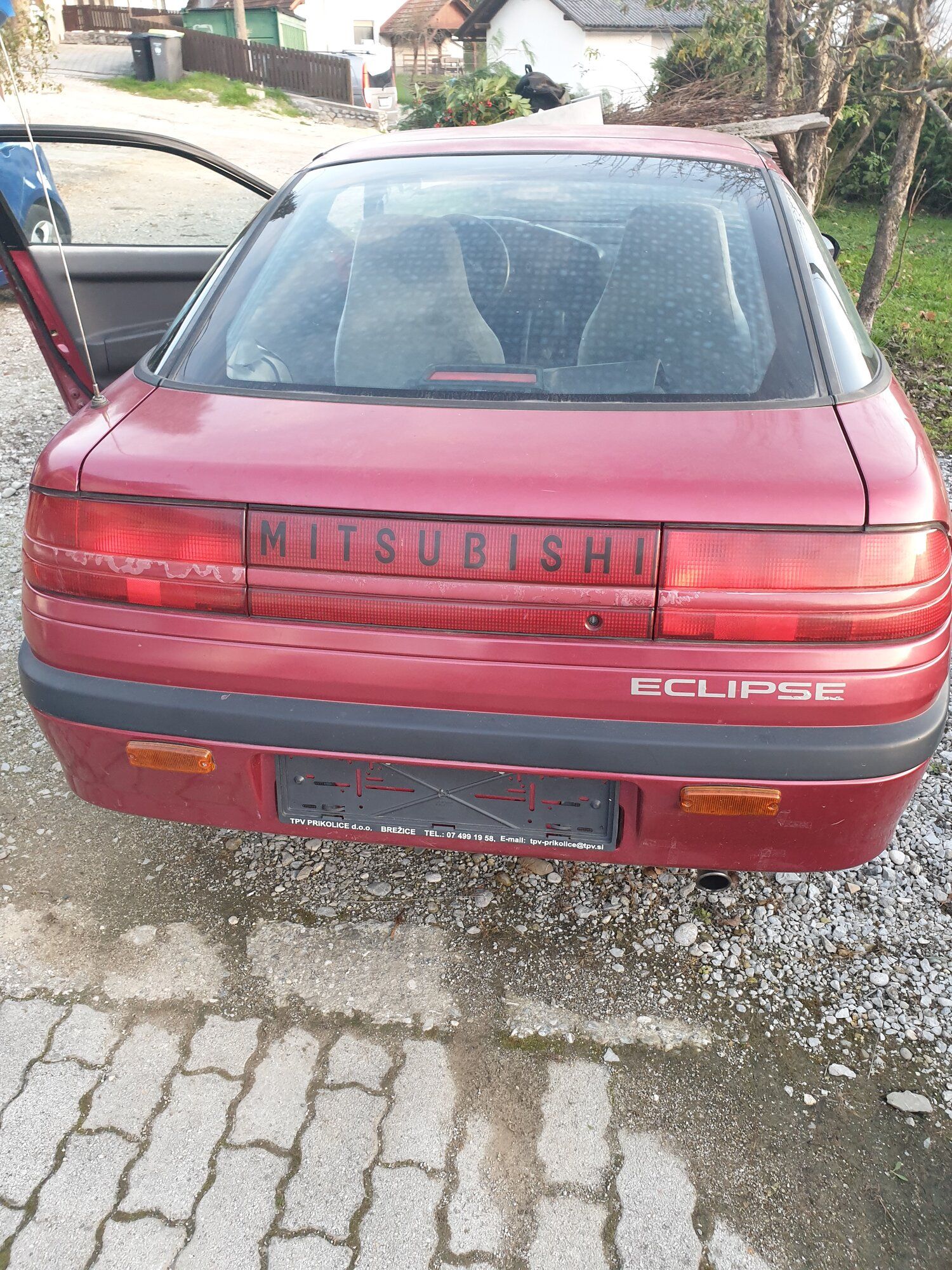

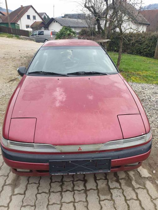

Trying to get the car back on the street after almost 22 years of it being abandoned by the previous owner :)
Edit: 13.01.2023 The car finally runs good, planing on taking up test plates for the week to see how she handles!
Edit: 17.03.2024 The car has finally been repainted and repolished it is 99% done :)
