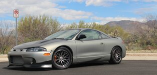

Borg Warner EFR Turbo w/ 4in. AGPTurbo compressor housing, South Florida Performance T3 Manifold, 35mm TiAL, 3in. AGPTurbo downpipe w/ HKS Hi Power exhaust, 4in. AGPTurbo Intake and Filter, 2.5” AGPTurbo short route intercooler piping, 3in. AGPTurbo bar and plate core intercooler, HKS SSQV, AeroMotive AFPR and 40 micron fuel filter, FIC 1200cc injectors, Walbro 450LPH Pump, Bosch 044 Inline Pump
Mods-Engine
1G 6 bolt bottom end built with 9:1 Wisco Pistons w/ Eagle Rods, 2G head with mild port and polish, Magnus V1 intake manifold, HKS 272 intake cam / 272 exhaust cam, Fidanza aluminum adjustable cam gears, Road Race Engineering valve cover plate
Mods-EMS & Logging
AEM V1 EMS speed density setup, AEM UEGO air/fuel gauge, AEM -30-50 PSI boost gauge
Mods-Drivetrain
TurboTrix transmission, Setrab transmission oil cooler, ACT 2600 clutch, Fidanza billet aluminum flywheel, Custom short throw shifter, Mitsubishi Evo shift knob, Stainless steel clutch line, Stainless shift plate bushings,
Stainless ball bearing shift cable bearings
Mods-Handling
13in. Baer Brakes w/ Stainless Lines on all 4, Enkei RPM2 Bortex 17x8 lightweight wheels, Ksport performance coilovers, RM Racing sway bars F/R, Sprint camber kits F/R
