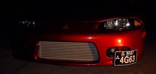

Injen flter & MAS adapter,Dejon 3" intk,BRODE uicp,Hahn licp,Hahn FMIC,coldair intk,h2o FMIC spryr,SnowPerf. H2O injection,
SFP mani,AGP 2.5" O2 hous,Buschr 2.5" down pipe,BRODE 2.5" testp.,Therml 3" catback,
Garrett 50 trim T3/T4,JoeP mbc @22 lbs,1G bov crushd,Turbnetics Evolution Xtrnl wstegate w/dump,
Fuelpmp rewire,Denso 660s,Walbro190,Magnecr 8.5mm wires,ngk BP7ES plugs,
ApexiTT,AutoMeter boost/vac & EGT,Apexi AFC 2,BCS led.,speed limiter removd,
B&M short shft,NrgySusp. shifter bushings,RRE clutch line,underhood shifter bushing,ACT 2100 & Streetlite flywheel,
NrgySusp. motor mount inserts,w8rdction,front bumper CUT,rolld RR fenders,VIS carbon HOOD,Sparco hoodpins,
BRIDE BRIX II & sliders,G-FORCE 6-pt harness,top R&R to BLK,4pt bodyBRACE,custom 1off coldair DUCTING
