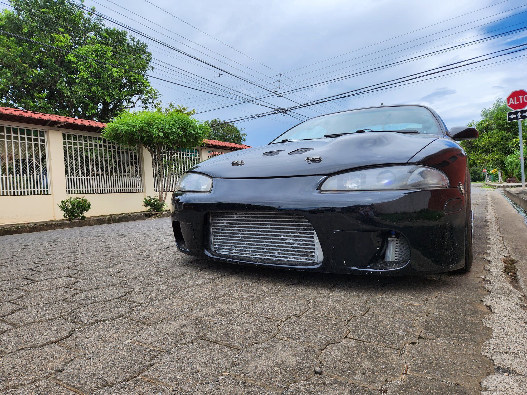

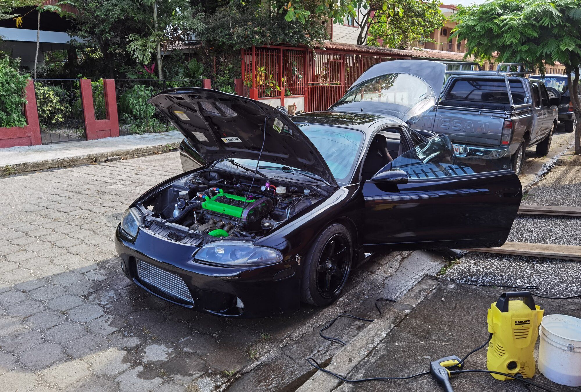

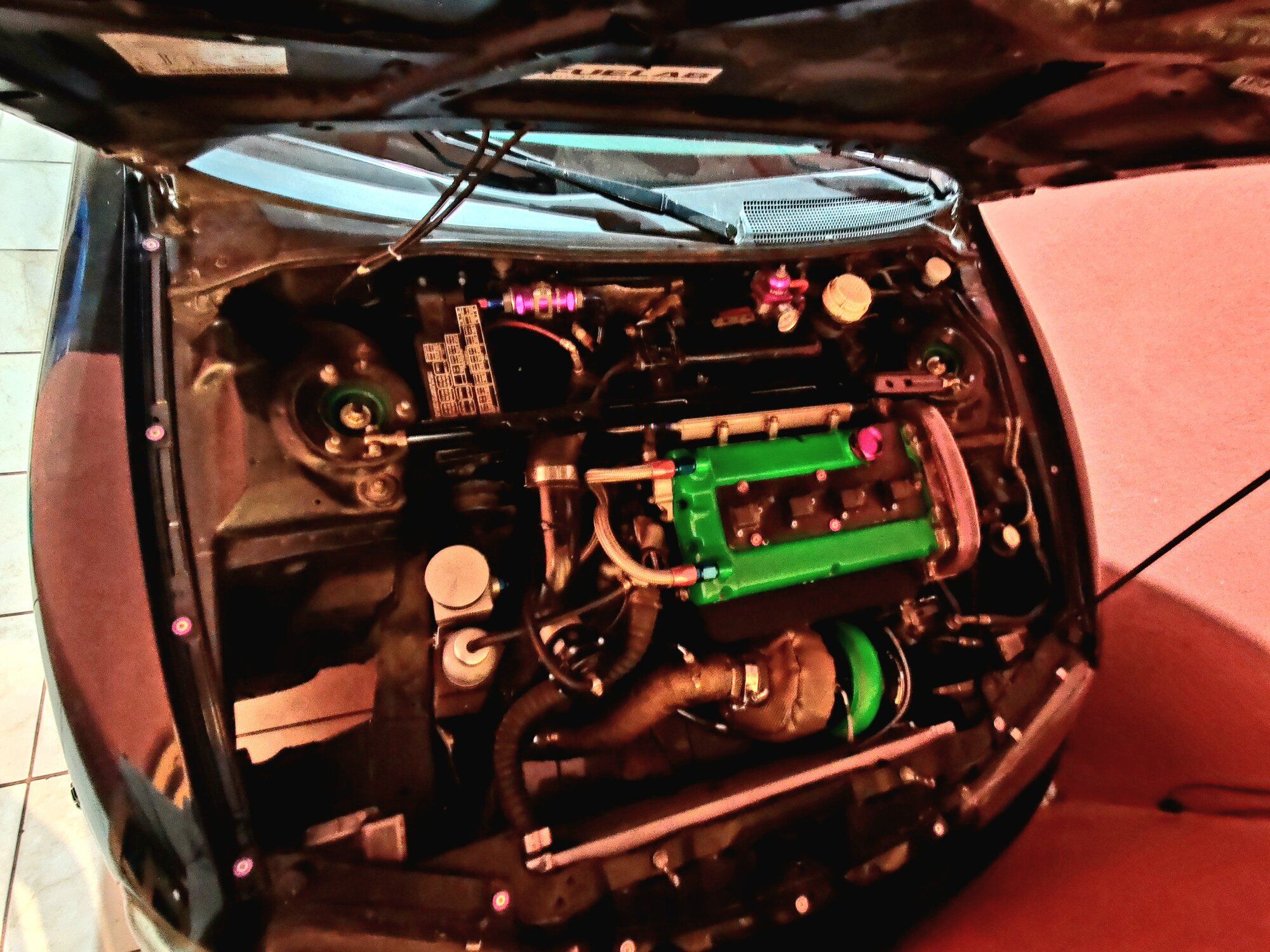

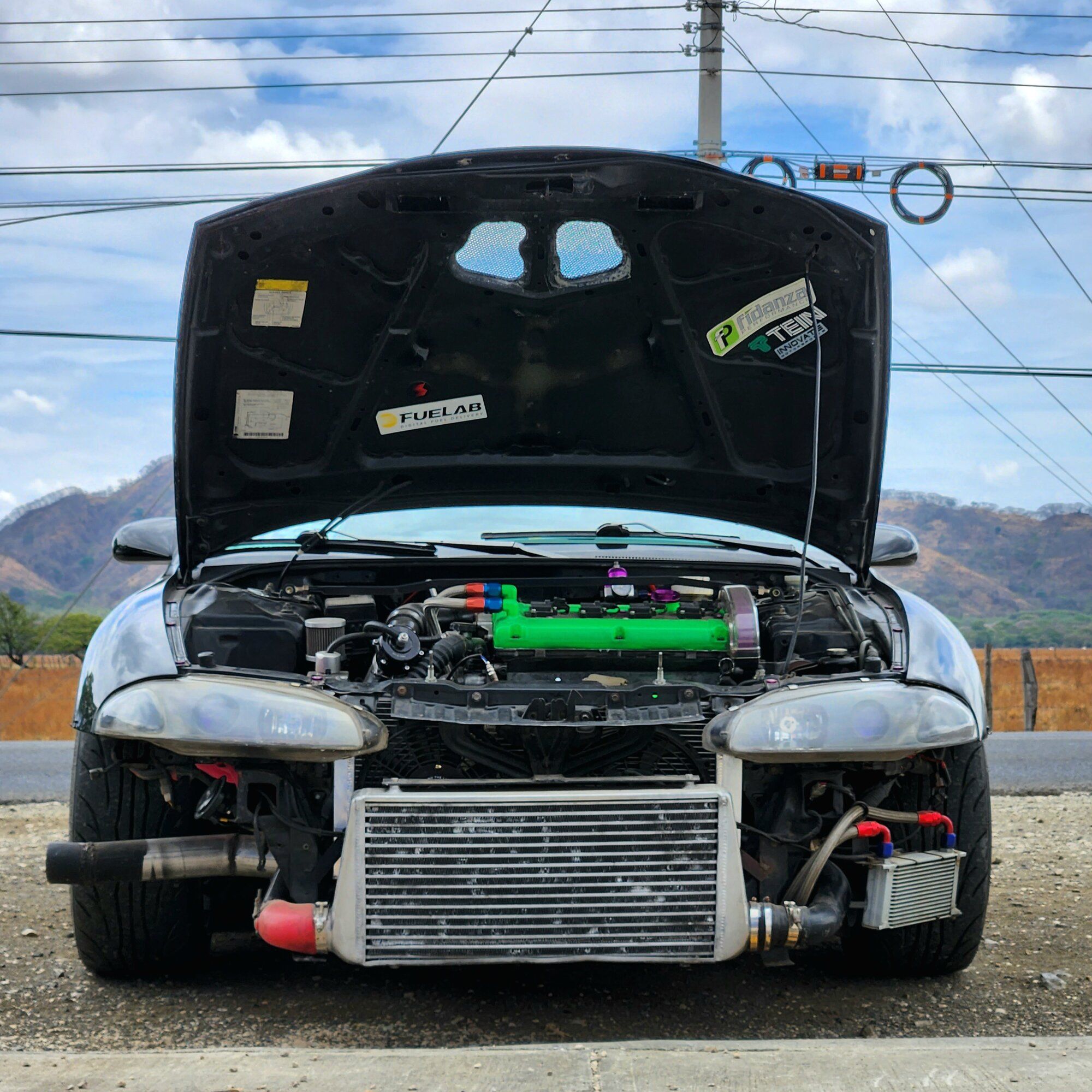

Intake: 9" K&N filter, 4" custom intake, FMIC w/ custom 2.5" piping and TB elbow, Tial Q Bov, 1g throttle body, evo 3 intake manifold with thermal gasket, snow performance water/meth kit.
Exhaust: custom t3 top mount manifold, twin scroll 12cm hx35, 38mm turboxs wastegate, 3" custom SS downpipe ceramic-coated, apexi N1 catback exhaust (catless).
Fuel: Custom high flow fuel rail, 515 Fuelab FPR, walbro 400lph, Fuelab tank to rail 6an kit w/ fuelab filter, RC750cc injectors.
Misc: EGR delete, taboos vacuum delete, battery relocated, tucked radiator, C.O.P w/ dynatek ARC-2, Cruise control delete, A.C. delete, alternator relocated full wire tuck, FIAV delete, catch can w/ 10an valve cover fittings.
Mods-Engine

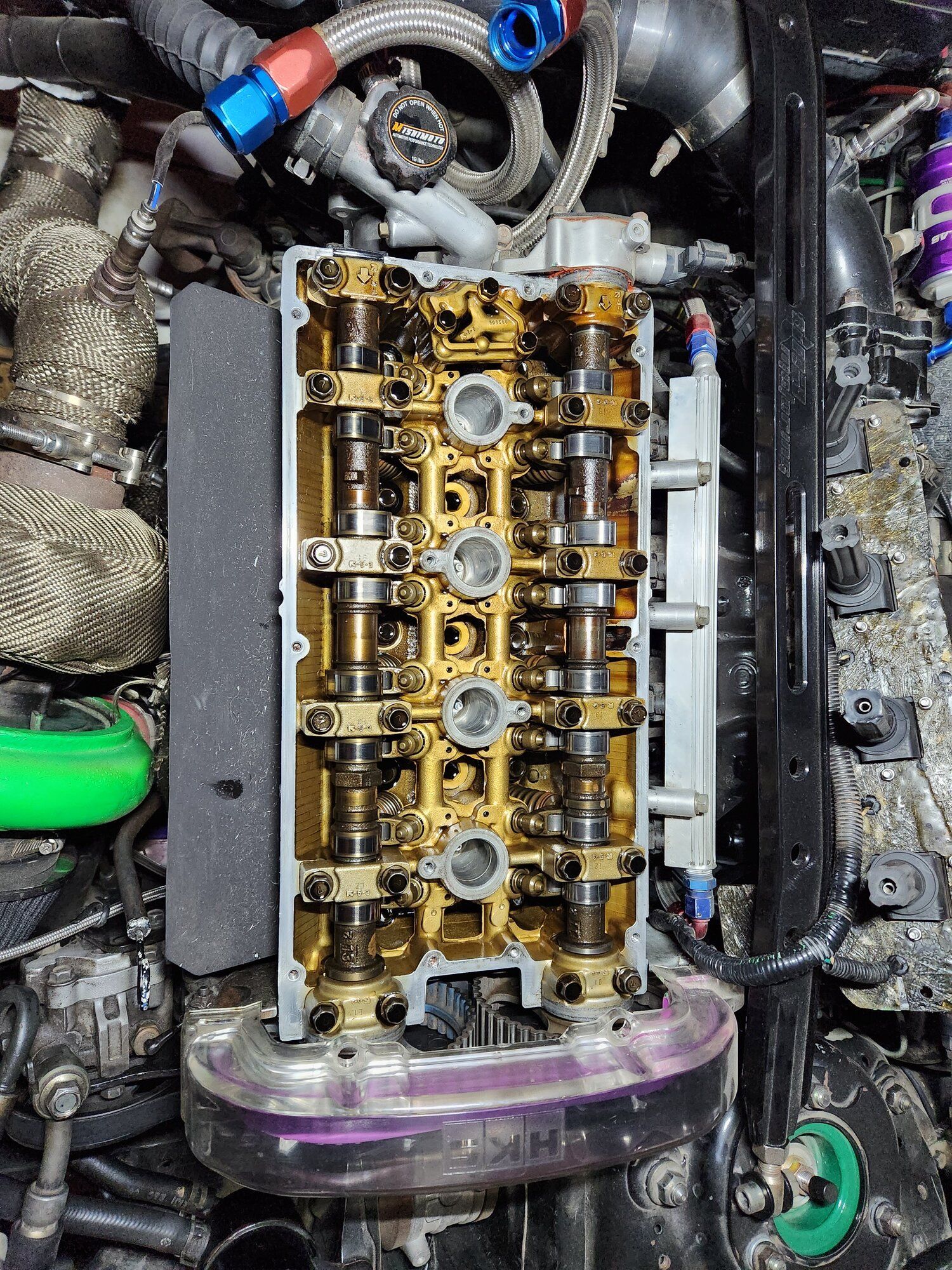

High mileage stock 7Bolt engine!!! Balance shaft delete, external oil cooler.
Mods-EMS & Logging
DSMLink V3 full on SD, Innovate MTX-L wideband, EVO prosport boost gauge, Innovate MTX-D oil pressure/temp gauge, cheap volt gauge, ecmlink boost by gear, HKS turbo timer, custom pc head-unit for logging and tuning.
Mods-Drivetrain
SS line from master to slave, OEM cut and weld shifter, stage 3 competition clutch, fidanza aluminum flywheel, solid shifter cable bushings, LSD.
Mods-Handling
DBA4000 t3 rotors, polyurethane motor mounts, stoptech ceramic pads, SS brake lines, GSX brake swap, unknown 17" wheels, front, rear and lower rear strut bars, Tein Flex Z coilovers, tubular upper control arms with camber kit, 225x45 tires
