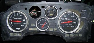

AEM EMS, 5 BAR MAP, GM IAT, DEFI BF (boost, egt, fuel pres, oil pres, oil temp, water temp), AEM WideBand & Serial gauges, Stewart Warner(Speedo, Tach)

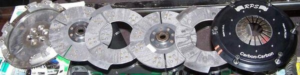

RPS Carbon-Carbon twin plate clutch, Shep Stage 4 w/quaiffe frt dif, 23 spline t-case, new & urethane filled carrier bearings, 4bolt rearend
