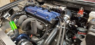

Mods-Bolt-on
Garrett GT3582R turbo
60mm MPx TB
3" Charge piping
4" Exhaust (custom)
Mishimoto FMIC
Mods-Engine
Wiseco Forged Pistons 10.5:1
Eagle H-beam rods
Stock crankshaft w/ King bearings
Crower S3 camshafts 250/254
BC SS Valves w/ 92lb BC Springs
SBi SRT4/PT Lifters
Mopar 2.7L roller rockers (Intrepid engine)
PTE 1260cc (120lb) LowZ Fuel Injectors
Stock coil
Stock Intake mani
Custom turbo mani
Mods-EMS & Logging
Megasquirt2 V3 (3.57)
Innovate Motorsports SCG-1 Wideband/EBC
Mods-Drivetrain
NVT-350HD w/ gears 1-4, 3/4 output, and input shaft all cryo treated and shot peened.
Clutch Masters FX600 Twin Disk w/ reinforced clutch fork.
Custom oil pump system for filtration and oil cooling.
Modified Ed Peters/Kinnett Kreations OBX LSD
Custom 3rd gear internal stop
Maddog STS, adapted to work/fit the DSM chassis, Dodge Neon shift cables.
