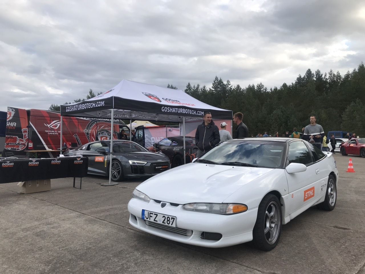

- Ownership Status
- Currently Own
- Year
- 1993
- Model/Trim
- Eagle Talon TSi AWD
- Drivetrain
- AWD
- Transmission Type
- Manual
- Build Type
- Drag Race
- Mods-Bolt-on
- Rewired Walbro 450lph in tank
Aeromotive fpr 43psi
Aeromotive fuel filter
bosch 2200cc injectors hi-z
Fuel line ugraded hi flow theflon ss
E85
Coil on plugs
Holset turbo HX35 motorsport upgraded billet 66/67 single t4 hotside 74 ar
Tial 45mm external gate
SS aftermarket turbo manifold
straight downpipe 76mm Hks back box
Front mount ic hard piping 76mm all round
JMF drag intake manifold with 80mm throttle body
spark plug gap 0.24
- Mods-Engine
- Fully build 6 bolt
Ported head 3 angle cuts
Cosworh 272 cams.springs ti retainers.ss valves
Wossner 9.5;1 cr. Tool steel wristpins.
eagle rods.
o ringed block.kigly girdle.
Full arp.oil gallery mod.balans delete.
ACL race main rod bearins.
- Mods-EMS & Logging
- Link G4
AEM 5 bar map & iat sensors
AEM 4.9 lsu wideband
- Mods-Drivetrain
- libertys faceplated dsm gears
Welded center diff
Tighten preloads
upgraded big shaft transfer case
rear diff end cover upgraded with solid mustache bar
4 bolt rear
tilton twin disc clutch with billet flywheel
Polirethane trans & motor mounts
- Mods-Handling
- D2 coilowers
Rotta attack 17×7.5j
Goodride semi slick 225 45 17
for drag hoosier 26/8.5/r15
Performance
- 1/4 Mile E/T
- 10.80
- 1/4 Mile MPH
- 129
- 60' Time
- 1.58
- Timeslip Details
- Fully weight
32psi boost
E85
hoosier drag slicks 26x8.0x15
On not prepaired track
Lithuanian drag race ( siauliai)
The best et 10.80
- Dyno HP
- 750 whp
- Dyno Type
- Dynapack
