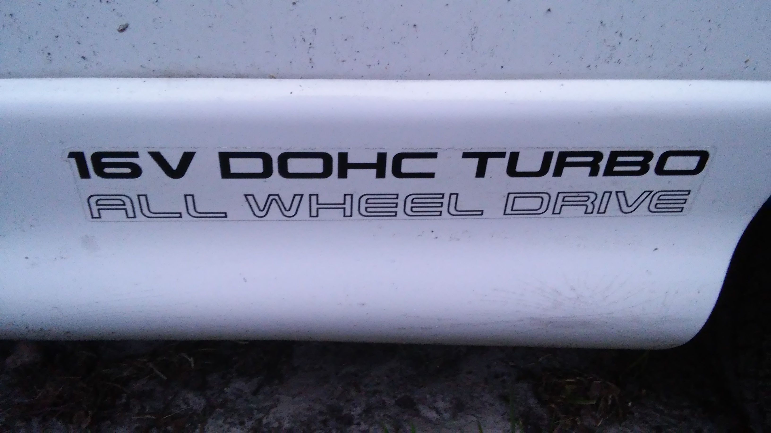

- Background
- Clock reads 57k.interior looks legit.lots of unususal dents.I think p.o had this car in storage for a long time.most bolt one came with car.putting 4g back together was not running.valve benderino.New head evo 8 valve springs and retainers.pipe dream is a semi reliable realistic 300 crank every other day driver.
