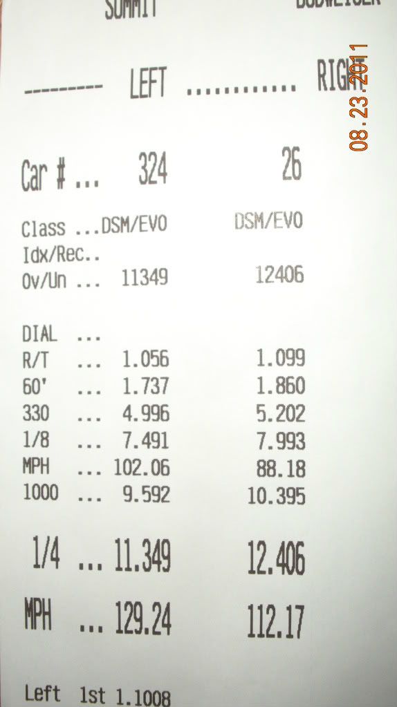

1/4 Mile E/T
11.340
1/4 Mile MPH
129.240
1/8 Mile E/T
7.491
1/8 Mile MPH
102.060
60' Time
1.737
Timeslip Photo Link
Timeslip Details
Track Name : Summit Motorsports Park
Nitrous : No
Fuel Used : E85
Vehicle Weight : 3100
Tires : Street Radials
Altitude : 775
