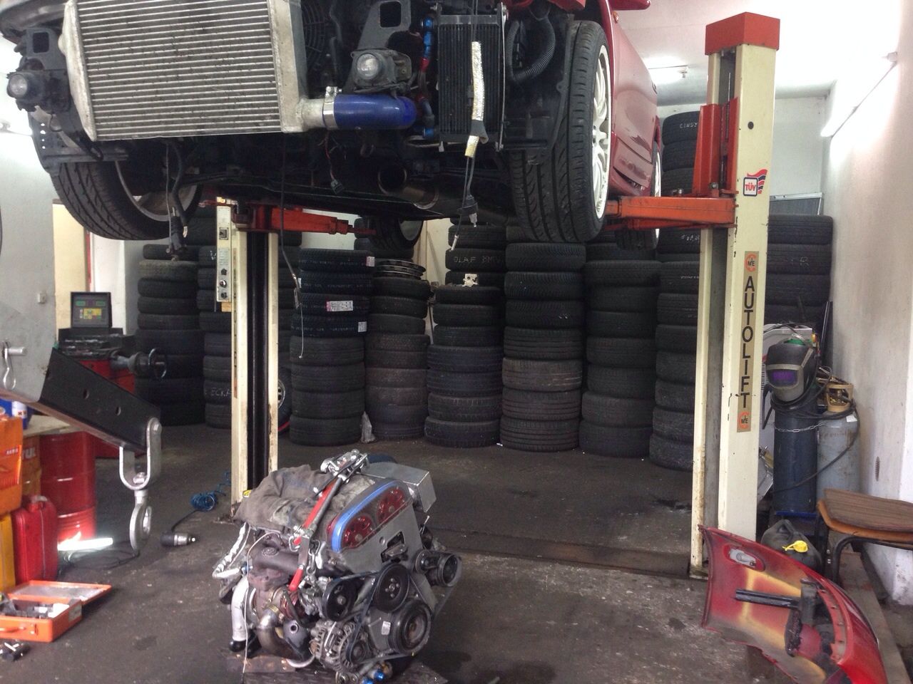

4g63 6 bolt swap, Gates Racing Performance belts, JMF Intage Manifold ( Race )
1200 PTE injectors, 225 Walbro hp Fuel pump, A1000 Fuel pump, fuel catch tank, Custom FMIC,
2x EVO XIII BOV, 3.5" Custom Downpipe and Cat Back, eleminate EGR, FP Aluminum Intake, K&N Open filter, FP Exhaust Manifold, GTX30 Gen2 (FP Hosing), Tail 44mm Wastegate, oilcatcher, setrab oilcooler, Koyo Radiator , 2 SPAL fans, Supersport S90 70 mm throttle, Fuelap fuel pressure, SlowBoy fuel rail
Mods-Engine

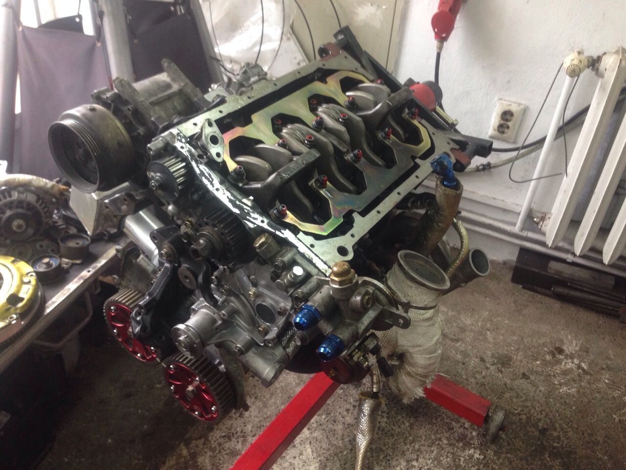

Manley H Beam rods, Wiseco Heavy Duty Stroker pistons ( 8.8 : 1 ), Eagle 100mm Stroke crankshaft, ACL Tri Metal Race bearings, ARP L19 head stuts, FP4 Camshafts, Arospeed Adjustable Cam Gears, kiggly main girdle, Supertech High Performance intake valve (1.00 mm oversize )
Supertech High Performance Inconnel exhaust valve (1.00 mm oversize)

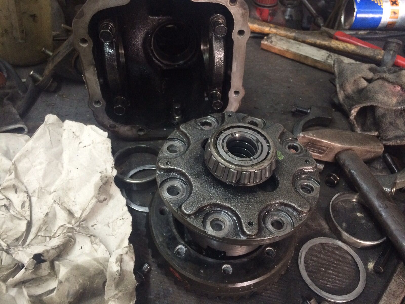

AWD, evo 9rs LSD rear, ACT 2600 Extreme 6 paddle Sinter clutch, Fidanza Flywheel, evo3 gear set
