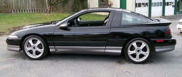

1990 Eagle Talon TSi AWD Vehicle Profile & Build Thread
BGage's Talon TSi AWD

  1. Street
Mods-Bolt-on
FP 68HTA Turbo ; eVO 3 Ex. Manifold w/ported 2g o2 housing, Fuel Lab FPR & gauge.
Eprom ECU, Walbro 255 pump, TurboX Boost controler, Short Throw Shifter, Cone Air Filter,
Avid Racing Mounts, ACT Light Steel Flywheel , ACT 2600 Clutch Assembly ,3 inch turbo back exhaust, Braided Steel Turbo Oil Feed Line , Magnacore Ignition Wires, Maft ; GM-MAF,
old Spearco RRE frontmount IC & piping, Sony stereo with one 10' Sony Sub.
Custom Carbon Fiber Console , suede headliner
Mods-Engine
Again A Brand New Build This Year:
Rotating Assembly Balanced
Entire Engine Blueprinted
Block Decked, Line Honed
Crankshaft Stock 4g63
Wiseco 8.5:1 Pistons & Manley Turbo Tuff Rods
Typhoon NA Intake Manifold (ported) [-A rare beast there!-]
Evo 3 Exhaust Manifold
Cylinder Head full rebuild and street Port job
Kelford 272s
Royal Purple HPS , SAE 10-30
Mods-EMS & Logging
Data Logger, ECU Eprom Chip, GM-MAF & MAFT
Mods-Drivetrain
John Shepard Racing modified 5 speed Trans, Act Flywheel, ACT 2600 Clutch Assy., Rear lower control arm Heim conversion / 'toe-in eliminator' kit installed, custom alignment specs.
(I now get real good rear tire life!) 4 bolt rear assy conversion,
Baer Big Brake Kit with 13" Rotors, EBC Redstuff Pads
BODY and INTERIOR MODS
Shaved Doors... door handles were removed, street rod style!
Talon Has GTX Black / Grey Interior.
The original stock Talon interior in white herringbone has been stored for 16 years,
and is absolutely perfect.
Mods-Handling
Lowered 3 inches+ all around, using DA Racing Coil Overs
Ingalls : Adjustable Rear Upper Control Arms (MY) 2nd design (see below)
NOTE:I bitched at Ingalls Engineering until they redesigned their crappy 1st design...
I'd broken three of them by then.Talked to an engeneer & told them how it should have been designed... Six months later the second design appeared...they credit me not...even if it was identical to the one I laid out to them... they didn't even offer to let me test a pair for them.
I thought it really small of them after wasting 3 sets of their 1st design crap that I had to PAY FOR even after the failures! So I won't buy their shit again... 'engineering' indeed.
I'll make my own. ;-)
Rear Subframe: High Durometer bushings
Rear Lower Control Arms: 'wrist' eliminator Heim Joint conversion
(I initially wondered, how I'd get on with them, but I truly love the now solid rear!)
(FREE INFO: best STREET tire wear spec I have found after 4 tire sets and much experimentation;) If you try it and like it let me know, that is all I ask in return.
Camber:
(One Deegree) Front, 1.0*
(Half a deegree) Rear 0.5*
ZERO TOE FRONT AND REAR
Road Race setups would naturally be more severe, this is for street tire mileage and it works!
D2 Coil Over Road Race Suspension
Front & Rear Strut Bars
American Racing Wheels 18 X 8.5
Toyo Proxes 4 Tires 225-40-18
