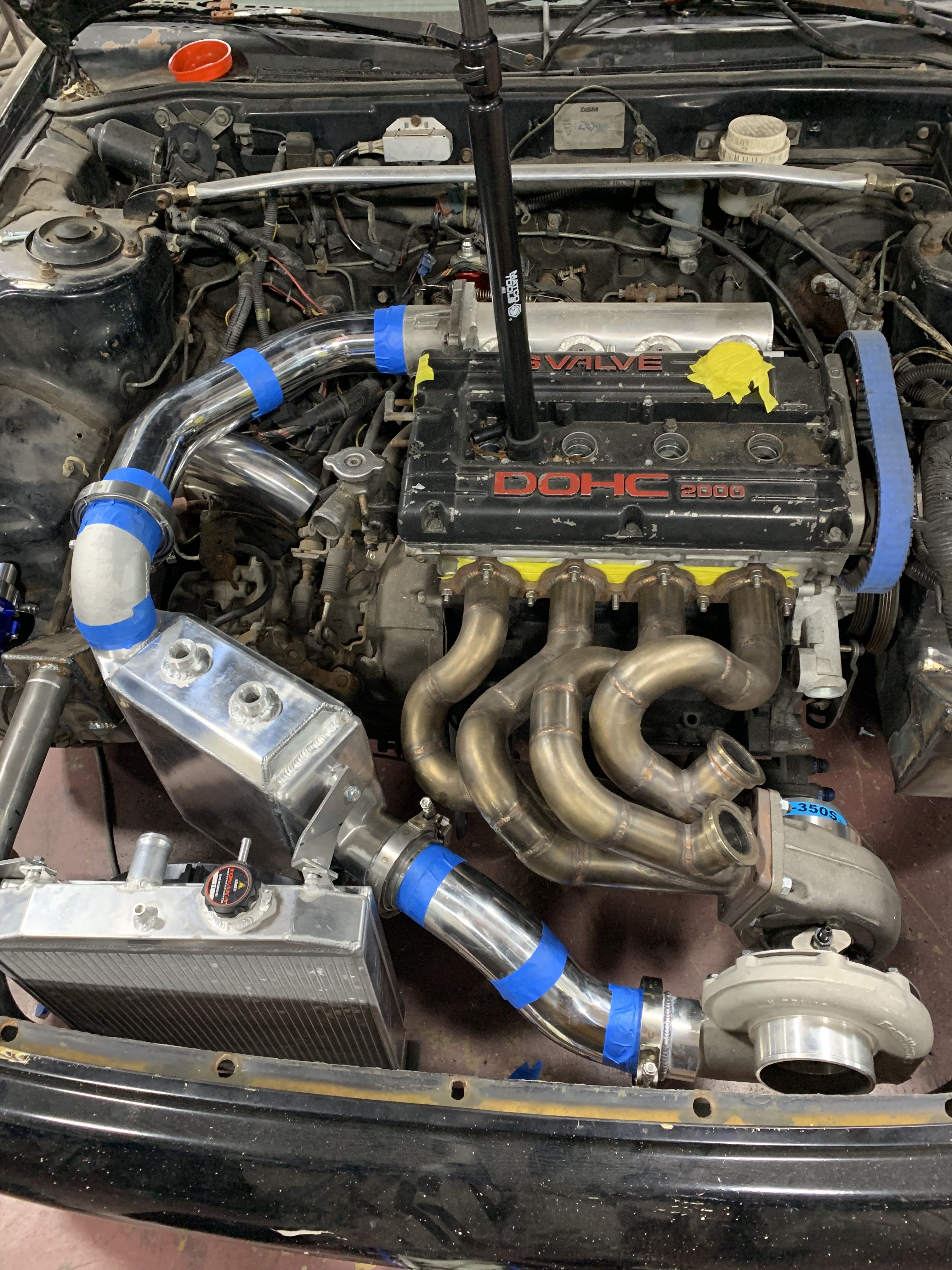

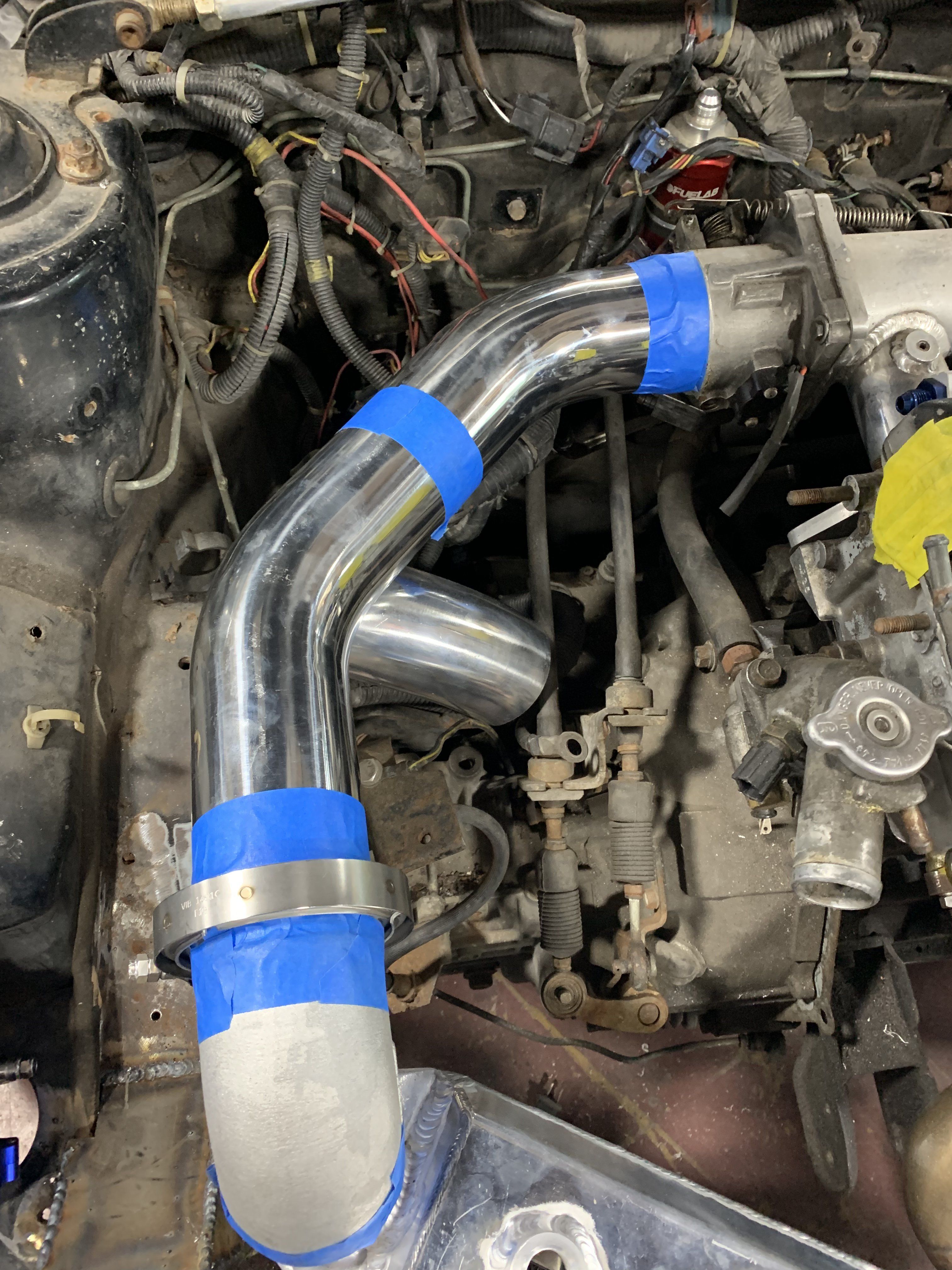

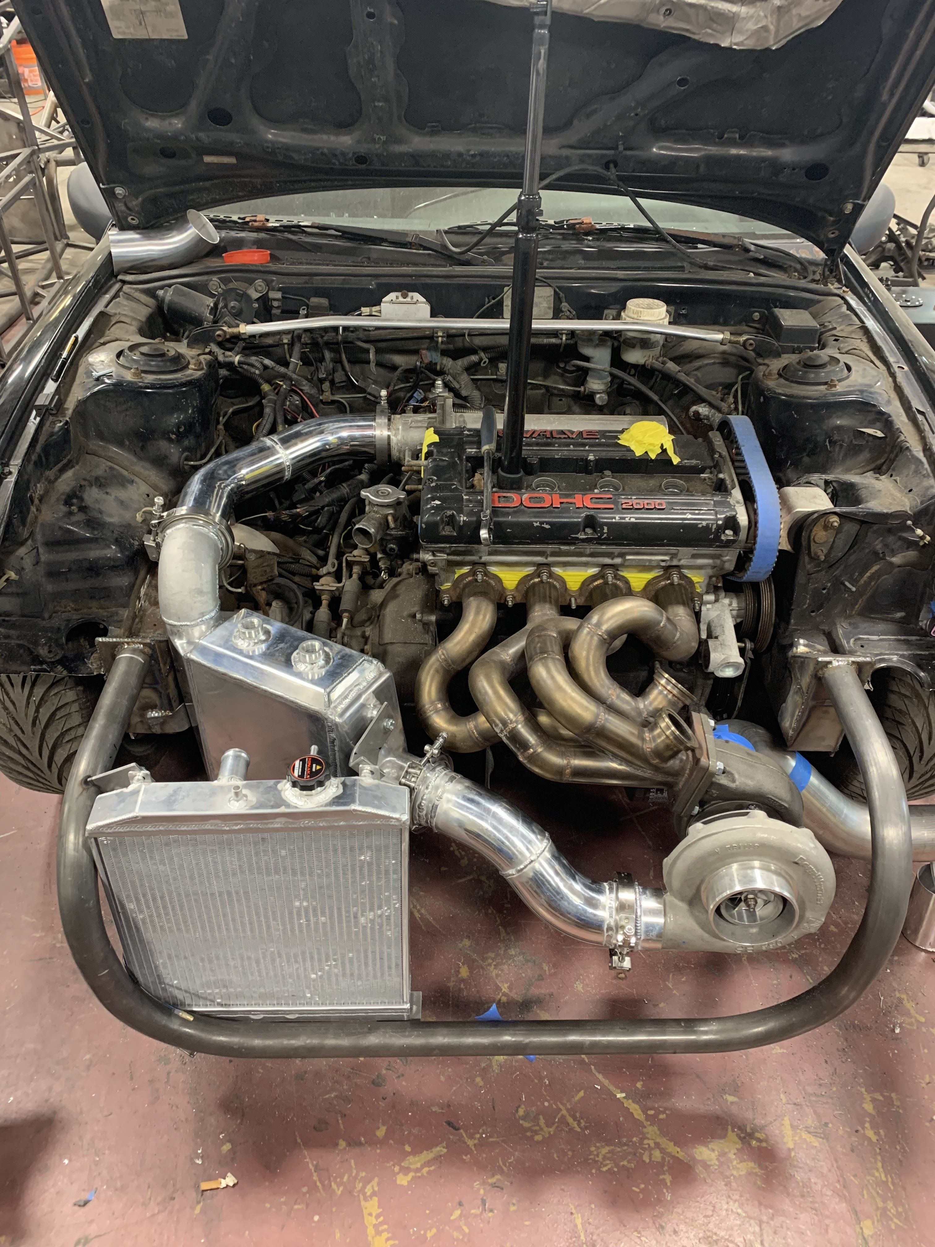

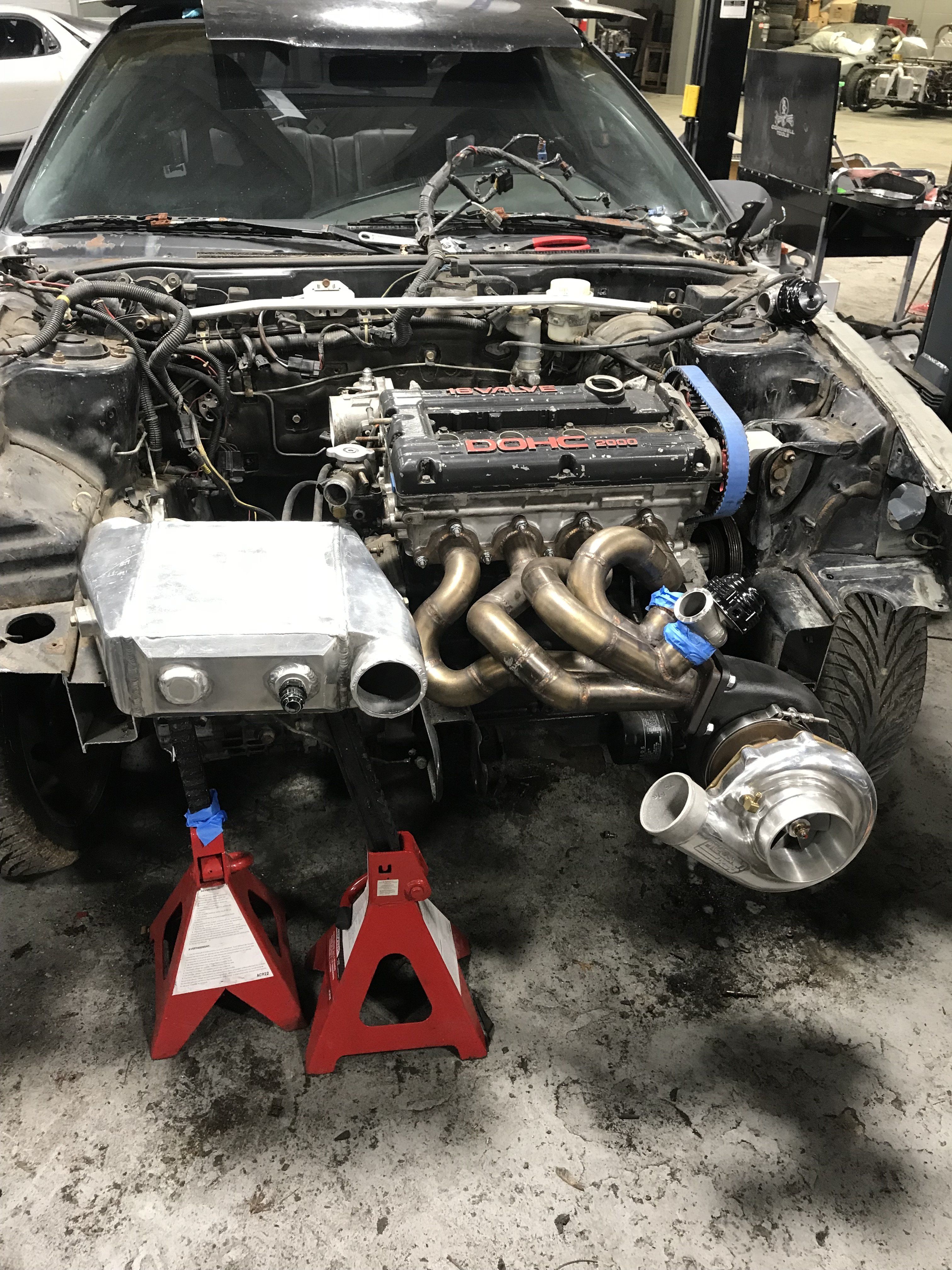

    Build Type:

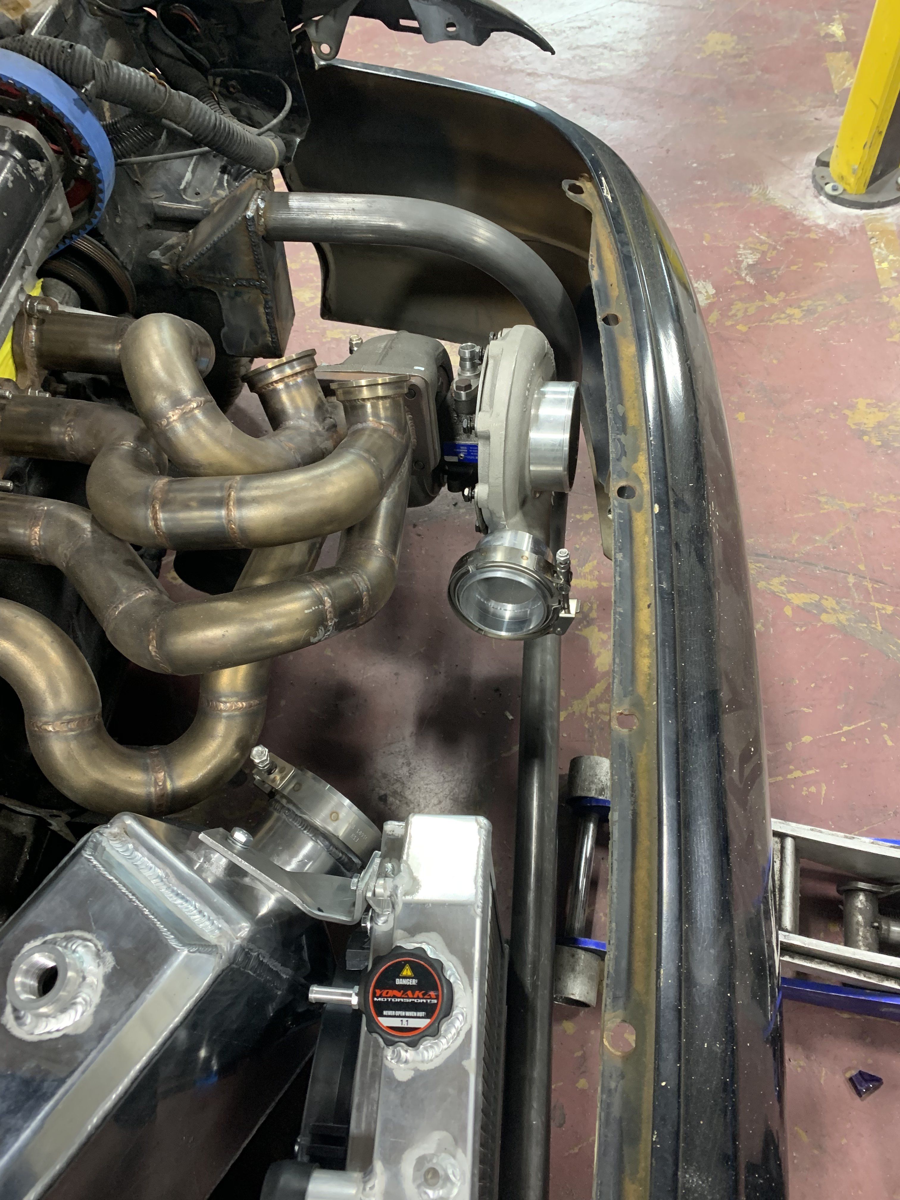

    • Drag Race
    Mods-Bolt-on:
    Turbo- Borgwarner S366
    Bushcur- intake manifold/75mm TB
    Custom exhaust manifold dual 44mm WG’s
    Custom air to water inter cooler with extra cooler to make it more streetable.
    Aluminum water box and battery in the trunk
    Half radiator
    Mods-Engine:
    Bottom end- Magnus 2.2L Destroke bottom end with kiggly girdle
    Head- hks 272 cams. AEM can gears
    Manley stainless steel valves, steel valve guides
    Manley springs and retainers
    Fuel- 2150 cc Bosch injectors
    Dual 450 walbro fuel pumps
    -8 feed -6 return
    Avid motor mounts
    Mods-EMS & Logging:
    AEM V-1
    5-bar map sensor
    Mods-Drivetrain:
    Shep stage 1 trans dual synchronized
    ACT stage 4 clutch and flywheel
    Everything else is stock at this time
    Mods-Handling:
    Eibach sport suspension
    EVO 8 Brembo braking in the front stock brakes in the rear
    Parts Wishlist:
    Haltech race wiring harness and race display
    8 pt cage

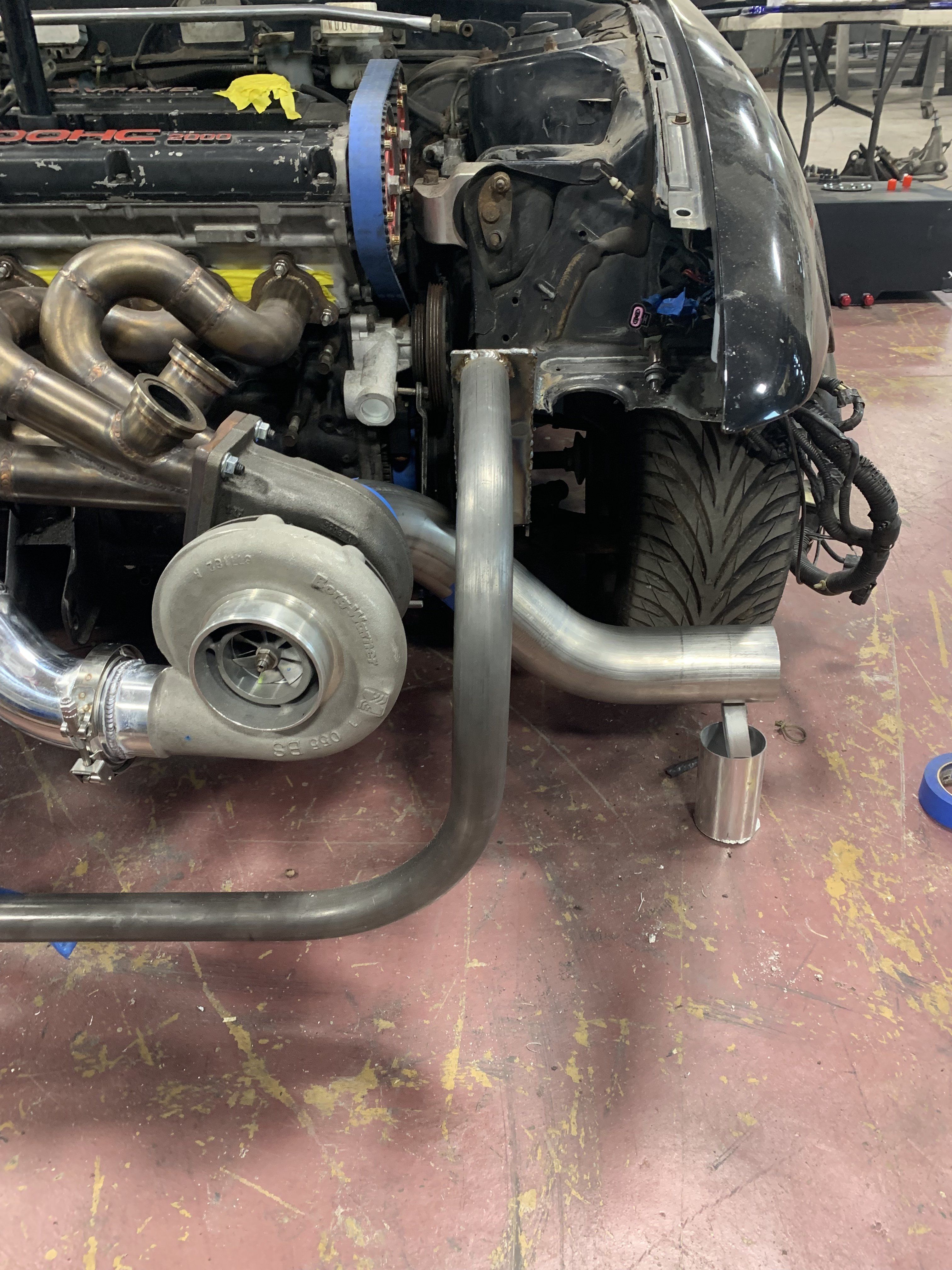

    Background:
    I’ve had the car for about ten years now. I blew the motor to pieces racing a olddd reliable 6.0. On a stock 6 bolt with a precision 5858 jb at 22psi. Like I said shattered the entire motor . Car has sat until the last couple years. Got a bug and went full retard . I mean full race. I’m using unique precision rotary out of Maryland. They’re doing all the work and tubing the front end. The cars not done and I don’t have numbers on it as of yet with this setup
