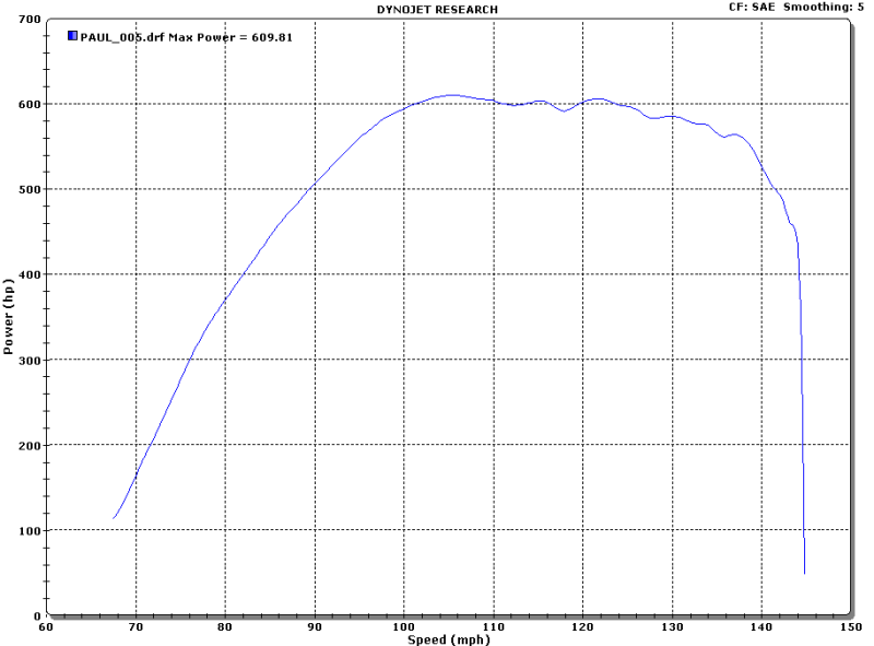

- Dyno HP
- 609.8 whp
- Dyno TQ
- 541.2 lb/ft
- Dyno Type
- DynoJet
- Dyno Shop Name
- Paul's High Performance - Jackson, MI
- Dyno Session Details
- Nitrous : No Nitrous
Fuel Used : Race gas
Turbo : B16G + 60-1
Boost : 47
Videos
Paul Volk's compound turbo dyno video
B16G and a 60-1. Running 47 PSI and flowing roughly 75 lbs/min airflow. 2WD Dynojet. 609 WHP, 541 ft/lbs TQ
