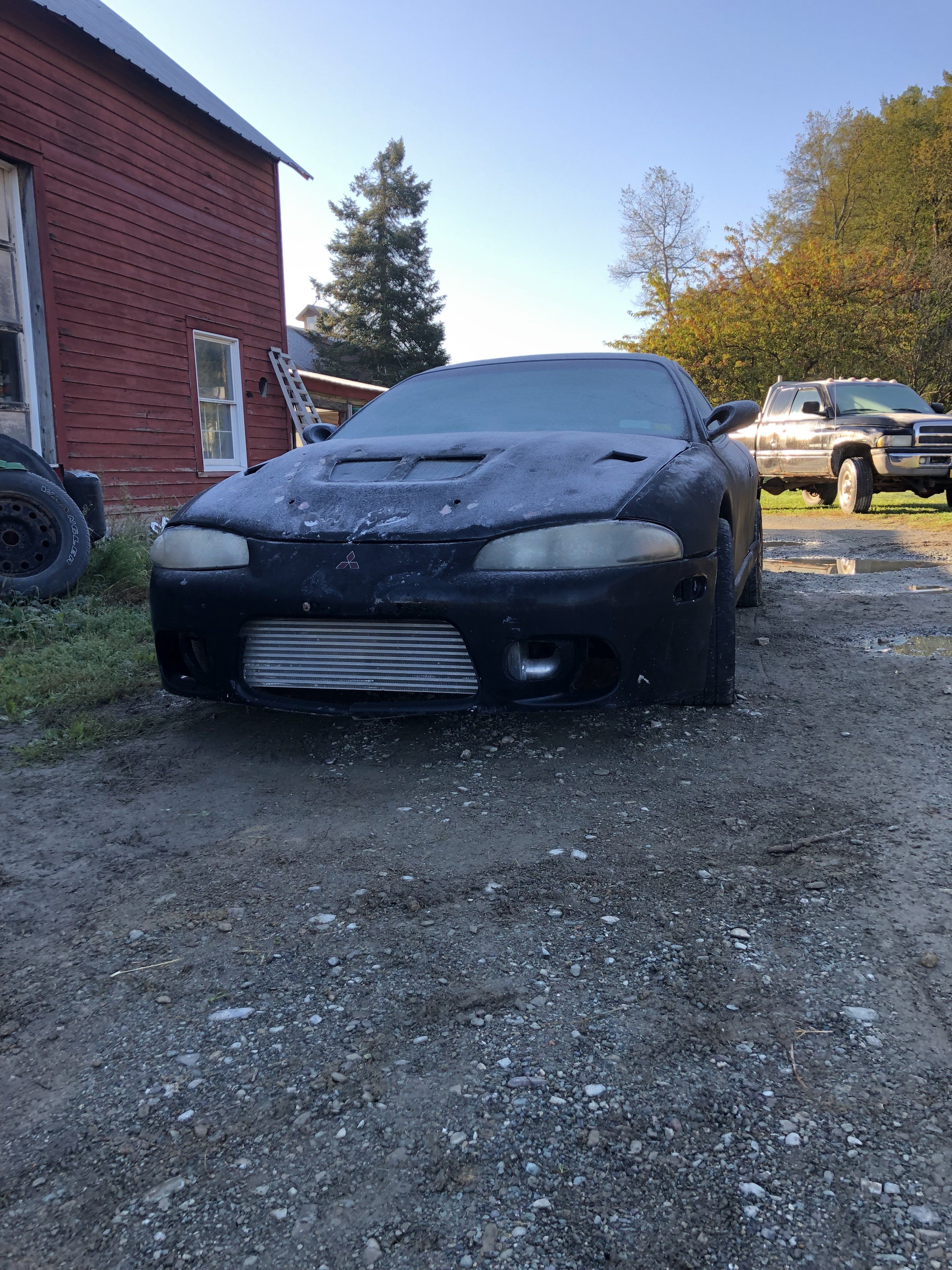

- Background
- Bought it off of a guy who didn’t know a whole lot about what was done besides what his friend’s ex told him when he bought it. It sat in a barn for 4 years. I bought it to fix up and return it to the road as the short block is apparently built and there were some decent bolt ons that are stated above. The car came with a stock non eprom ecu as the previous owner decided to sell that on its own. This is my first dsm and I have the goal of around 500hp and being able to daily it.
