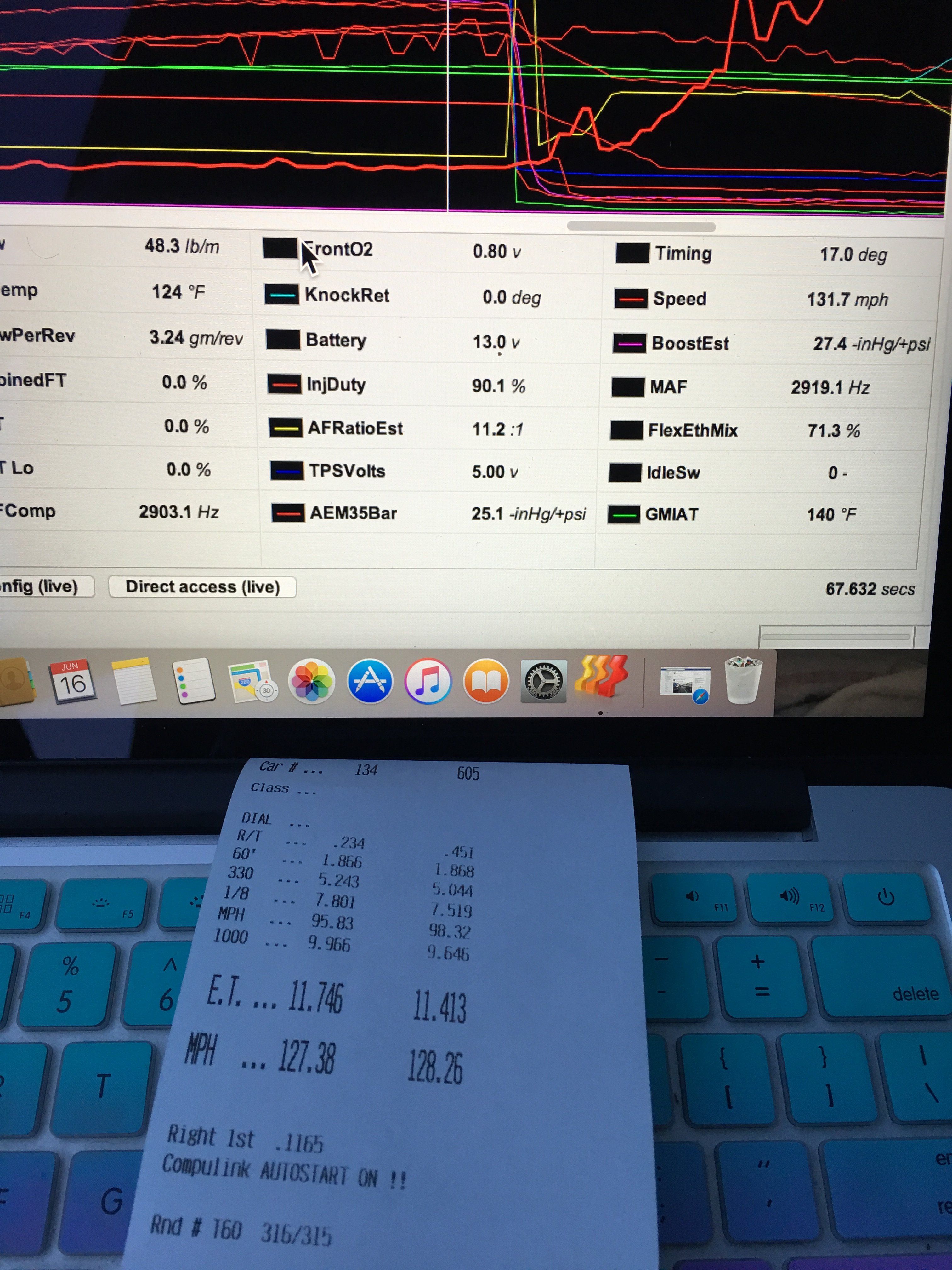

    Bought stock, self built and tuned. English Racing tuned for Flexfuel.
  • 1/4 Mile E/T:
    11.746
    1/4 Mile MPH:
    127.38
    1/8 Mile E/T:
    7.801
    1/8 Mile MPH:
    95.54
    60' Time:
    1.866
    Timeslip Photo Link:
    Timeslip Details:
    Turbo Used: 20G
    Type of Fuel: Pump gas
    Nitrous? No
    Tires Used: Street Radials
    Race Weight: 2400
    Track: Pacific Raceway
    Tranny: Manual
    Sponsored Car? no
    Dyno HP:
    417.5 bhp
    Dyno TQ:
    400 lb/ft
    Dyno Type:
    DynoJet
    Dyno Sheet Photo Link:
    Dyno Shop Name:
    English Racing
    Dyno Session Details:
    26psi. e85, out of fuel.
