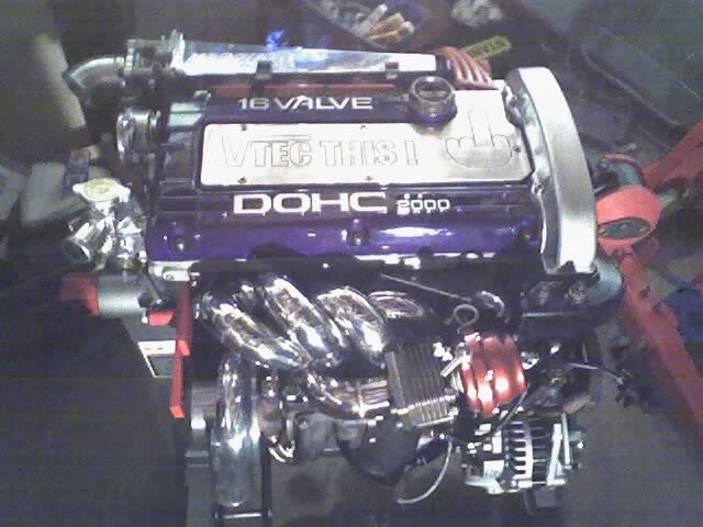

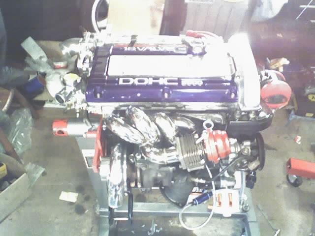

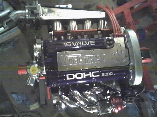

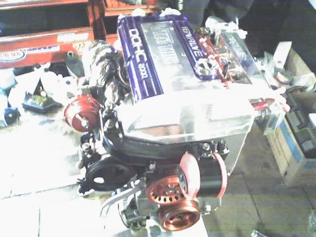

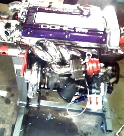

Mods-Bolt-on

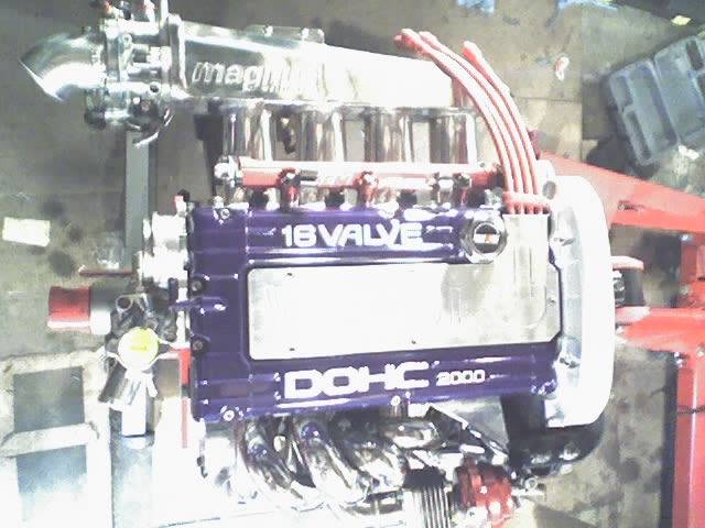

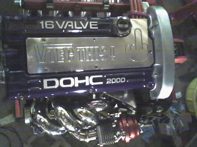

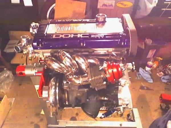

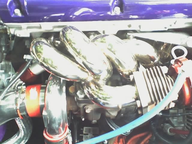

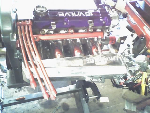

FP Green, DMP header, Tial 40mm wastegate & 50mm BOV, Hallman cockpit adjustable MBC, 3" ATR O2 elim exhaust, Fwd facing oil filter housing, Earls oil filter w/ss oil lines, Moroso pan, 3" Buschur intake/FMIC w/2.5" ss pipes & t-body elbow, 62 mm t-body w/aluminum butterfly & EGR blocked off, Sumped tank, Aeromotive A1000 pump & regulator w/-8 lines, AEM rail, FIC 850's, No cruise control, Magnus intake w/ heat barrier gasket, 10 mm Magnecor wires, NGK 8's, JM Fab coil bracket, Powder coated valve cover, thermostat neck, & engine lift, Billet plug wire, thermostat, & cam gear covers, Jay Racing alternator relocation kit, Battery relocation kit, STM dipstick tube, Ralliart vapor catch can, Fluidyne radiator, Braided coolant hoses, Billet coolant recovery can, White gauges w/aluminum bezel.
Mods-Engine

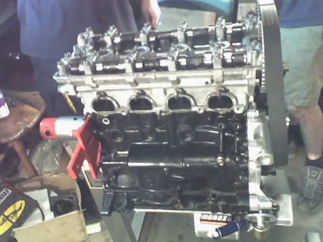

BJ'S SHEP-SPEC head w/ Crower double springs, 1 mm oversized ss valves, brass guides and titanium retainers, HKS 272 cams, Big bore lifters, Cometic HP head gasket, 6 bolt G4CS block bored .020 over, Wiseco 9.0:1 pistons, Crower rods, ARP fasteners all around, Balance shafts removed.
Mods-EMS & Logging
AEM w/Uego wideband.
Mods-Drivetrain
'94 BM Tranny race transmission w/4 spider gear setup, Fidanza flywheel, ACT 2600, SS clutch line, Flywheel scattershield, Drilled aluminum pedal covers, ACT short shifter, '94 shifter/cable assembly, Symborsky shift kit, Ball bearing shifter cable bushings, Momo shift knob.
Mods-Handling
MR F&R strut tower braces, GAB adjustable struts, Eibach springs, Suspension Techniques rear sway bar, Suspension Techniques urethane motor mounts, Suspension Techniques urethane bushings all around, 17" TSW VX1 rims w/Toyo T1'S for the street, 16" RX-7 rims w/Nitto 555R'S for the track, ARP extended wheel studs, Light weight wheel lugs, Goodridge braided ss brake lines, Front brakes upgraded to '92 dual pistons, Brembo cadnium plated cross drilled rotors F&R, Motul synthetric DOT 4 brake fluid
