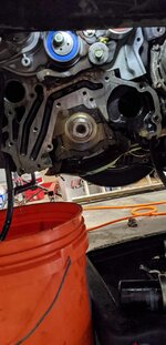

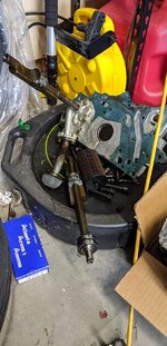

Straight cut oil pump gears with OEM Balance Shaft delete
