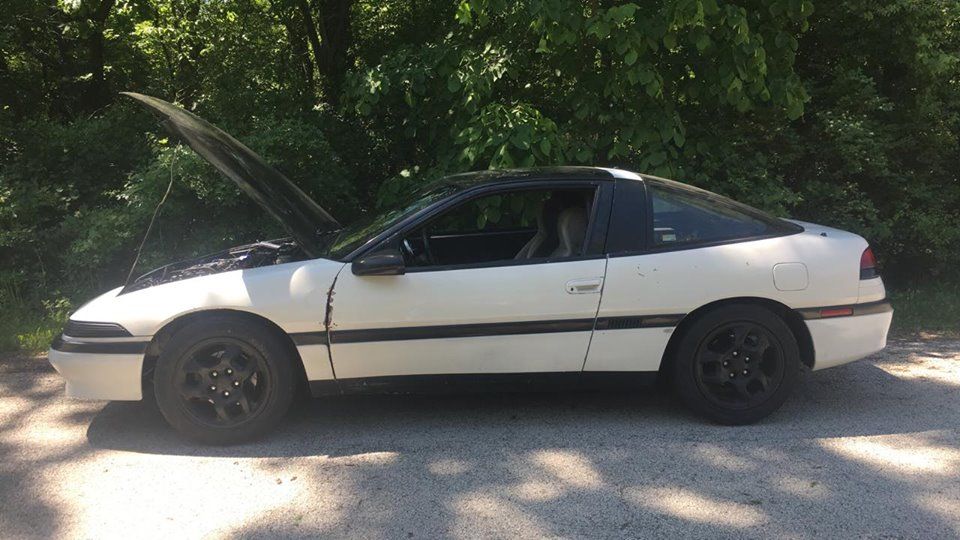

- Mods-Bolt-on
- gt35r turbo with custom log manifold, tial wastegate, greddy recir. bov, PTE intercooler, AEM fuel rail, walbro 450 in tank pump with aem 380 in line on a hobbs switch at 4psi
- Mods-Engine
- 2.3l Stroker, JE Pistons, Eagle crank and rods, BC 280 cams with supertech valvetrain, ported intake manifold, 1650cc FIC injectors, E85,
- Mods-EMS & Logging
- Ecmlink v3, aem wideband, fuel pressure gauge, boost gauge, tach,
- Mods-Drivetrain
- Built Trans with Quaife LSD,
- Mods-Handling
- KYB struts with eibach springs, equal length Raxels axles, 3000gt hubs,
