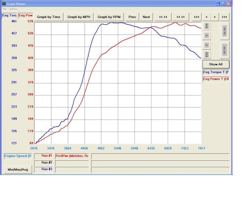

I would like to consider my 67mm on a 2.0L hits pretty hard, but it's a T4 setup with a nice manifold.
From my dyno graph at 31-32psi, I go from 220ishTQ@4200 to 460TQ@4900 (roughly) Also 180HP at 4200, 450@ 4900rpms (roughly).
The FP88HTA should be a badass turbo, but without a doubt put it in a T4 housing.

That must be a stroker cause no way a 67mm turbo in t4 housing spooled that good.
Edit: I just looked at your profile you have 9:1 block I take it that is the reason. Kinda makes me happy to see higher compression has that much of an affect on spool. A lot of people used to argue that the 8:5:1 2g pistons on 1g rods didn't do anything but obviously it does.

Rob's case is atypical. His setup just spools really well. It will not apply to many 67 setups on 2 liters esp. those with sizable housings. Not .63a/r junk.  It could be the divided housing he's using too. C.R. doesn't really affect spool much. My car gets full spool at the EXACT RPM with the stock 7.8:1 C.R. and the 9:1 it has now on the same setup. That's more than one point increase with no change in spool. Displacement helps a ton though.

Hmm well I figured he was more the exception than the rule but still that's pretty good spool characteristics no matter how you cut it. I'm going t3 .70ar with my setup trying to keep it street friendly with good top end.
