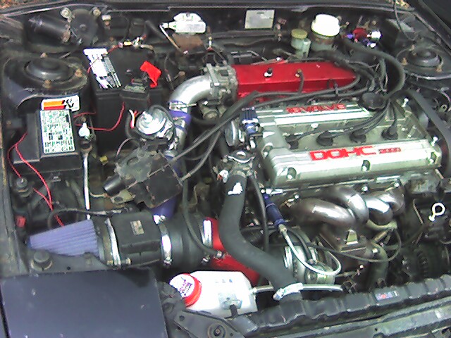

Photo_042907_011 That'smy old 1g. GT14 with 4" intake and 2g maf as you can see. As you can also see a AFPR. I had a wabro 255hp intank with stock lines. I know exactly what your going through and TRUST me what you think you dont care about is what's part of your bigger problem. Without the ability to tune right you will run rich/lean and not be able to run right = not being able to boost. Save up charge people for the work your doing instead of trading till you can get a afpr than see what's not working.
Edit: By the way fp3x's are pretty dam aggressive cams. You will lose vaccume a idle which will make things even more interesting. Those are actually geare more for a stroker motor.
