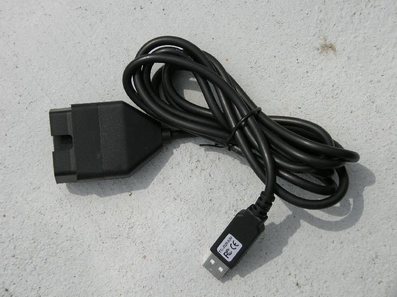

So would the tactix openport 1.3 cable be much faster than the vag cable.
KEYDIVER Chips -2G DSM and EVO Logging Cables
eBay Motors: USB Cable KKL 409.1 VW/AUDI OBD2 OBD OBDII VAG COM 409 (item 370182778324 end time Apr-12-09 13:21:40 PDT)

This is the cable I plan to buy, opinion Ceddy?
eBay Motors: Vag-Com USB Interface KKL 409.1 OBD2 OBD AUDI VW SEAT (item 170314285785 end time Apr-22-09 12:10:59 PDT)

Quote:
No. Same.

Quote:
Originally Posted by the_mork View Post
to reflash the 98/99 ecus you need to supply 12v to the datalink pin.
16 volts to reflash.
Everyone asking about cables. The VAG 409.1 I have performs the same as my OpenPort 1.3U.
