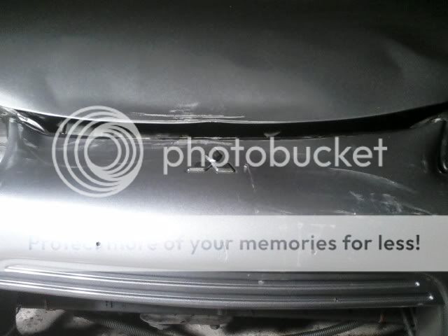

Hey everybody... Remember that eclipse I spent my entire senior year fixing up and repairing to make it look exactly like I wanted? Probably not... But let me assure you I remember this car and Here is what it looked like.
And as of 11:19am on 05/05/2012 this is now what it looks like...
Now not only is the damage done to the bumper and hood but underneath is the frame that the headlights and bumper screwed into and the hood latched onto. Along with the hood and bumper crushed and pushed down the frame is also bent along with it all. My insurance does not cover any damage done to my car and with less then $140 in the bank (you can subtract $75 from that amount due to the ticket I also received) im alone on these repairs... I have a bumper so that is okay. But now I need a hood and I need to find a way to fix the frame.. Does anyone here have any ideas on how to possibly fix this or make it look better? I will be getting a new hood eventually so my main question is how do i fix the front frame of my car :/ (Lets all not forget that I JUST had this car painted. Less then 3 weeks has gone by )

Alright ill go get a picture of it. The damage that's done is the the frame in front of the radiator, It didn't go far past the hood ill go take a picture now and upload it thank you all for the help lol I really appreciate it! The hood can open and close iv done it a couple times and the car still runs fine its just body damage :/

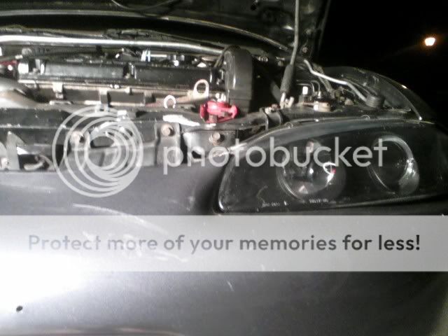

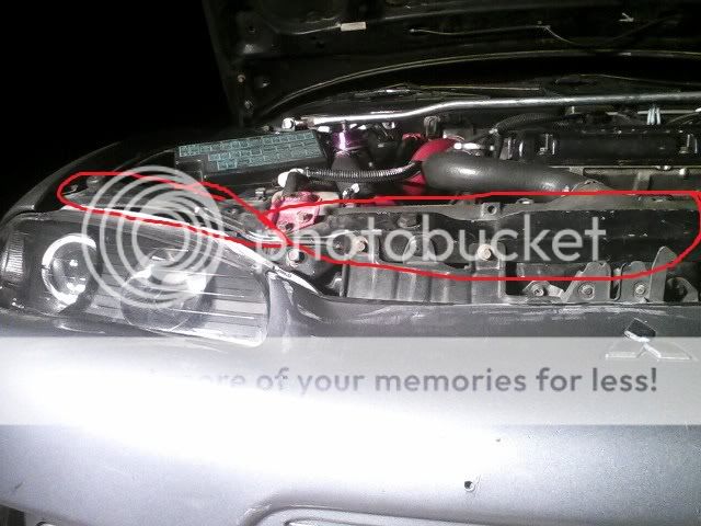

Ok here you go guys I got more pictures, Redslayer your exactly right its that part thats bent. Its the reason my hood will latch back on after i open it lol but here you go guys heres the pictures.
You can see the frame bent where I circled it and iv taken some other pictures as well to show more of the damage but it kind of stops at the front of the frame h=just before the radiator.

That is very close to how mine was bent up.

Two things, you can do, as stated above. One bend back the core support and try to setup everything how it was even. Two, You get a new core support and rebuild from nothing and feel a little better at the end of it all.
To be honest, I have seen much, much worse and comes out looking like new.
