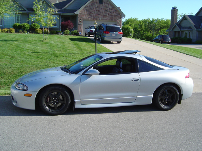

Help With Drag Setup
My best is currently a 12.15 @ 115 1.76 60' on 93 oct pump gas @ 23psi on the PTE 5031RE. I'd like to see an 11.7 on pump, but I don't want to push the stock engine much harder, so to get 11's on 93 oct I've done/am doing the following:
-Shep Stage 3 Tranny (done)
-Punishment Racing Radiator (done)
-Motor mount inserts (front and rear - not done yet)
-3.3 GM Map Sensor (to help with a better tune - not done yet)
And I'm thinking about doing Alcohol Injection (Devil's Own).
But one thing I'm certain I'm doing is suspension and lighter weight wheels, as I'm still on the 25 lb stockers and stock suspension. I'm about to order the Tokico Illuminas and Tokico springs for the suspension (1.75" drop). And for a tire I'm thinking this: Tire Details - Discount Tire Direct
Mainly b/c I've been searching around in this section and found it in a recent thread, haha, and it seems great for the price.
But for wheels I'm not so sure what route to go. Does rotational wheel weight really make enough difference to help me out? Should I go with 16's or 17's? Although performance is my main concern, I also want them to look decent.
My budget for wheels is right around $1000. So if you guys can give me some help or make some suggestions I'd really appreciate it.
Thanks.

A) Any pics of Slips on a 2G with a 1.75" drop and a tire with a decent sidewall will help me.
B) Also, every Slip I see on a DSM is either black or gunmetal. Does nobody like silver or steel grey?? Haha. Pics of those colors on actual cars would be helpful.
I've searched for both of A & B for hours and hours - not much found. Suprising for such a popular wheel. Maybe I just suck at searching??
