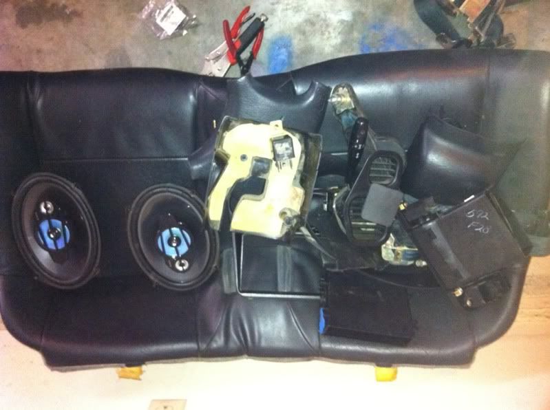

November 18, 2011 – Moved. Black interior, vented hood, misc acquired
Moved into a new house since the last update Car now has a new home and will be garaged every night
Meanwhile, I worked out some trades with a couple friends
I traded an aeromotive afpr I had lying around from my previous build for this
I then traded the NOS parts to a friend that has a GTO and plans to spray it. It pays having good friends
Hey these are pretty nice
Oh but what's this?
Noo...could it be?
Why yes, yes it could full black interior!!!! Well, almost...it's everything that will work in my car from a spyder. Also, a few more goodies...
Fog lights, covers, clear turn signals, reverse lights, other random crap
Also getting a pretty beat up evo style carbon fiber hood I'll be sanding it down back to the carbon fiber and see if I can work with the current hood pin locations (they are uneven, I'm hoping I can even it up with aerocatch latches)
I have the dash too, just haven't picked it up yet. Literally everything black that was in his car I took. Plus the other random goodies.
Now for the best part...I paid $15....for all of it!!

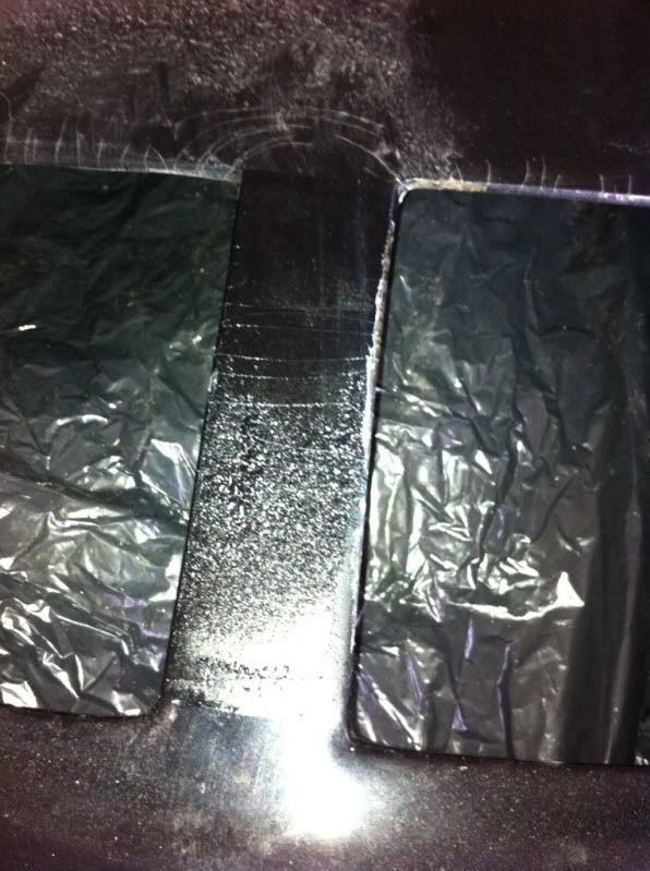

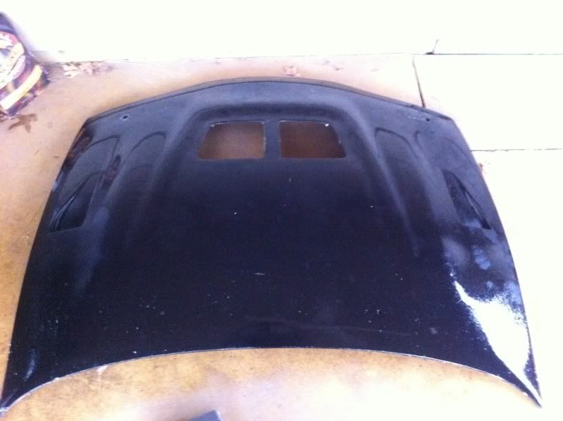

November 29, 2011 – Stripping the vented hood
As I mentioned and posted earlier, I got a vented hood in the trade so started stripping it down back to the carbon fiber. I started sanding at about 3:30 with a fine grit sponge (not sure what grit, I would guess 300 ish). Well that was taking forever so I switched to 150grit sand paper..that took forever too so I switched to 60grit. That worked a little better but at this rate it will still take me a good week to get this thing stripped down to the carbon fiber. And that isn't even including if its salvageable and I have to strip the gel off too.
Here is the hood
After 1.5 hours of sanding...
I will be cutting out the middle divider in the vent and seeing if an actual evo's mesh will fit in the hole with some trimming… (it doesn’t for those that are curious)
I scrapped the sanding idea and got some advice about using paint stripper...so I have half the hood stripped and no ill affects yet. I need to smooth out the part I began sanding on with the coarse sandpaper but that's not too involved either. I will finish up with 500 grit sandpaper to take out any deep scratches in the hood and then go from there.
Here is the progress so far!
Bought this
Tested it on the piece I'll be cutting out
Looks good to me! Except or the cracks and sanding marks from when it was painted..
So I covered a big portion of the hood..after first coat
Second coat
I had to leave for work so I wiped the stripper off and will continue tonight. It seems to eat the paint and make it bubble up, then the second coat makes the primer turn to liquid and easy to scrape off..it's messy though! I’ll be working on this at various times throughout the winter so updates will be sporadic :P

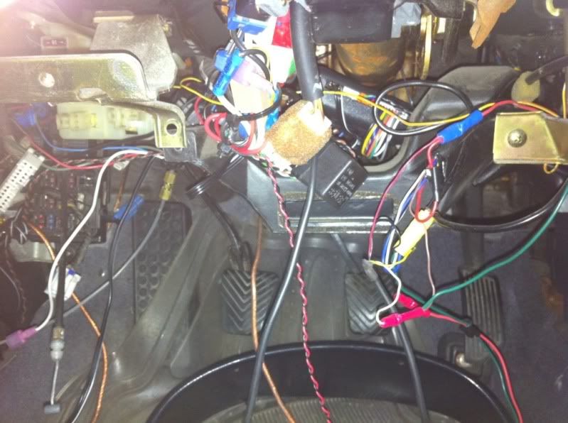

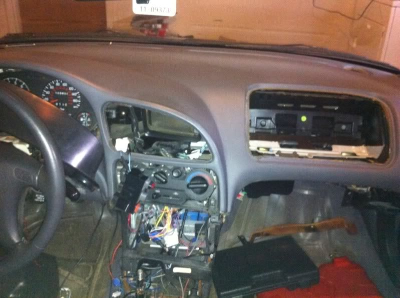

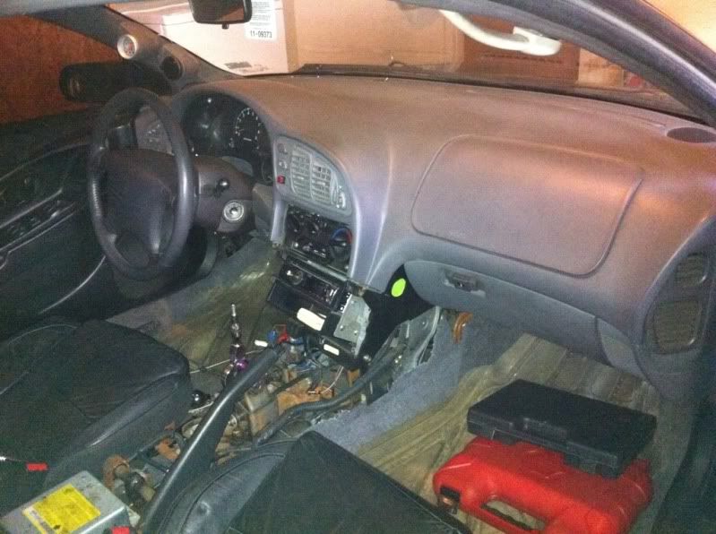

January 4, 2012 – Black Interior Install
As I said earlier, I acquired most of the pieces for a black interior and I finally got around to swapping out the dash. Sorry for the crappy pictures, my iPhone seems to have crapped out that day lol. New updates as of February 21, 2012 will contain nice pictures taken with a dslr
Center console removed, gray dash still in
Airbag removed and other such things
Let's get this thing outta here!

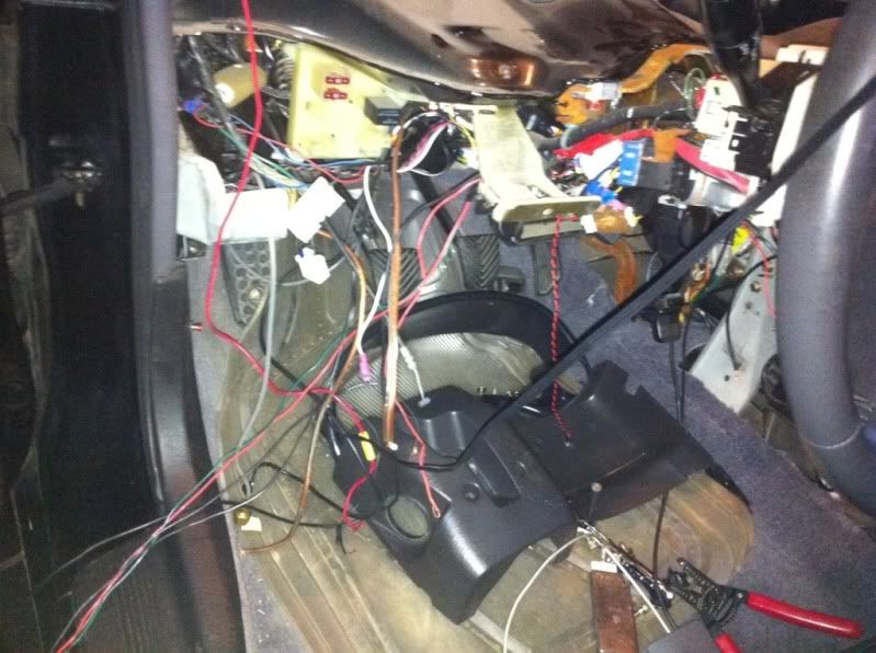

....This looks like crap...time for rewiring...
So much wiring...
Dash out
Encountered a small problem...dash harnesses were different :/
Time to swap them out

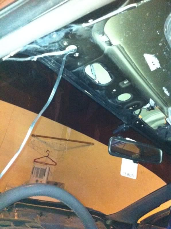

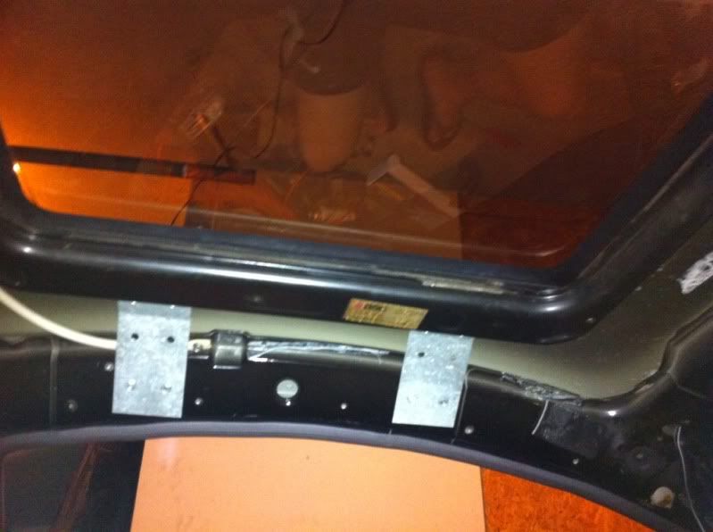

Got the wiring swapped out and realized I didn't like how crappy the roof looked without headliner and the aftermarket sunroof wires running everywhere (NOT my doing)..didn't work anyways
Manual sunroof conversion done Much cleaner...for what it is anyways
Ok, so in with the black dash. Had to swap out the VIN plates as well
Its in!

January 11, 2012 – More work on the hood
Got bored last night and decided to work on my hood again. Decided to bring a new weapon to attack the paint with...
So yet again, put on the stripper and let it sit
Let it sit for a while and then scraped/wiped off the paint and primer. Did that 2 more times and still didn't get it all off
Started working on it this morning and decided to use the stripper again so I could just wipe off the primer
Finally got it to this point after wet sanding and then taking it outside for some more regular sanding. The filler still needs to be sanded off and then inside of the side vents but it's almost there
I am probably just going to spray it with plasti dip until I save up money for paint. I would rather do something temporary than attempt to paint it myself and have to do this process all over again
