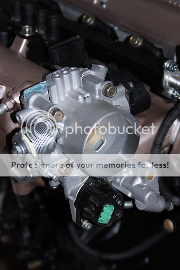

Throttle Body & Final Assembly
Posted 05-10-2011 at 05:09 PM by VETDRMS ('97 TSi AWD Auto 2.4 Build Project)
I sent the throttle body off to Steve at throttlebodys.com, who did a great job and had a very fast turnaround. I had the "uber" seals installed that are tested to 40+psi. The sensors also checked out good. He also machined out a minor scrape in the inlet area. There shouldn't be any leaks...
