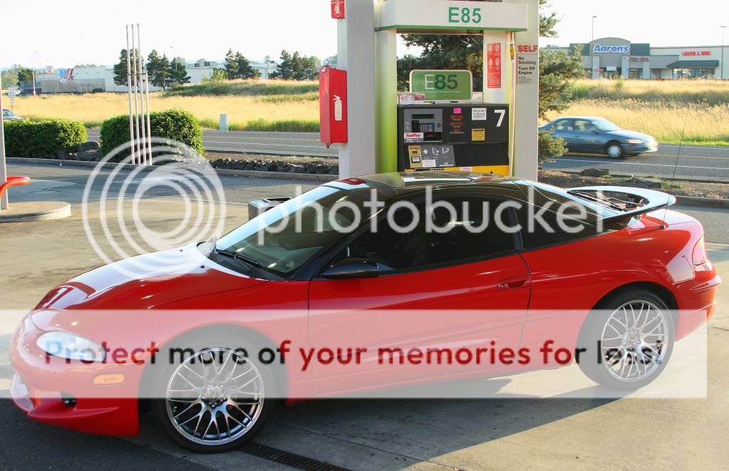

It made the 300 mile round trip with no issues and managed 21mpg on E85.
