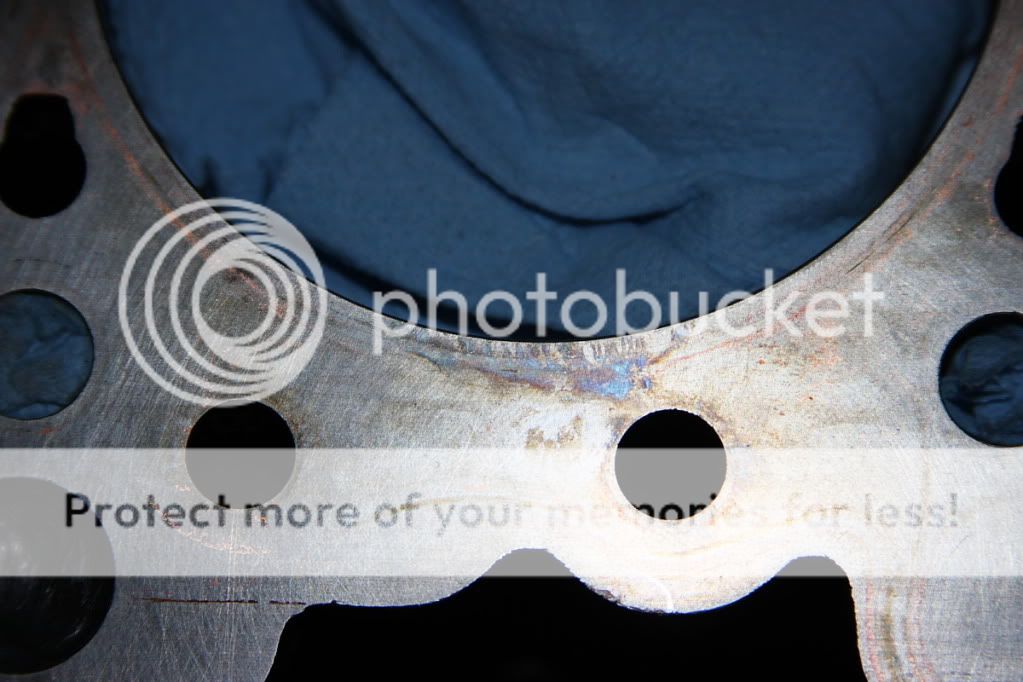

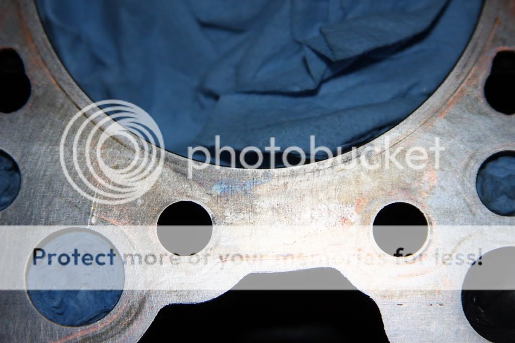

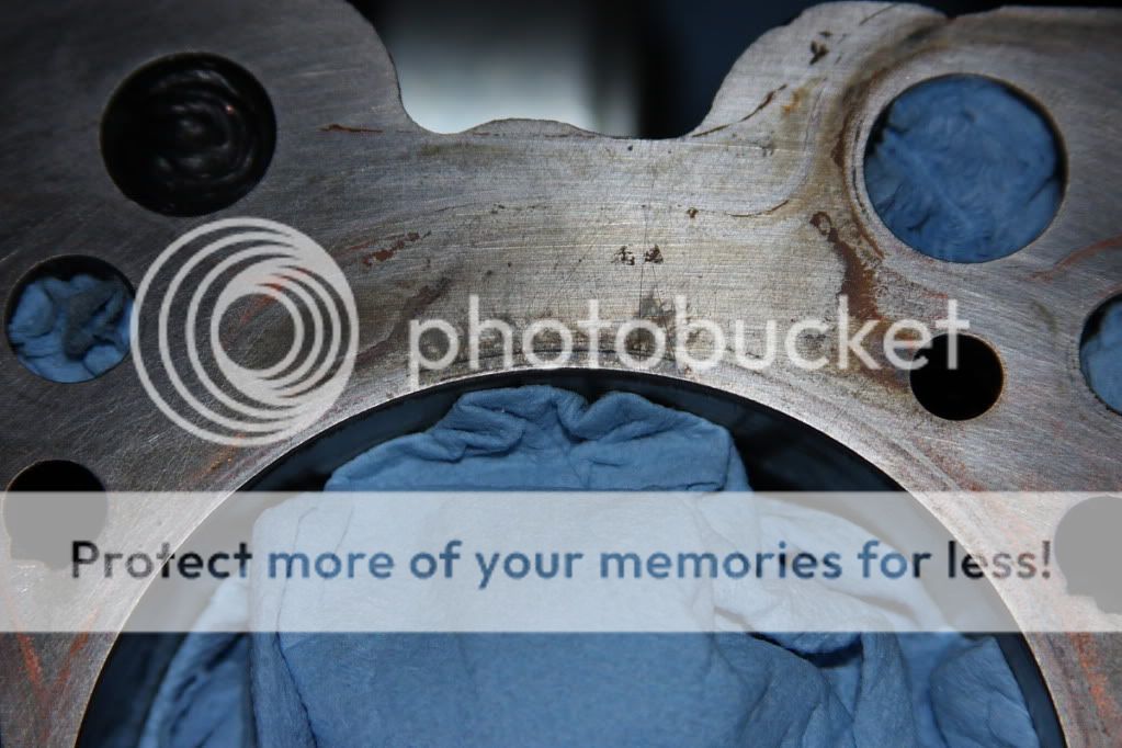

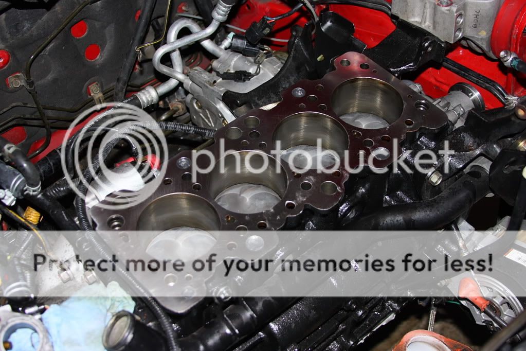

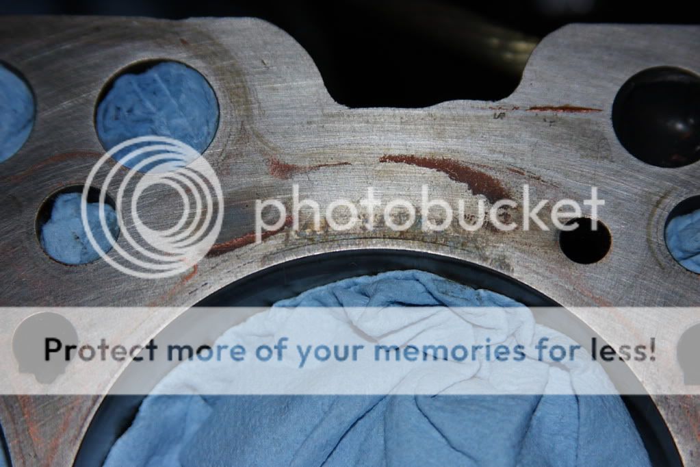

Once I got the deck cleaned up to start lapping I noticed that the gasket actually failed in 4 spots, the worst of them being on cylinder 2 at the front of the block. Both cylinders 2 and 3 failed directly in front and in back of the cylinder:
Cylinder 2 - Front
Cylinder 2 - Back
Cylinder 3 - Front
Cylinder 3 - Back
I then lapped the block with 800 grit until the scarring from the gasket failure was no longer visible and the deck surface was clean and mirror-like.
