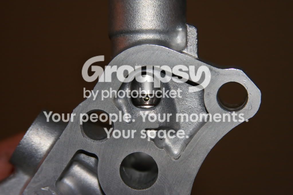

Ported OFH and Windage Tray
Posted 05-10-2011 at 04:57 PM by VETDRMS ('97 TSi AWD Auto 2.4 Build Project)
I spent a while today trying to find all the front case bolts. Made a little progress and ported the OFH.
I plan to run 20w50. Rod bearing clearance is at .0028 and mains are at .0030.
I tried to find a 2g windage tray but couldn't locate one. However, I got an Evo tray and the bolts...
Views 732 Comments 0 VETDRMS is offline
