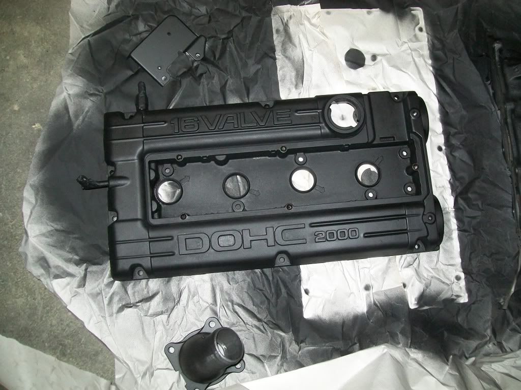

I washed the intake manifold and valve cover, but I was still unsure of how to get some paint to stick on it. Flat black always looks so good, but I didn't want to leave them black, so I used it as sort of a primer.
I wanted to continue the panda look in the engine bay too, so I decided to do gloss white and flat black. After taping off the parts I wanted to keep black:
And then the white paint begins:
The throttle body elbow came out pretty good
But I need to do some touching up on the valve cover and intake manifold.

    Here's a little trick for doing the letters. Since the letters (high spots) are going to be in white, paint the entire piece in white. Since the low spots are going to be black, paint the entire piece again in black.
    Then use a sanding block with 800-1000 grit paper and sand the black off the high spots. Once you get most of the black off, switch to 2000 grit paper for a nice shine.
    The lines on the intake are a little more difficult. Before sanding those, put masking tape where you want the white to stop, then sand away. The tape gives you a nice straight line.

    I've also used vaseline to control what gets painted and what doesnt. spread it on thin before you paint, do your painting, and when its dry, just wipe up the areas where you had vaseline, the paint should come right off.

    You did everything backwards, it would be much easier to first paint everything white. Then cover everything with tape and take an exacto knife and neatly cut out all of the letter and lines. Lastly spray the black paint.

    Best way I have found to paint these sorts of things is by hand painting it.

    Dang guys I said I'd touch it up. Thanks for the concern that I would leave it looking awful like that but no way. Here it is after some hand painting, which came out nicely. Good call 99eclipse420.
