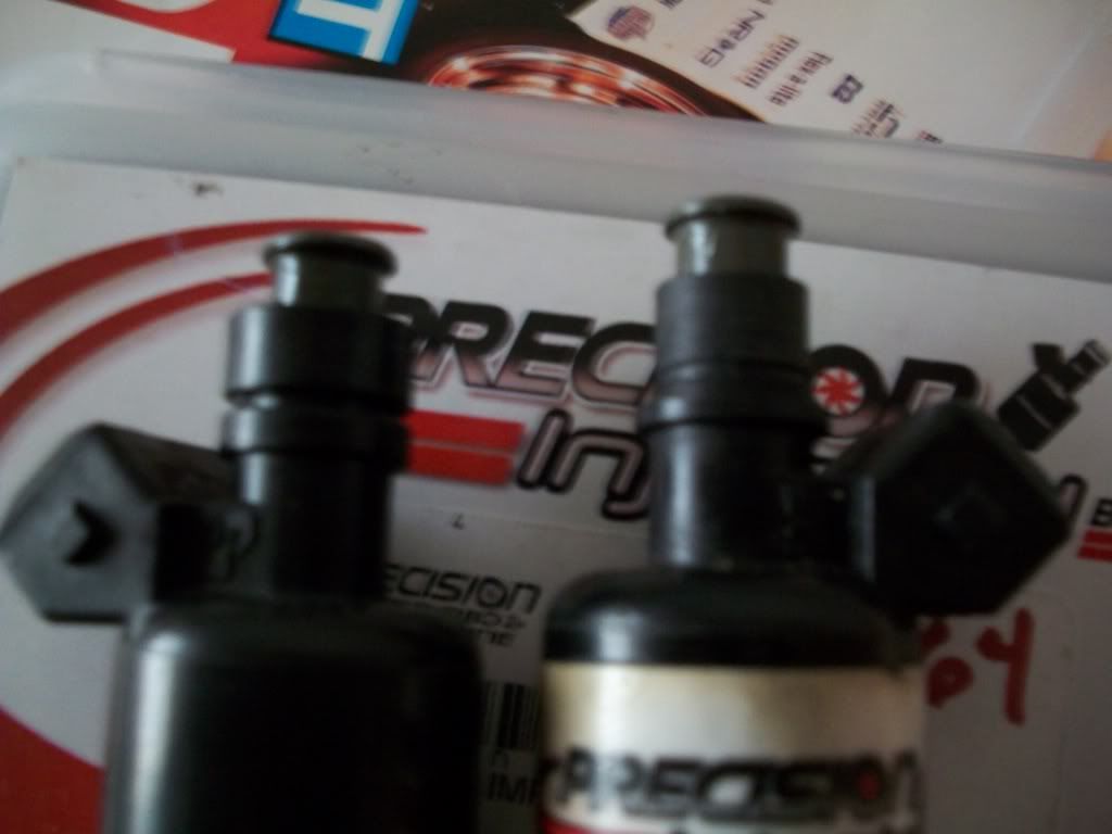

So i spent alot of money tryin to fix that up. And now im ready to tune. So i go to put the injectors in and do a base tune. They dont fit, fml. Come to find out i was sold domestic style injectors that are to big to fit into our fuel rails. Nice 150 wasted there, sucks being a noob. Anyway i ended up getting some 1000cc from a local and now im waiting for tune money again. Also the car now has some weird vibration to it when im going straight or turning left but when i turn right it feels super smooth. Will have to prob get that fixed first. Underneath are some pics of the injectors next to each other so other noobies dont end up doing the same thing as i did. Also underneath the pics i will leave a bit of my records to show how quickly things can go out of budget so that they might plan better then i did. Until next time guys
