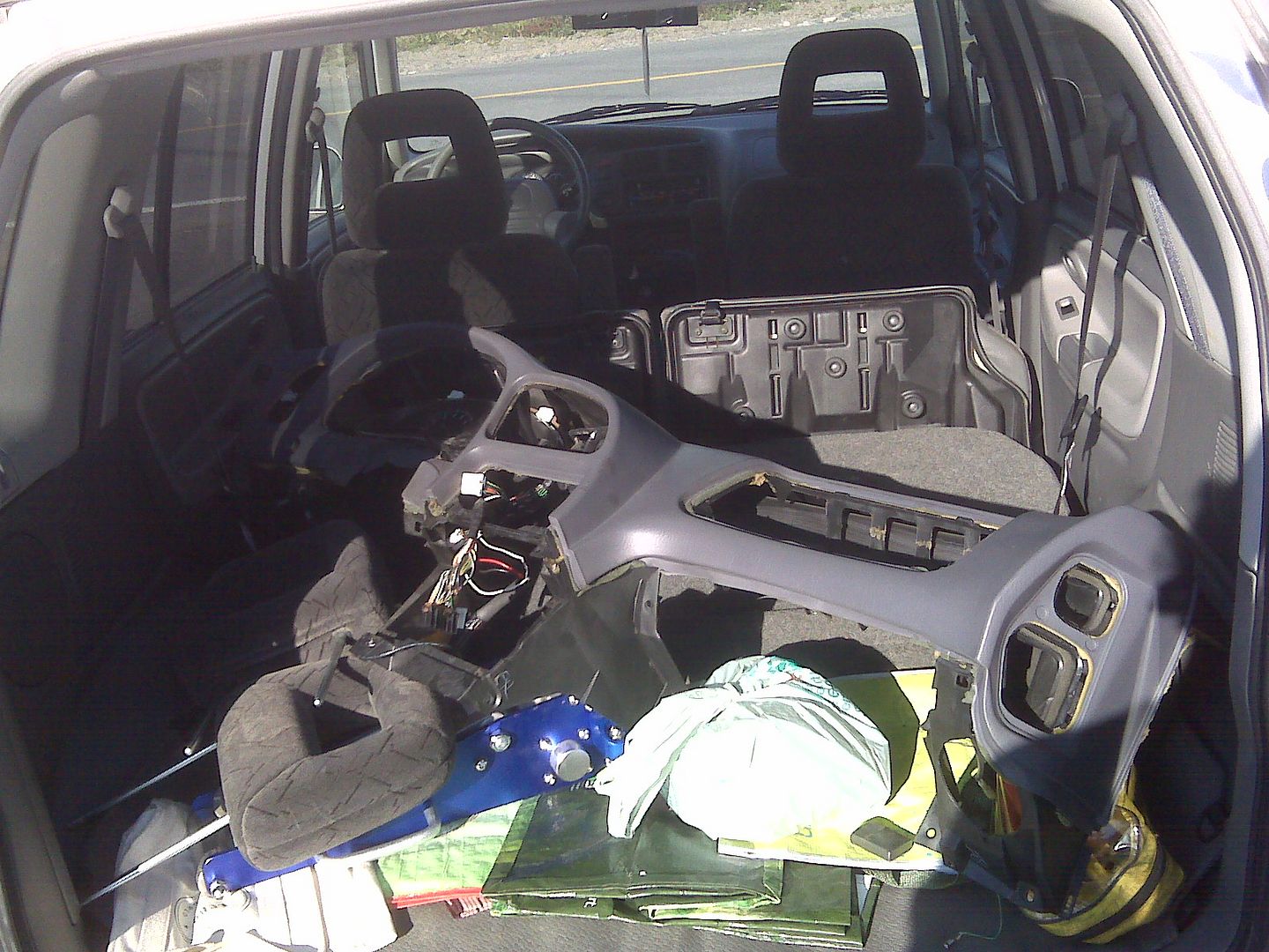

This weekend, I brought the dash home with me.
I'll update this entry as I do more. I'm looking at using RIT dye to dye my carpet black, then the only thing I'll need is my seats.
Head liner will be done in black suede.
I'm also powder coating all the dash brackets and will be replace the factory hardware with stainless steel hardware.
