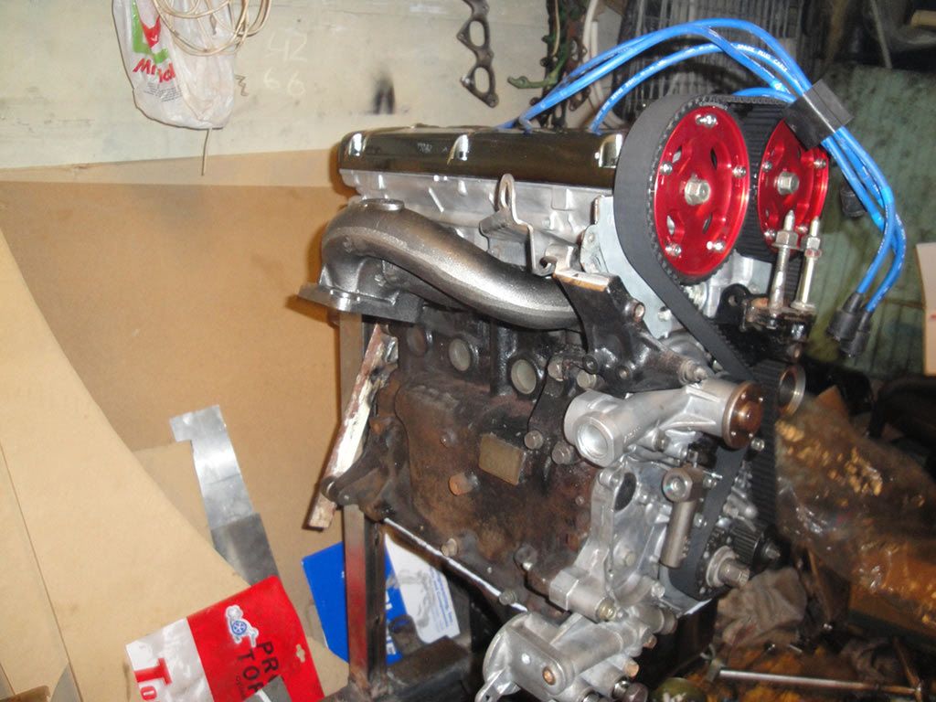

Almost complete engine
Posted 11-10-2010 at 02:13 AM by AlphaVision (DSM Cocktail project)
Updated 01-17-2011 at 02:10 AM by AlphaVision
So, the engine is almost complete. The thing that need to be put are the VC and timing belt. I have an OEM timing belt. The VC is on the pics just to se how it will look complete. Than I will have to rotate the whole thing to see if valves are touching the pistons.

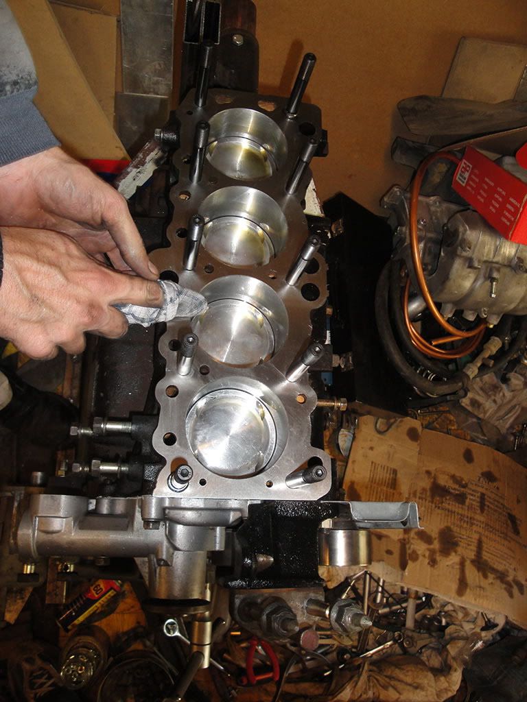

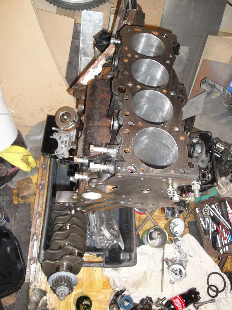

Short block assembly
Posted 11-04-2010 at 04:42 AM by AlphaVision (DSM Cocktail project)
Everything torqued to specs. Rod bolts were torqued to 40 lbs, even though the manley instructions didn't have such a low value for the ARP 2000/rods combo. Well I'll trust ARP and forums more than Manley.
The only glitch that I came across is why ARP main bolts didn't have enough room for the oil pump suction tube (or whatever that is called in english).
