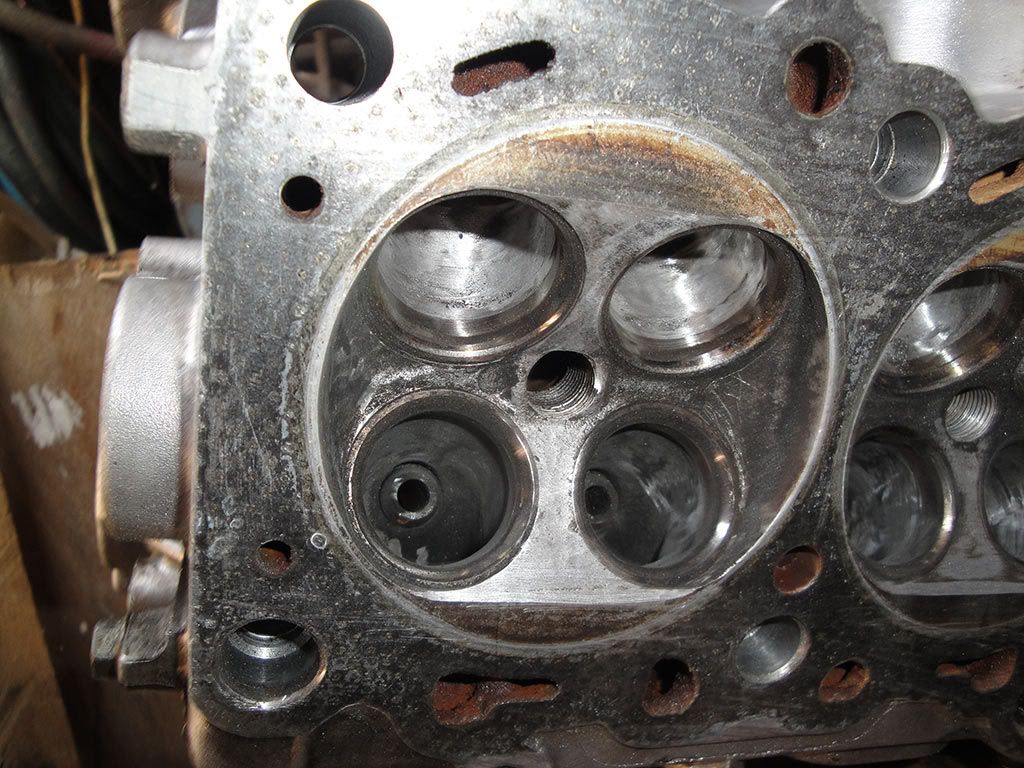

Head job finished. 30 degree angles on valves and head for improved flow.

- Some head optimizations. Just leveled the bumps and edges inside the head port and cleaned valve seats. The ports will be polished.
