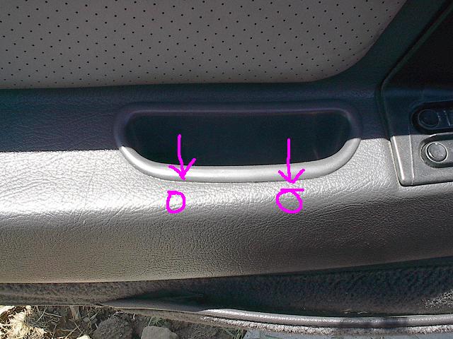

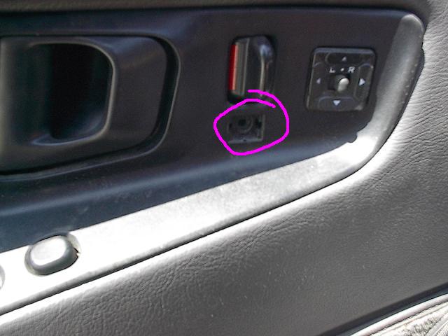

Open up your doors and pop out this little guy. Take out the screw and pop the panel off.
If you are working on the passenger side, the handle for the door also has a pop out you need to get out to get to another screw.

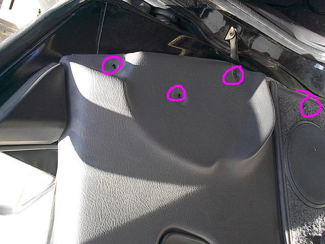

Next remove these 2 screws.

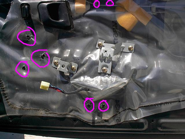

Then remove the last 4 screws here.
Now the panel should be ready to come off, do not yank the crap out of it, you'll be really sorry you destroyed your paneling. If it does not come loose really easily double check for any extra screws, in my doors the bottom screws at the front of the door was embedded into the carpet and you could not see the heads.
The paneling should pull off on the bottom, then lift up and out at the top.
Then you'll be happy to see this wonderfull mess.

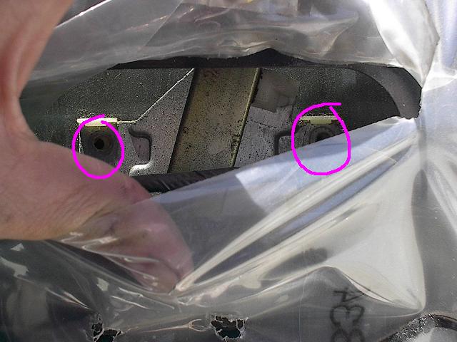

Begin to check the window at bottom most opening, that is pre-cut for you. And your going to want to line up the window so you can easily use your socket wrench on it.

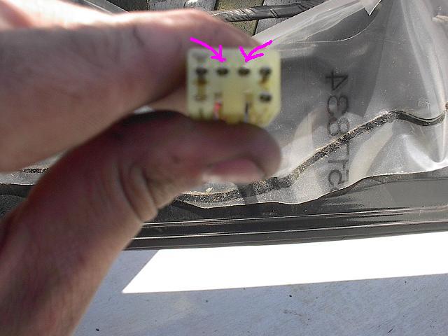

If your window is not lined up, you can use a pair of aligator clips and paper clips hooked up to your battery with the plug.
This is the passenger side plug, but you honestly cannot go wrong, just start with 1 spot being grounded and tap the other plugs till you get the window to move. These 2 spots work the passenger window, switching the ground and power makes it go up or down.
Once you get the window aligned, take out the bolts and pull the window out. It'll take you awhile to figure out how the window comes out, I had the best luck angling the window with the rear out first.
