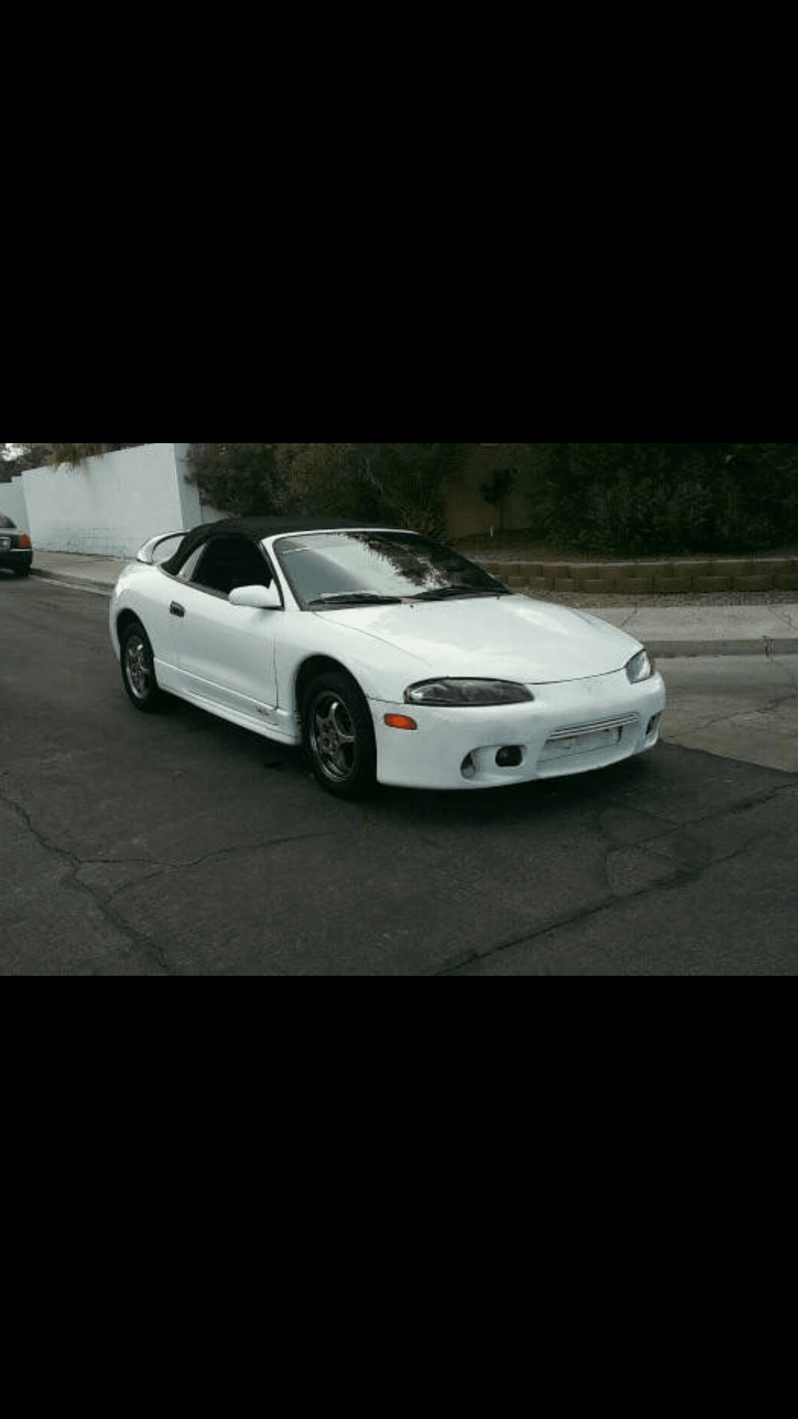

- Background
- Bought used for a grand not running but loved the car because it was stock looking minus the projector headlights.
First I have compression it's fairly even in all cylinders, I have fuel, but no spark and a crank position sensor error code that comes on after attempting to start the car. It doesn't come on immediately either it will take up to 5-6 attempts of trying to start car before the code comes up. I have no spark but all my ignition components test just fine. Here is the thing though, my cam gears timing are off from each other almost 180 degrees!
Could this be my issue of no spark because crank and cams are out of phase with each other?
The are some under the hood mods like intake and An actual HKS bov not an eBay look alike. I would like to see 300 to 400 whp but I'm in no rush, like I was in my old VW Jetta. The Jetta was flawless but damn everything was expensive for it!
