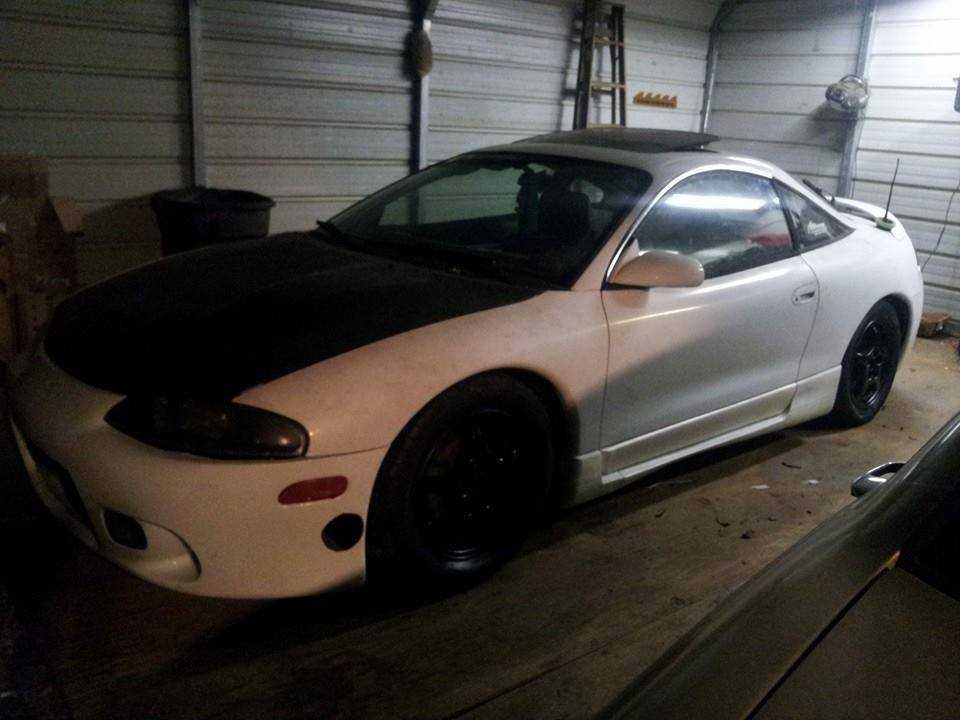

- Background
- Bought this car as a shell In 2012 put the carpet and seats into it and now its time to get her rebuilt and start putting her back together with my previous 97 GST's motor! Hood from my 98 GS eclipse. Wheels off my friends 99 Eclipse GS. Door caps off my other friends 96 Spyder and bumpers off unknown 2g.
