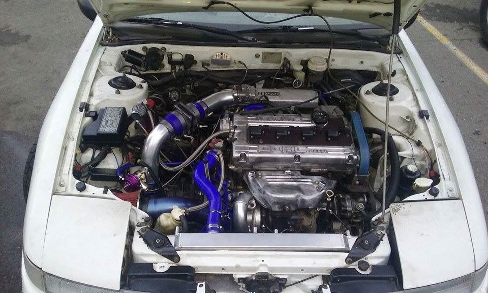

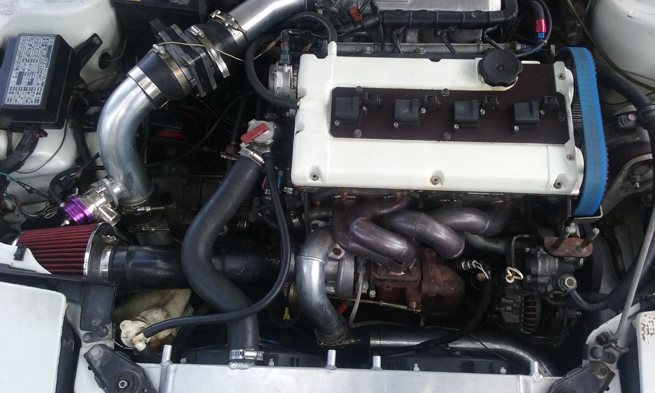

- Mods-Bolt-on
- full 3in turbo back, ported 2g manifold, big front mount intercooler, 2.5in piping ,ebay bov, cop conversion, nsx boost controller, ebay radiator, blue silicone hose kit. shaved valve cover. (not a bolt on) teenage mutant ninja turtles head liner.
- Mods-Engine
- HKS 272 cams, stage 3 head, arp head studs evo8 560cc injectors MHI real 16g turbo@ 20psi with port and polish, eagle rods and je pistons. wally 255lph fuel pump, aem afpr, gates racing blue timing belt, ACT streetlite flywheel.
- Mods-EMS & Logging
- custom flashed uprom ecu, gm mass with translator. AEM wideband with glowshift gauges , 30psi boost gauge, water temp, volts, exhaust temp.
- Mods-Drivetrain
- Shep stage 2, 4 bolt rear end ACT 2600 with street disk,Ingalls Smart Arm Camber Kit, b@m short throw shifter, skate board bearings for shift linkage.
- Mods-Handling
- Tein springs 1.5in drop with adjustable kyb's 17.8 white drags. 2g duel piston calipers with slotted rotors .
- Parts Wishlist
- carbon fiber hood, new paint job, aem adjustable true time cam gears, solid shifter bushings, clear timing belt cover. ecmlink v3. just want to keep it reliable but I may go back to a 20g and upgrade to fic 1000cc injectors.
