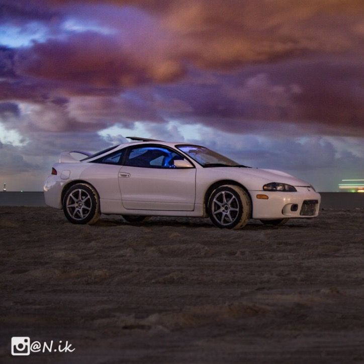

Street Build Damned DSM
20g
FP Manifold
20g turbo (internally gated)
3” straight pipe exhaust
Big FMIC
Blue Tial 50mm Q BOV
1000cc injectors
255lph fuel pump
Fuel Lab afpr
300M cool on plug system
Gamble Garage 8-an catch can
Mishimoto (1 slim & 1 race) rad fans
MDR Performance built engine
Forged internals
9:1 CR
Evo IX crank
ARP Main & Head Studs
King main & rod bearings
Top line revised lifters
Evo IX OFH
Greddy Carbon Kevlar timing belt
Balance shaft delete
Cometic 3-piece metal head gasket
ECMLink 3.0
Speed density mod (omnipower 4 bar map)
Innovate PSB-1 boost/wideband gauge
Innovate MTX-D oil temp/pressure gauge
ACT 2600 extreme clutch/pressure plate
KYB excel-g shocks
ATI SuperDamper
JMF street intake mani
FIC fuel rail & ethanol sensor for E85
DynaTek Arc II CDi
Eaton Motor Works PS rack depower service
Jacks trans ultimate ratio Transmission
TMZ 300M Stage 4 T-Case
Driveshaft Shop Carbon Fiber HD driveshaft
Driveshaft Shop Front & Rear axles
ETS short route intercooler/custom piping
When I bought the car it seemed to have only small problems, but in the end the previous owner sold it cause it had lost a thrust washer. Crankwalk came for that motor at about 3 months into my ownership of it. I bought a cheap rebuilt ‘95 7-bolt motor (bad decision) and it failed 300 miles into its break in from a rod clearance set wrongly. After losing a second motor so soon I decided to go about it the right way, I started by sourcing a ‘98 split-thrust 7-bolt motor and having it built by an amazing shop (MDR Performance and G&G Performance machine shop) I’m now in the process of breaking it in I’m hoping to make 450awhp
