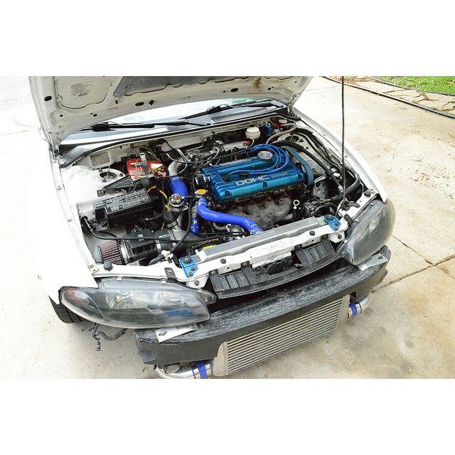

- Mods-Bolt-on

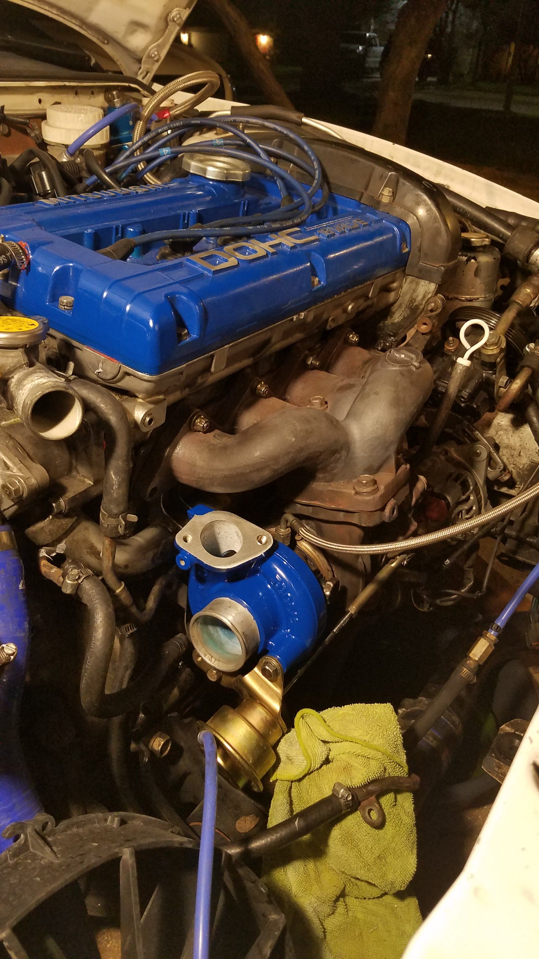

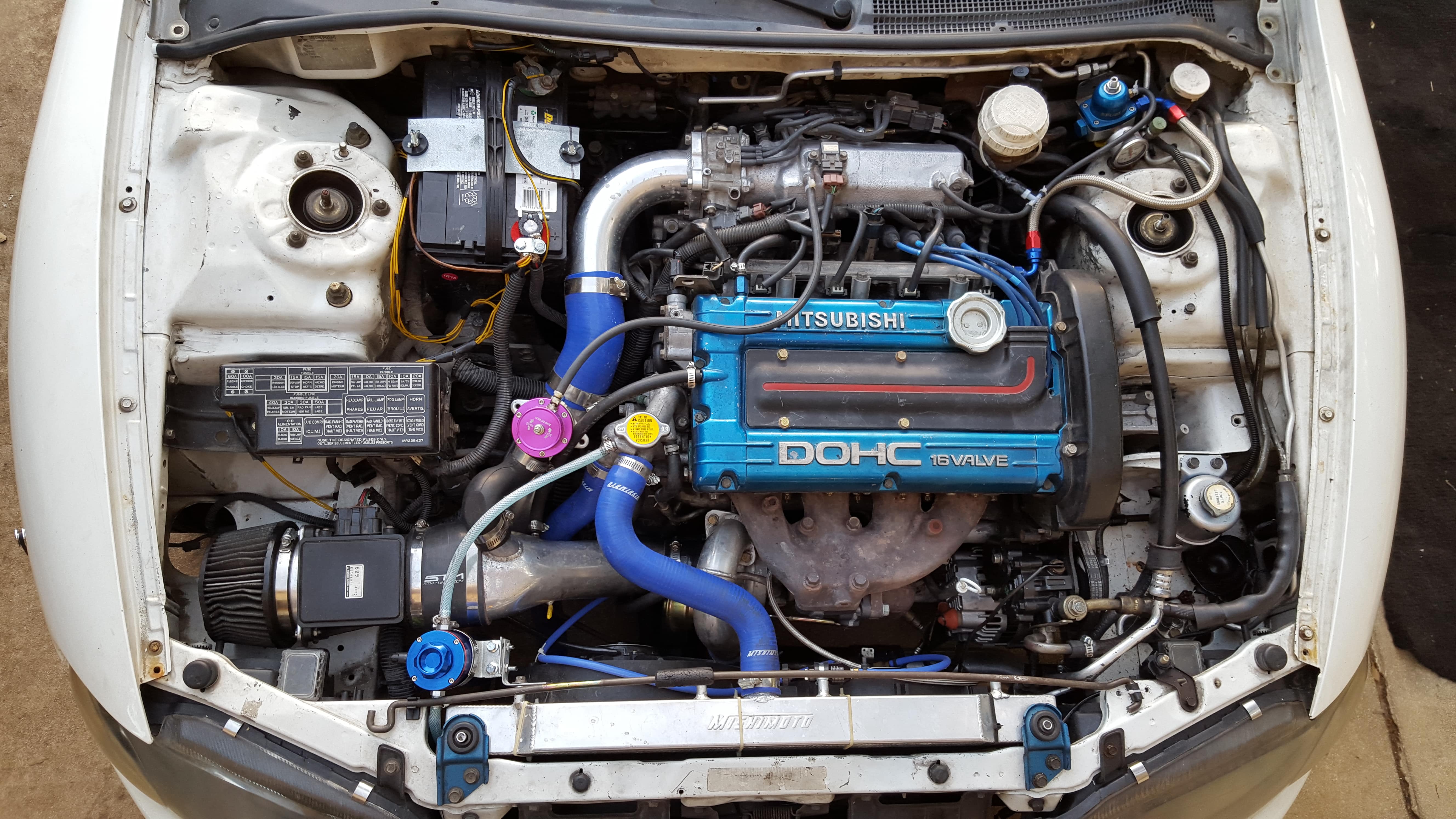

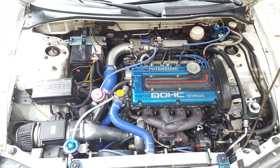

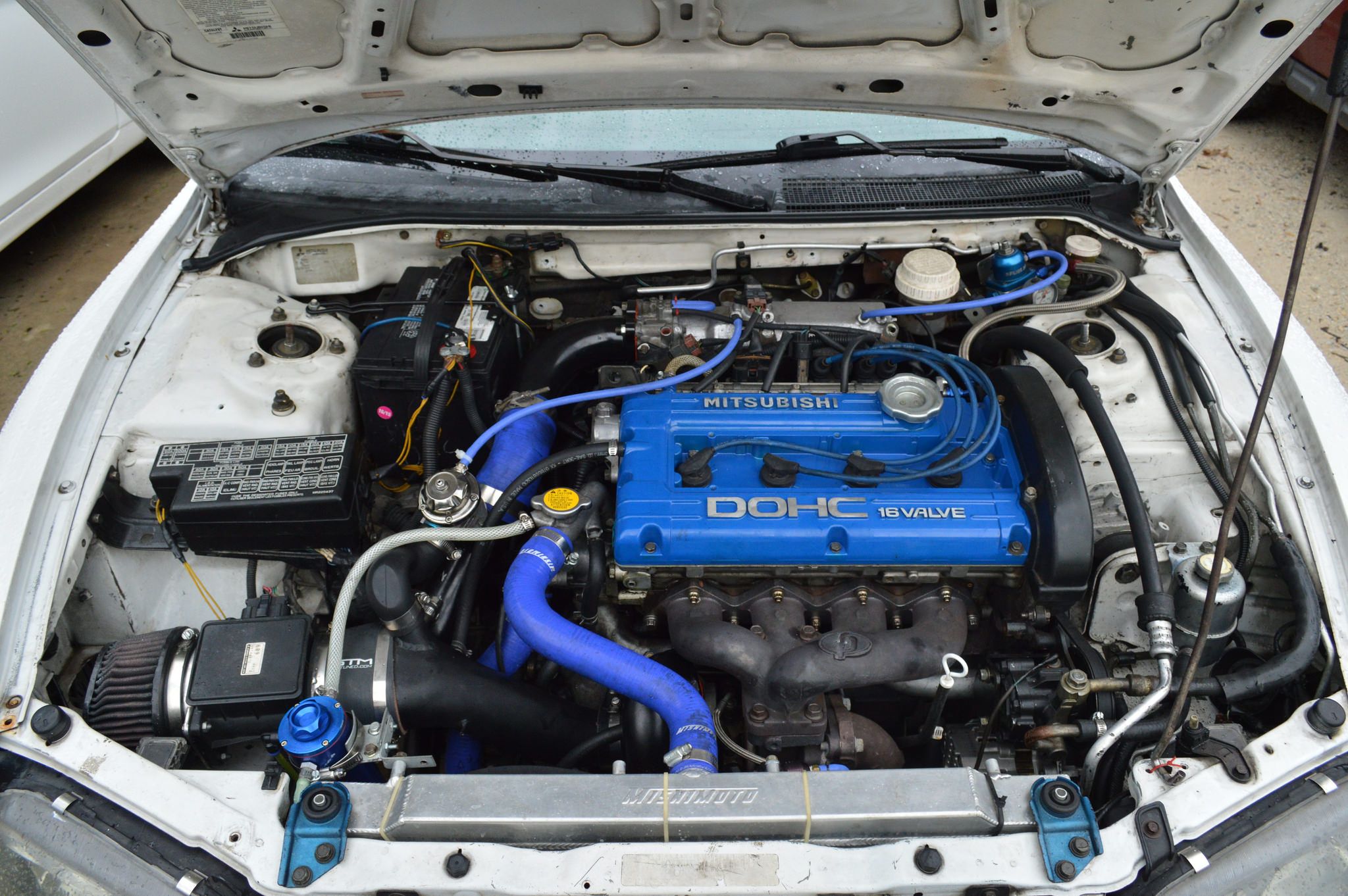

- FP Race Manifold
ARP exhaust manifold bolts/studs
Holset HX35 Turbo w/ BEP turbine housing
Punishment Racing FMIC
Greddy RS BOV
EVO III intake manifold
Non turbo 1g 60mm TB
APEXi GT downpipe
APEXi N1 cat-back
non-cruise throttle cable
Emissions removed
Fuel:
fuelab AFPR w/ gauge
wally 450 pump rewired
FIC 1250cc injectors
STM E85 rated -6an Teflon fuel line (tank to rail)
Weldon fuel filter
Stock feed line converted to return line
Cooling:
Mishimoto Race Radiator
Mishimoto High flow radiator fan
Mishimoto slim line AC fan
Radiator fan rewired to toggle switch
- Mods-Engine
- Kotzur Racing built shortblock
91 TSi 6 Bolt block
CP Carillo 9.0:1 Pistons
Eagle H-Beams
Stock crank
Kings XP Bearings
ARP Mainstuds
line honed and balanced.
ACT Lightweight flywheel
SS oil pan bolts
OEM stubby shaft B/S delete
BogusSVO oil passageway porting
Kotzur Racing built cylinder head
97 GST Head
Stock valves
bronze guides
GSC valve stem seals
EVO 8 Springs
EVO 8 Retainers
GSC zero-tick lifters
BC 272/272 camshafts
BogusSVO head oil port mod
Held together with a Fel-Pro composite HG and ARP headstuds
